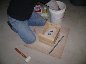

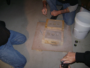

    At our monthly meeting last night we did our first greensand casting. I don't think they turned out to bad for being the first ones we ever did. We have to fine tune the molds, by finding the perfect mix for the sand and clay. In all, casting frick'n rules. The day before I did a little test casting to make sure everything would work, but it is not nearly as cool as at night because it dosen't glow in the daylight. We made two small shift knobs to start with. More is only to come!

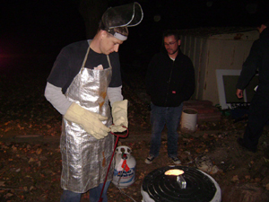

    I will post some pics of the whole set up when I get back from vacation. The cheapest and most portable furnace or kiln basically is just a metal trash can lined with a refractory ceramic fiber called "Cer-wool" made by Vesuvius. Check ceramic suppliers they should carry something similar if not the same brand. I had some left over from years ago when I made a kiln similar to this one for firing low temperature pots. I had just enough left to make this one. If you keep it dry it will last for good length of time. Some idiot with a severe lazy eye took the pictures!!!!!

    Here are some pics of the kiln or furnace. Just a large metal trash can lined with ceramic fiber. I drilled multiple pairs of 1/8th inch holes around the can and lid and used iron wire poked through and twisted to hold it. I cut a hole in the lid to help control the draft and keep in heat. You can decide to not use the lid but you will use quite a bit more fuel and it will take longer to reach melting temperatures. I got a weber grill lower grate and welded on some 1 inch angle for extra support and to space the crucilble up from the bottom so the burner will fit. I drilled holes in the bottom of the can so the grate support legs would set on the ground and not the thin can bottom. The weight of the crucible along with the heat used would surpass the strentgh of the can floor. The grate itself already has a little sag to it. The crucible is schedule 80 pipe so it is virtually indestructable when doing aluminum.

    The burner I have was used on a natural gas ceramic salt kiln. I got it from my old ceramic connections, they changed the kiln and only reused four of the six burners. I think the orfice hole is to big because it was made for natural gas pressure not propane. On the back of the burner is a plate that screws in and out, but it does not make huge difference when adjusted accept when closed completely. I used a high pressure propane regulator but it does not come out with force or bright blue flame color of say a weed burner, it is a small blue flame and a longer lazy red flame. As is it takes about 15 minutes until pour temperature. The bigger burner also made it a fun trip to the store for fittings as you can see. There are plans for making a burner on www.backyardmetalcasting.com or you can use a weed burner tip made for propane, I know harbor freight tools carries them. Mine was free so thats what I used, and 15 minutes is not that long it takes alot longer packing the cope and drag.
