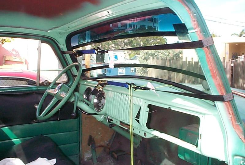

    If you can't find the two chicks to help, you might get by using ratchet straps as I did when replacing the windshield in my '55 Chevy pickup truck.
    chryslerfan55, HFKDI and Woogeroo like this.
