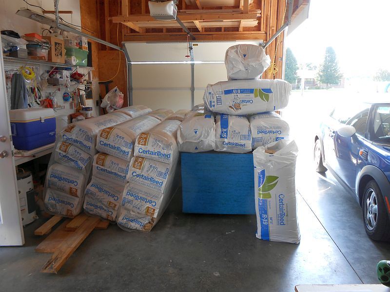

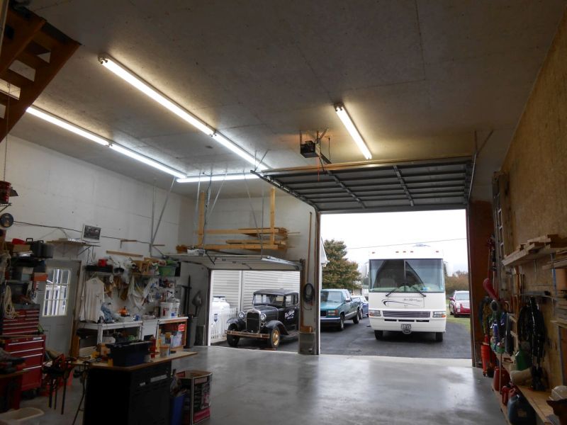

    Big load of insulation and OSB where the Model A is supposed to go. (Yes, that’s my wife’s Mini Cooper next to it).
    Six weeks later, it is all insulated, paneled, and mostly all painted.

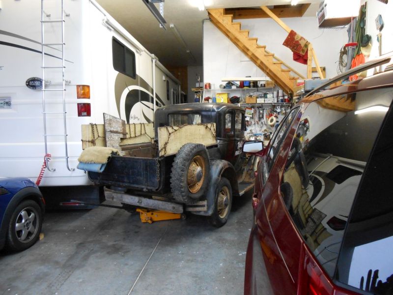

    Managed to get the Model A in with both cars and the MH. A bit tight, but everything out of the elements.

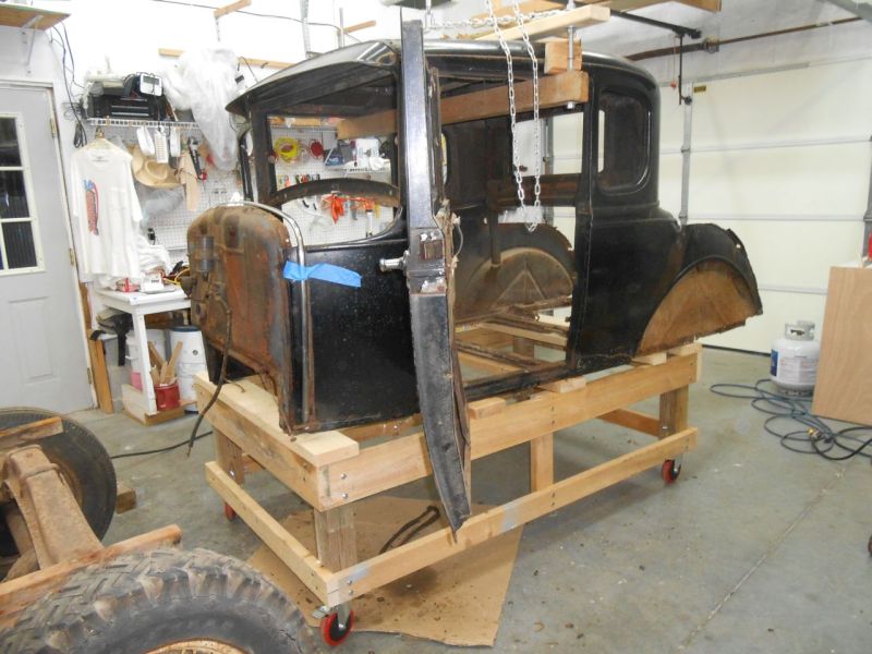

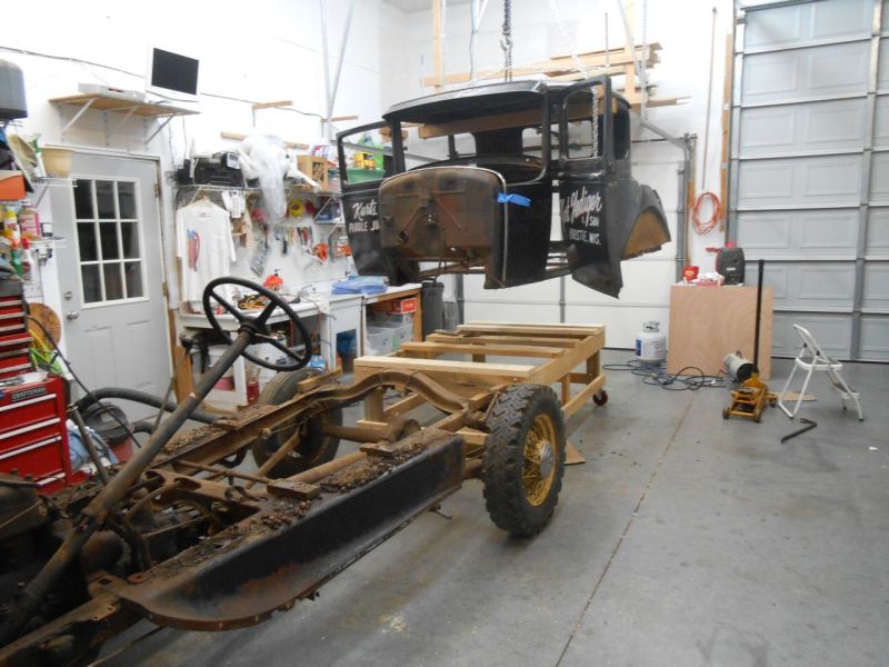

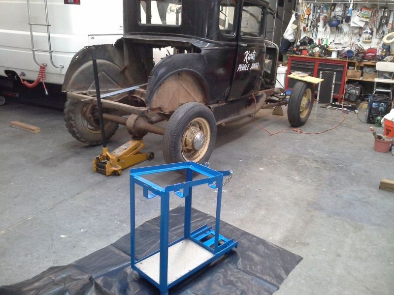

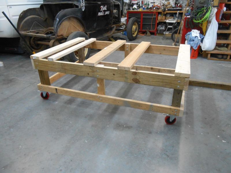

    Next step was to pull the body off the frame. For this I needed a body cart to place it on.
    I had most of the lumber hanging around the garage. I think I bought 1 2x6 for some of the top boards. Now for a shock, the price of nuts and bolts. It cost almost $100 for the carriage bolts, nuts, washers, and casters.
    031 111414 body cart built DSCN1003.JPG 037 111514 body being lifted over cart DSCN1009.JPG 040 111514 body resting on cart DSCN1012.JPG
    Body lifted off the frame and lowered on the body cart.

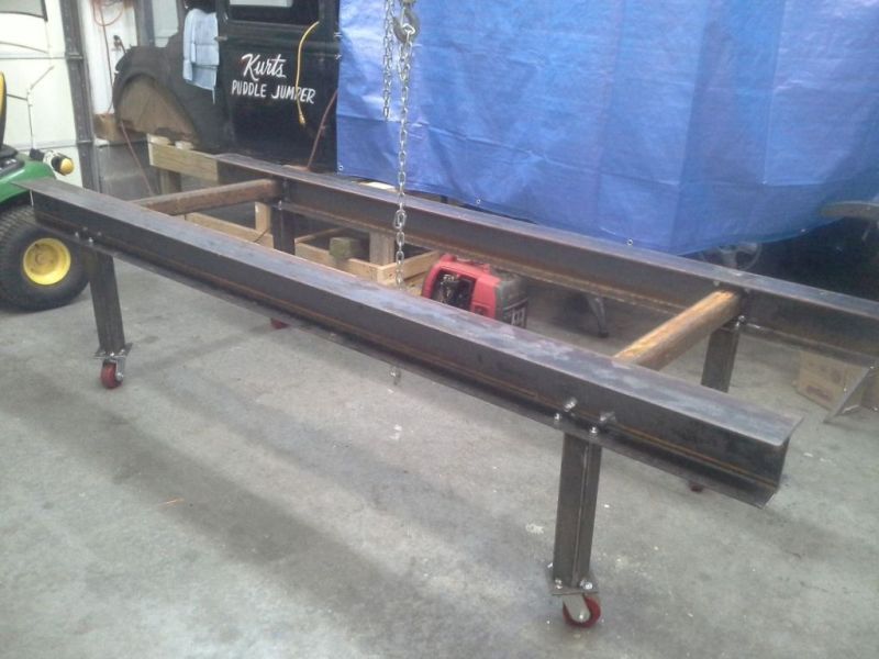

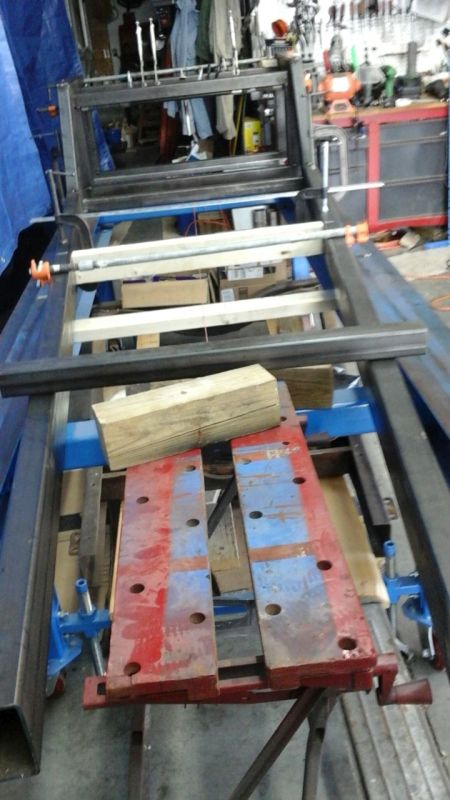

    Got some steel and built a frame table. A bit excessive for only one build, but I want it straight.

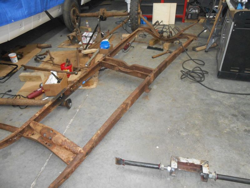

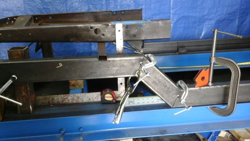

    Got steel (2 x 4 x .125) for new frame rails and started fitting for rear Z.

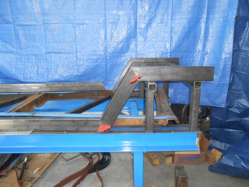

    Fitting new frame rails on frame table with some jigs. Note the frame table got painted as well.

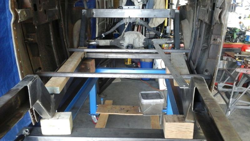

    Finally back to work in Feb 2016. Rear Z fitted and tack welded in place.
    First pinch of the frame rails.
    Fitting front Z.
    Front Z all fitted and tack welded in place.

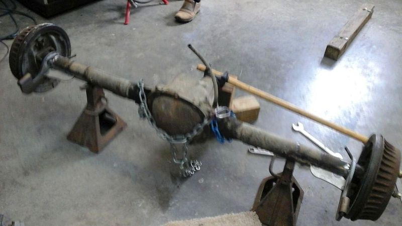

    Picked up a S10 4x4 rear axel assembly from 96 Blazer.

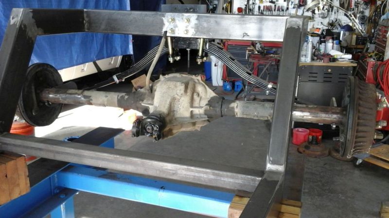

    New spring hangers tack welded on S10 rear end. O, something is wrong here. I got them upside-down.
    OK, that’s better right side up.

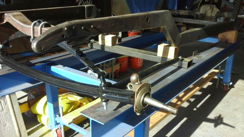

    Front end assembled temporarily. Need new spindles, hubs, and maybe a dropped axel. With a 7 inch front Z, I need to see how low it sits when I get an engine installed.
    Rear spring and rear end installed.

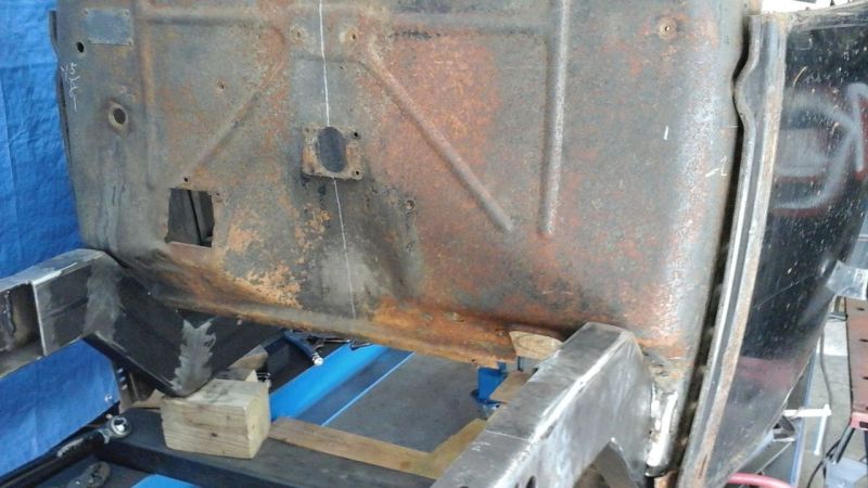

    Sub rails cutout for channel.
    Body sitting on frame for the first time in a year and a half.
    150 052316 body sitting on frame for first time in a year and a half.jpg 151 052316 body sitting on frame front view.jpg

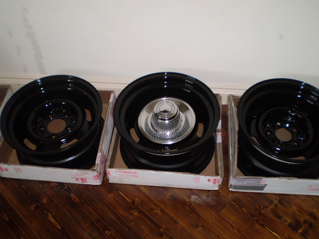

    Broke down and bought myself a birthday gift (July 30th). Smoothie wheels and baby moons. 5 x 15 for the front and 6 x 15 for the rear. Now if the humidity would ever drop I can get some paint on them and mount my junk tires to make a roller. The dew point has been over 70 now for over a month.
    Had to at least mount one bare wheel to check the look.

    Well the weather cooperated for the 2nd straight day and I got the outside of my wheels painted. I’m going to let them cure for about a week before trying to mount tires.
    163 082316 Outside of wheels painted.JPG 164 082316 Outside of wheel painted.JPG
    Weather has now gone back to 90's and over 70 degree dew points, so no telling how soon I will get more work done. My old body just does not like high humidity.

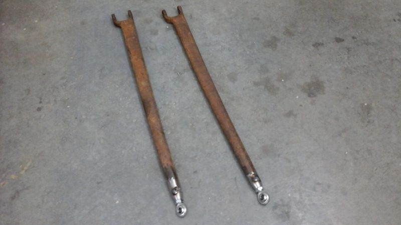

    Right now, I'm trying to figure out ladder bars for the rear. It appears 7/8 OD DOM .156 wall tube using 5/8 clevis's (sp?) is a popular way to go. However, this tube has an ID of .562 which is about 1/64 smaller than the recommenced drill size for a 5/8-18 tap (.578). How do you drill a 4 foot tube? I have a floor standing drill press, but no lathe.
    Or do you ignore the extra 1/64?
