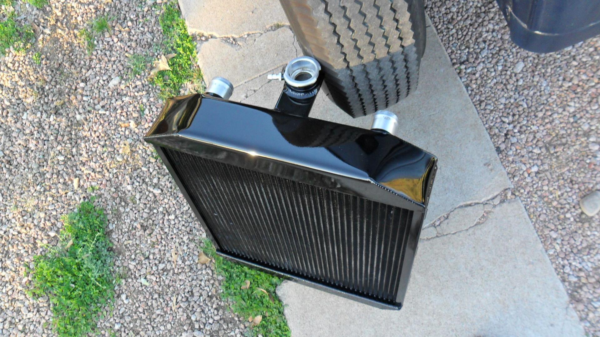

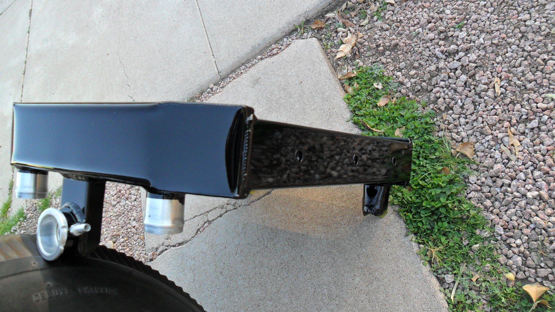

  22. need louvers ?
    Joined: Nov 20, 2008
    Posts: 12,906
    need louvers ?
    This is shot with Rust-O-leum appliance epoxy right out of the can on a 85 degree March day after warming the can a bit...

  24. Limey Kid
    Joined: Mar 5, 2006
    Posts: 1,023
    Limey Kid
    When you say "right out of the can", do you mean rattle can? If so, that's an incredible paint finish.
