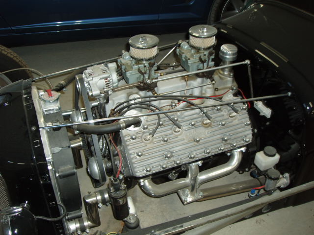

    AN 10 upper hoses. 17" electric fan. Closed up radiator outside of the fan shroud. Pretty small aluminum radiator behind a cut down 33 2021-03-14 11.09.15-3.jpg 2021-03-14 11.09.15-5.jpg GOODSGUYS   PACKARD 016.JPG Pontiac grille shell. .040 bore. Runs cool. Did not acid dip block but I highly reccamend it.
