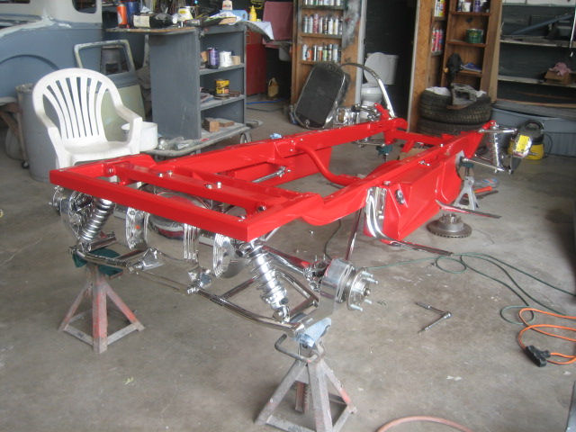

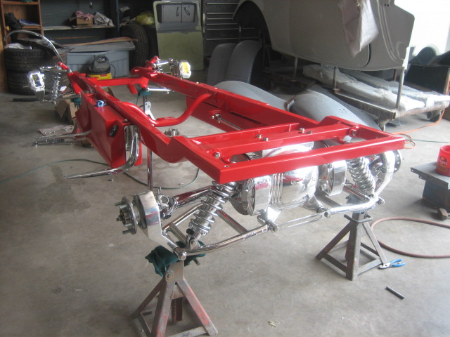

    My main complaint about A tanks is they give no choice for instruments so I use saddle tanks.
