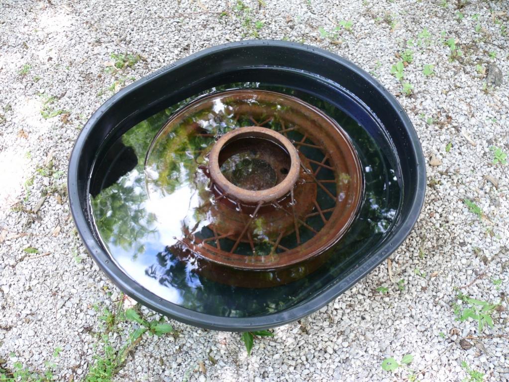

    With everyone raving about how well vinegar works, I thought I'd try a controlled study...(I have no life)

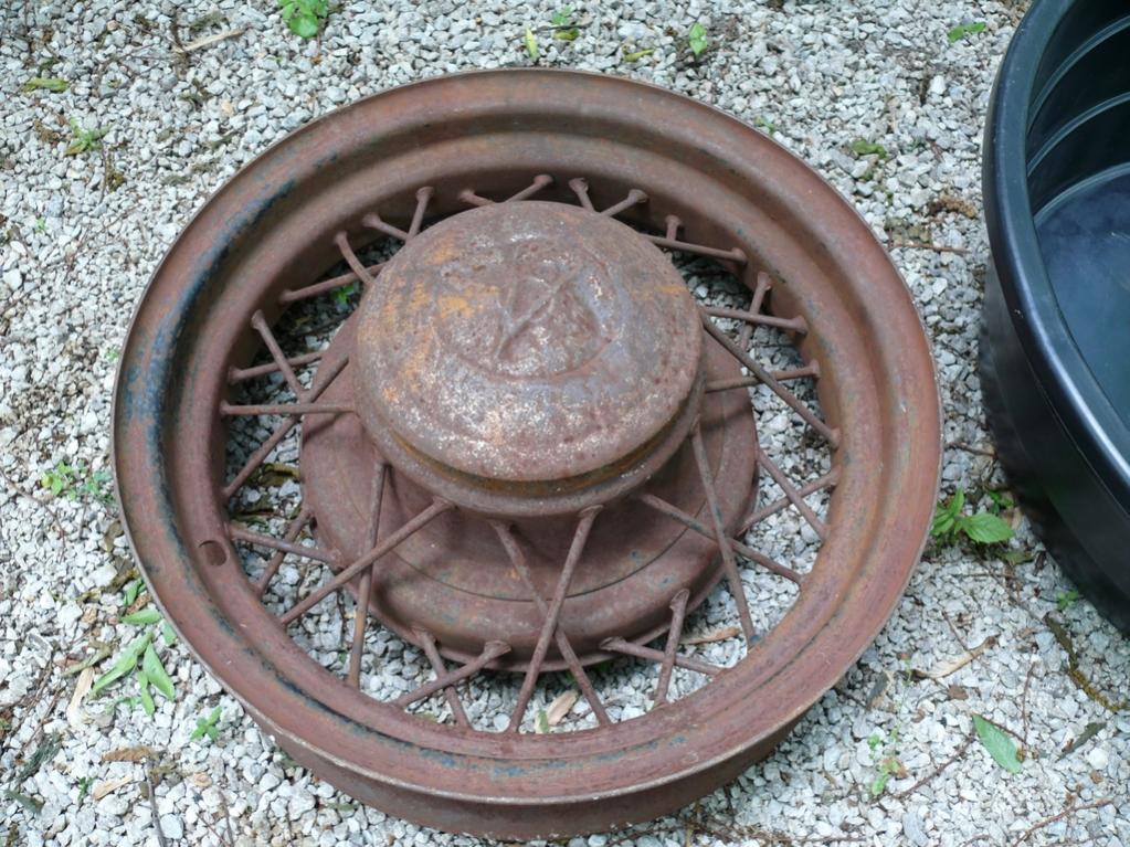

    I've got a damn-near-perfect '35 wire wheel that has a lot of surface rust, but no pitting, and a totally fugged hubcap
    Went to Atwoods and bought a 15 gallon plastic Stock Feeder...$21
    Went to the store and bought all the vinegar they had...9 gallons...$25 (everyone looked at me kinda funny)
    Took before pics to show actual condition of the wheel and hubcap
    Covered it up and used a traditional cover weight...1936 Ford rear spring
    I'll check it every 24 hours and give updates on its progress...(I need a life)
    Does anyone know how long this should take?
