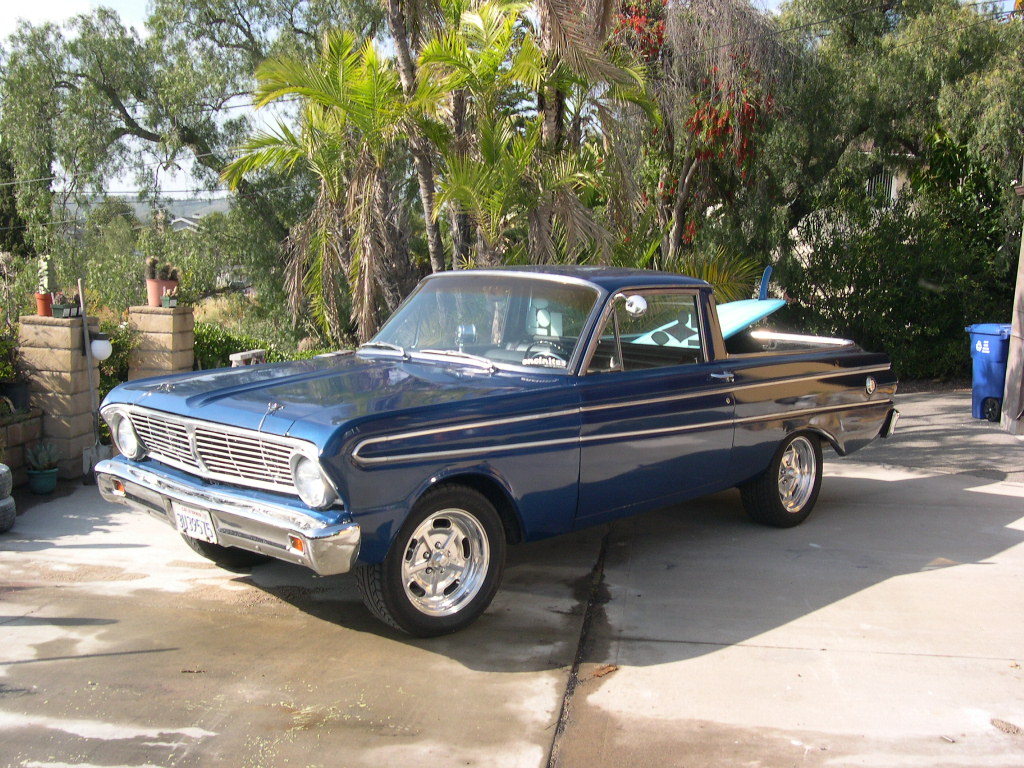

  1. Howdy to all out there in H.A.M.B. land! here's the low down, I have a falcon based Ranchero that I am planning on getting back on the road. The engine is not very traditional, and I would like to mix things up a little to give it an early to mid sixties vibe. Like a bug to a light I am drawn to weird induction setups, so in my mind the X-F8 is a much better looking set up than the Mass air that is on it now. I have done some research and have learned a couple of things about this intake, and I know these can be a bitch to deal with, but here is the question. Has anyone here ran one with any success, and if so what ignition was used, and carb selection ect? The ranchero's make over will lean towards a sixties flair, with touches such as diamond pleat in the interior. The engine will be dressed to look the part, but the internals are late model (5.0, GT 40 aluminum heads, B303 cam). That's it in a nut shell, goal is to make a nontraditional engine look traditional so it jives with the rest of the truck.

  6. -TREBLL this thing is pretty tall, I think a teardrop will come into play just out of necessity
