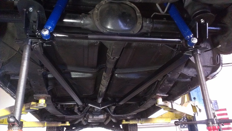

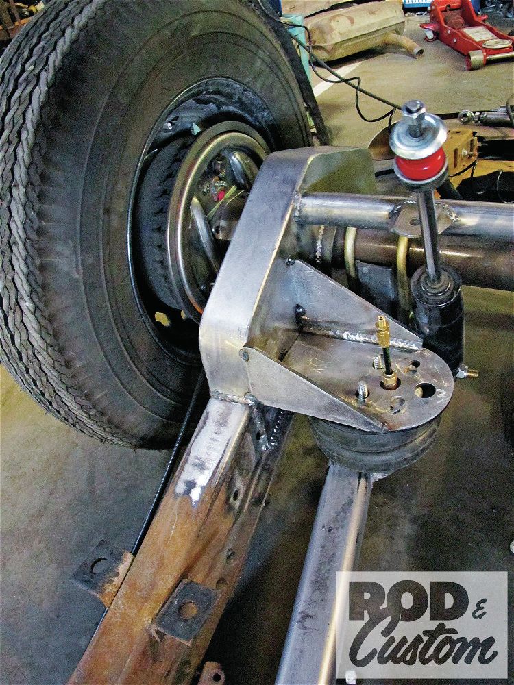

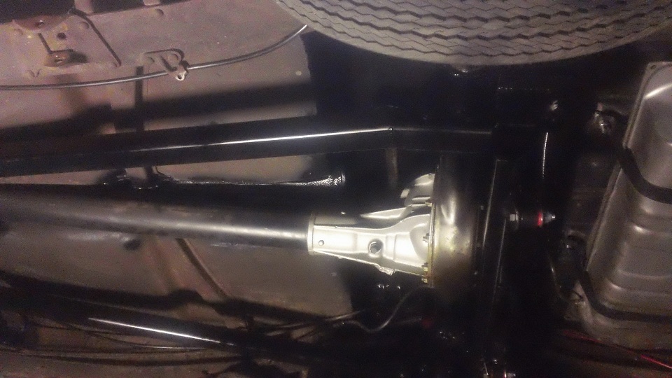

    Clean nice lookin installs.

    looks good , just ordered that setup last week for a 52 chevy

    did you guys change the design from mounting the bags in front of rearend to the back ?, the rod and custom mag install has the bags mounted in front.

    Looks simple and well thought out.

    Is there a differance in the ride quality with the bags in the front or rear of the axel or is it just space limatations.

    Mostly space limitations. Mounting them in front of the axle will give a hair more lift. Now if you're talking about mounting them on the link bars themselves, that will yeild more lift and a softer ride depending on where you position the bag on the bar.

    Hmm, square tube links. How well do those flex? Do you have an engineering diagram of the function?

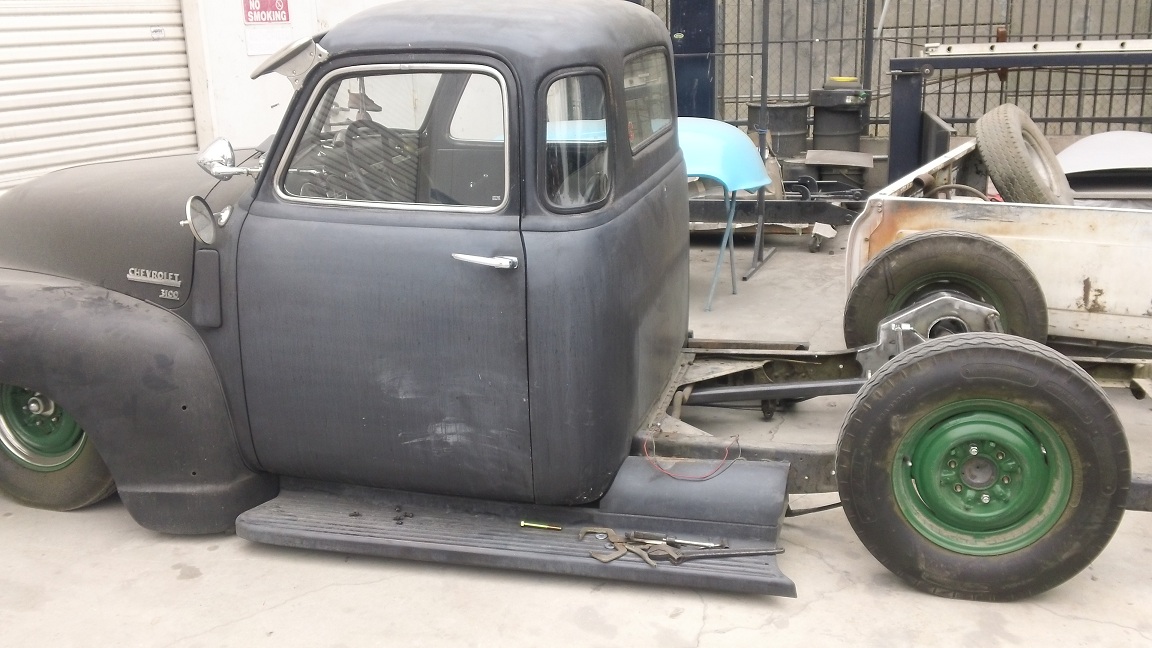

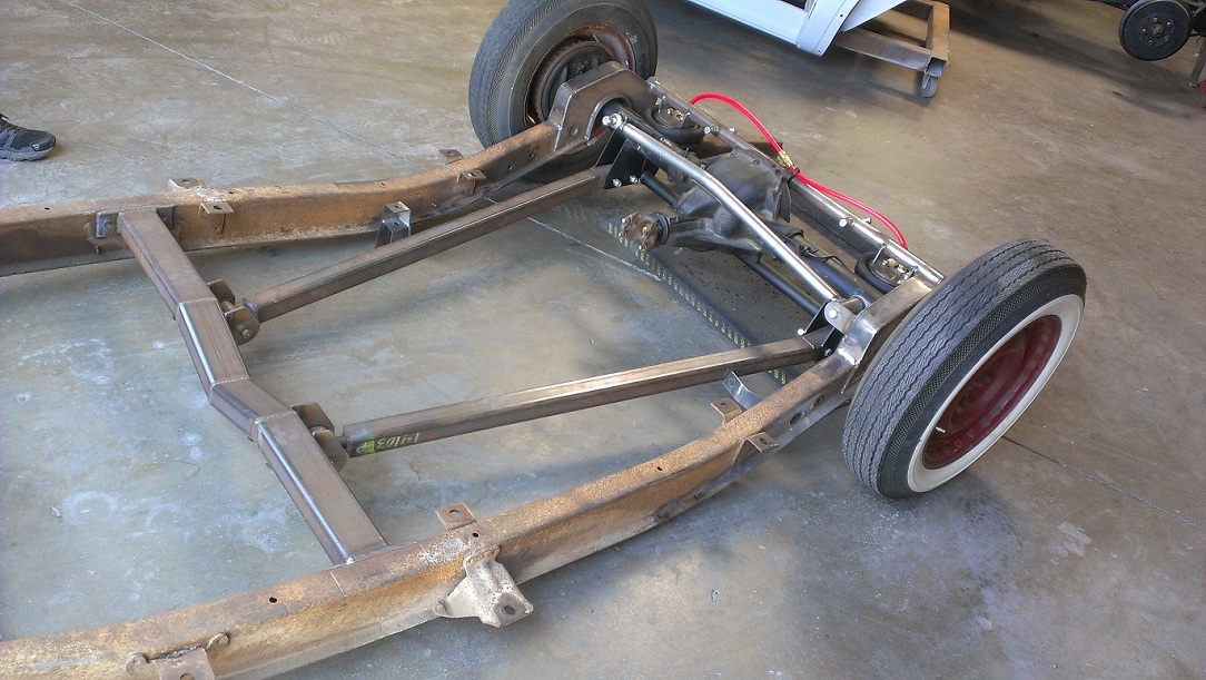

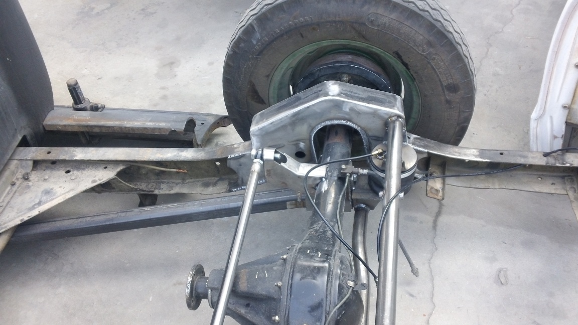

    Just finished a 2 link and mustang 2 front clip at Jimenez Bros Customs
    Moose Hutchison with truck
