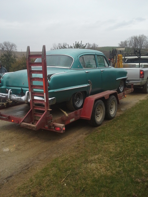

    Haven't been in here for a while. Just got this thursday. Planning on getting it road worthy as soon as possible. Not a bad little rig. We got the flathead running and ran it for about an half hour last night and dropped the oil. Patched the gas tank today. Needs about everything for the brakes. Not having much luck finding parts.

    I like it and think the color makes the car,I also think some aluminum slots with just a little dish and/or "medium fat" (for lack of better term:D)tires would complete it.
    Congrats and good luck;)

    The patch on the tank held. Put seven gallons in, no leaks. Its swap meet season here. Had a guy stop by and drop off a set of 14" port-o-walls. Spent the rest of the day dropping in a transfer case in the son-in-laws Nissan Titan, that was the payment for this car. He ended up with the car and told me buy him a case and put it in and the car was mine.
