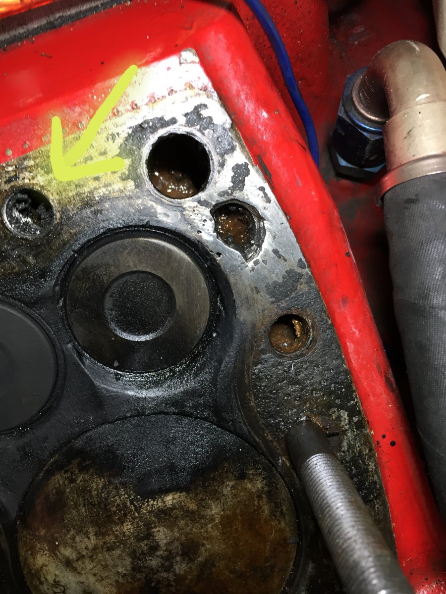

  1. Just finished reading this, a few comments .... with the relief work done and looks of the valve train I would like to know what cam is in this baby (your exist engine). If your new engine is all stock I wouldn't run the trips but look for a 2-2 and save the trips for something else. Looks like they may have nirodded the original repair and ya may still have a crack into the exhaust and explains the carbon build up.

    I don't know about the cam. As you probably saw someone showed me how to measure it. All I was told was it was a 3/4 race cam. What ever that means. lol. It does look like the crack still reaches the valve. As far as carbon build up the carbs were defiantly set up wrong. Two of them blocked off. I think my new motor is stock but I'm not sure. It did have trips on it before I got it so that's why I say I don't know what's up with it. It also had some rare heads on it but the guy who sold it to me kept those. That's why it has the stock heads. I'm going to rebuild the carbs and see if I can set them up to work progressively. If I can't for some reason I'll look into running two. I don't plan on doing to many hole shots with it so as long as it's dependable I'll be happy. I'm really only tearing into the old motor for fun and to learn also to have a spare.

    No that is silicone. That hole had a bolt instead of a stud and nut. It goes into the water jacket. Thats why there was silicone on it.
