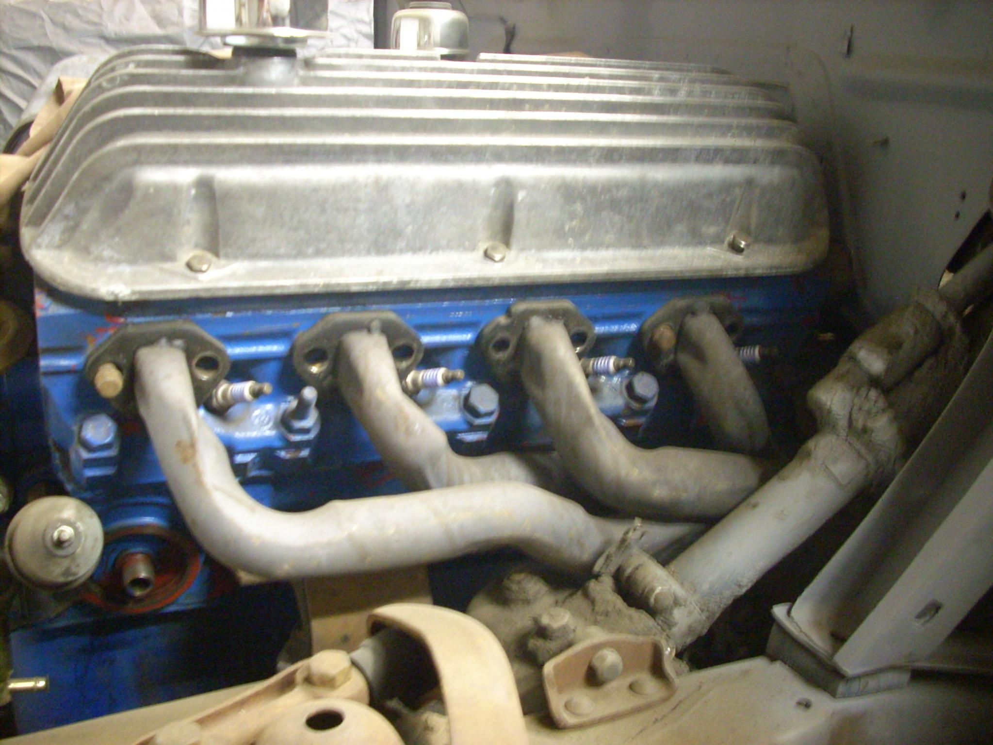

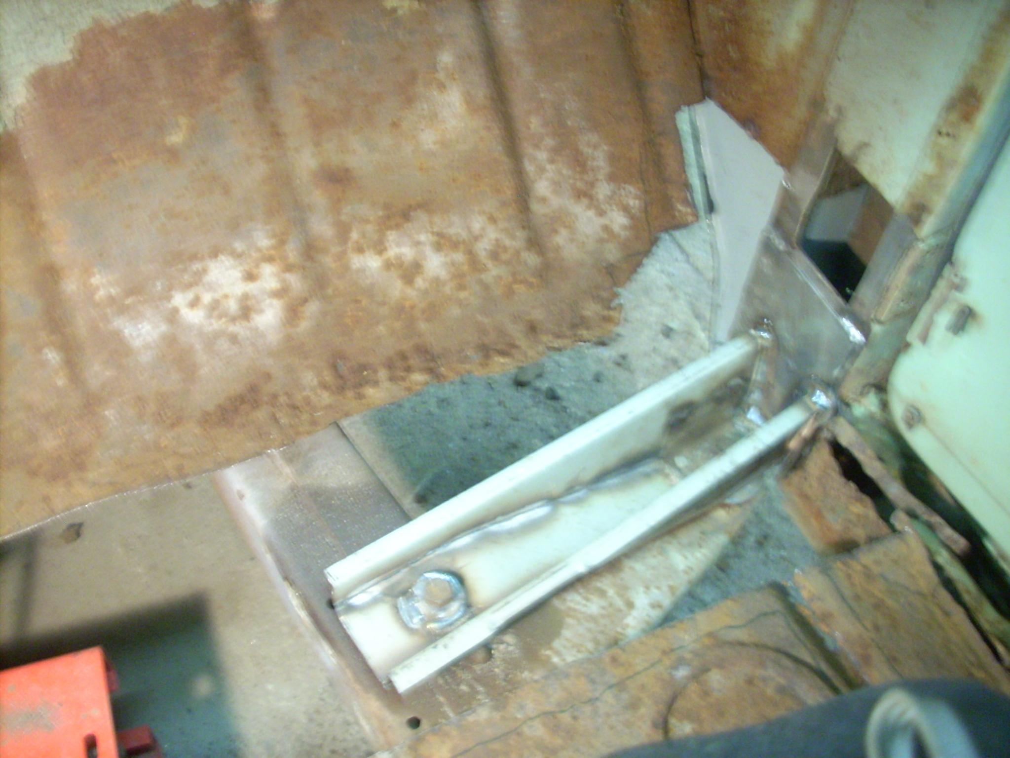

  9. A few mini updates. Factory Mustang headers fit nicely. Fixin the front body outriggers. homemade. Made my own motor mounts that bolt in using the original flathead motor mounts.
  10. Could you plese give more details and pics of motor mounts.
  11. once i get them out i'll take pics for you

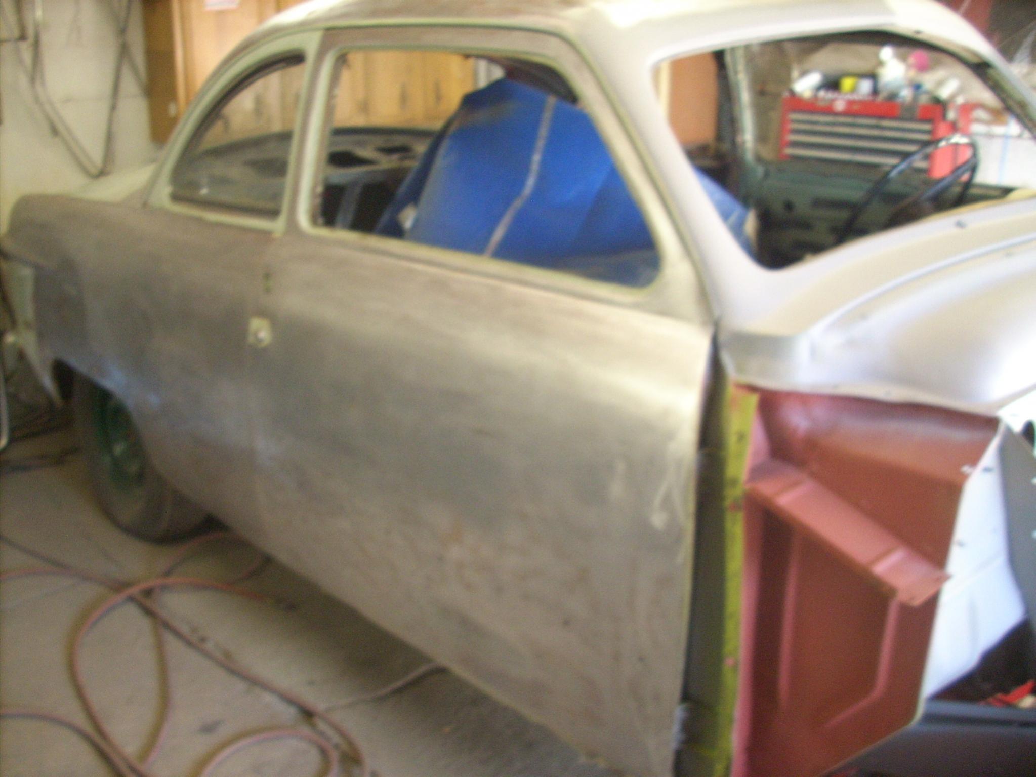

  12. A few months gone by and getting real tired of doing body work by getting closer every day.
    I played with the side moldings with what i have. Eliminating the stock front and door molding. The rt 1/4 molding was toast so i cut a piece off the tail end and saved the spear. Bolted it to the door and welding up the first 4 holes. I kind of like it, for now anyway.
    Also installed a aftermarket gm column with column shift. I like the idea of self cancelling signals, built in 4 ways, neutral saftey and the tilt might be comfy since i plan on driving this thing alot and everywhere. Also don't have to spend money on a shifter. I mounted a 51 wheel to it, i like the 51 meteor wheel with the horn ring off. Got a late model gm wheel and swapped the center hub into the ford wheel. Worked out nice. Since i'm not realy a chromosexual anymore like i was in the 80's, the chrome column will get paint eventualy.

    Well i went back to the body and tackled the front sheet metal. I've done these fronts before and hate lining these up. Pain in the ass. But it's comming right along. I went with the 51 hood mainly because i got it as a extra with the car and was in better shape than the 50 hood. The hood was bent at both ends from a all to common bad latch but i got it repaired pretty decent. I thinking a custom grille from a cheby or pontiac or???

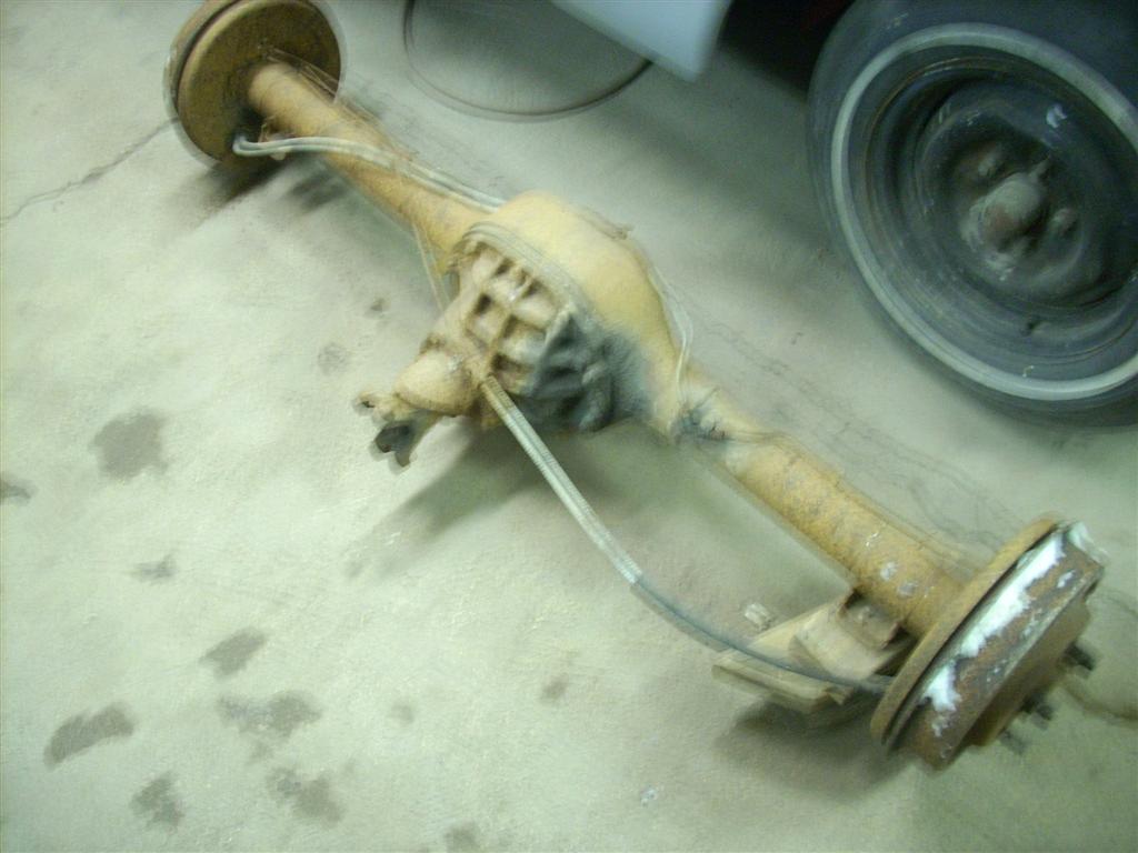

    I had a real good day today. Scored a maveric rear with 3.00's. Good drums, seals and bearings 20,000 miles ago. Guy gave me a hell of a deal at 75.00. Best part was i didn't have to crawl under the car to get it out.
    Also scored NOS windshields in the box plus a extra side for 75.00
    He also has nos front suspention parts that he is going to package deal for me. All old moog and trw. I need i high once in a while

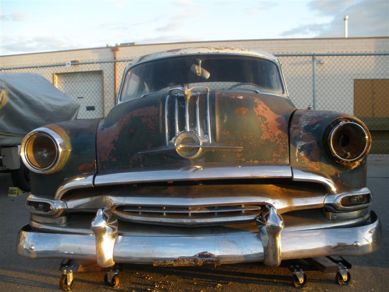

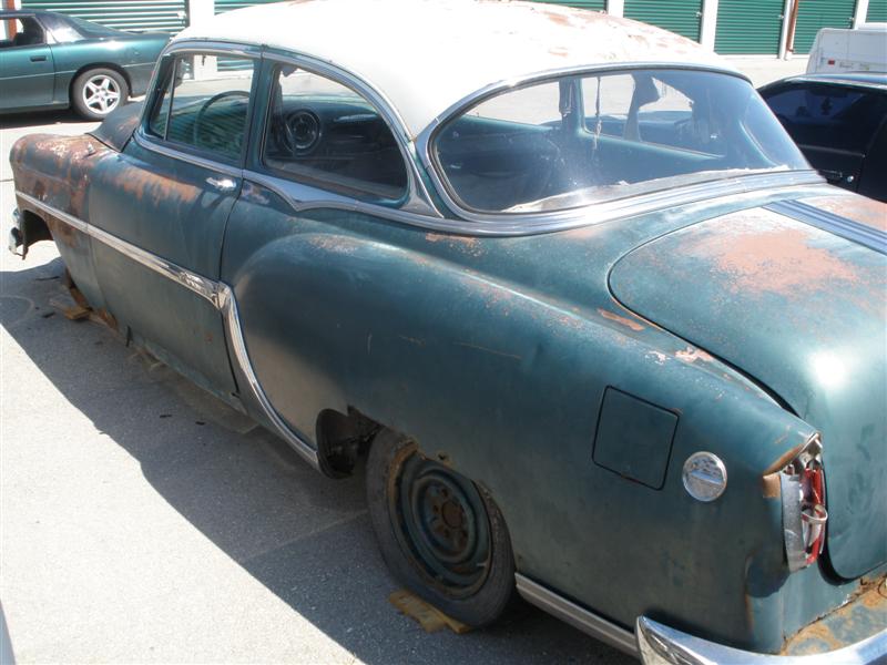

  25. I've looking for a 54 Pontiac grille and discovered they are kind of hard to find, especialy a good one. There is a 54 for sale in town here but i have to buy the whole car for 350.00 to get the grille which needs plating and appears to be crashhed on one side. Debating whether it's worth the hassle of a tow job and having a parts car sitting around. There are lots of other good parts on it and i guess i could part it out, but........
    Would you do it? It is a 54 pathfider deluxe.

    i'll buy the beltline
  27. Haven't seen the car in the flesh yet but ya that belt line is cool. Like to encorperate that on my 50 but don't know it it can be done.
    I'll let you know what comes of this.
