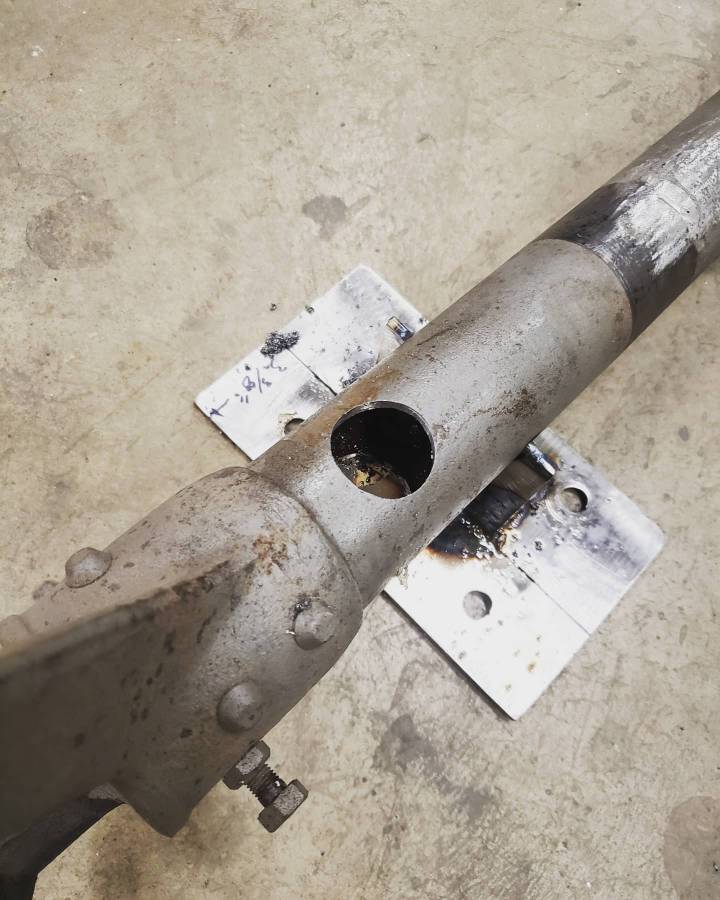

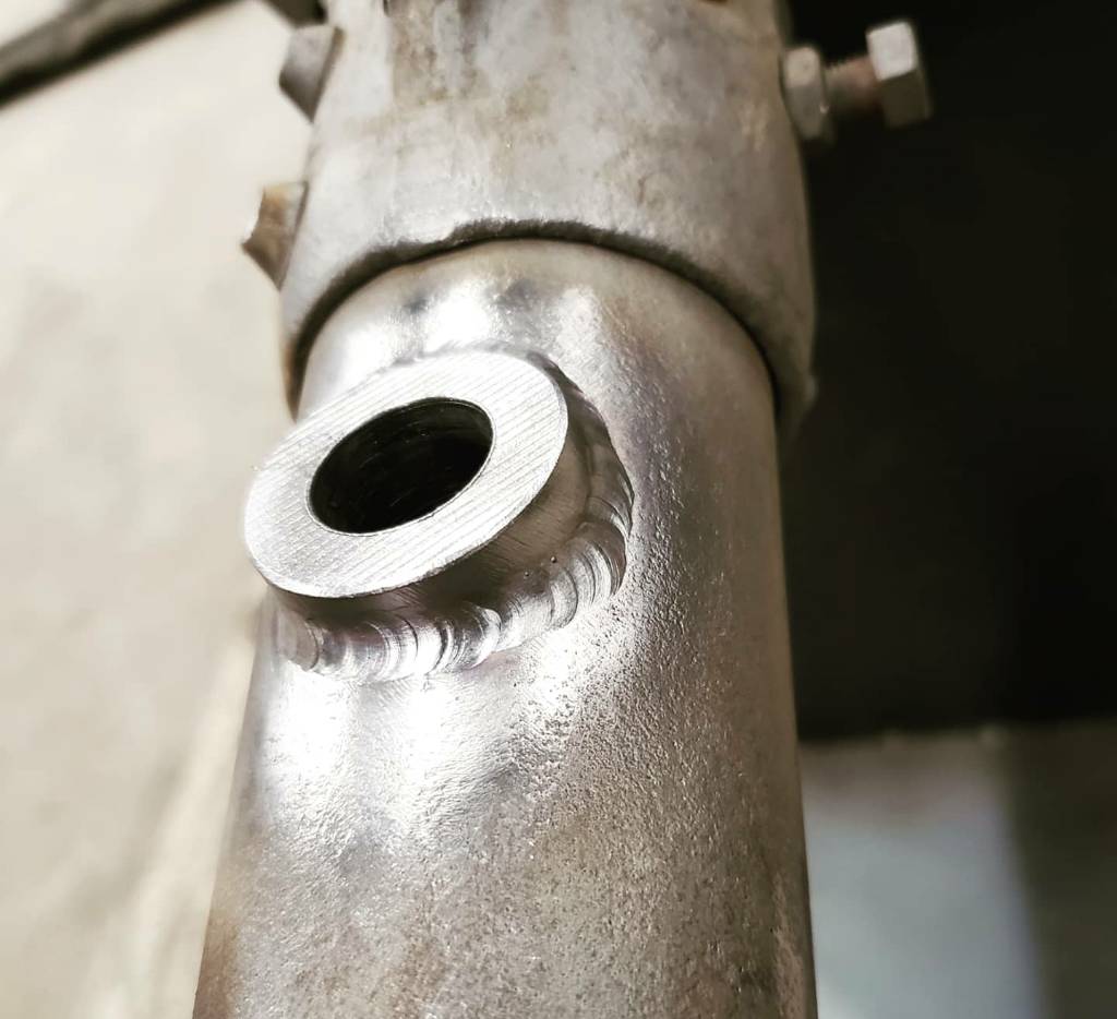

    subscribed! looks great man.... tell us more about your front end which is basically what I have planned for my T...like did you sleeve the axle to put the wishbones on? did you mill that area on the axle or the bones? what year are your bones? do those spring mounts that wrap around the axle come off if cut here and there or is it a grind off procedure? I see the areas where they were but can't tell what you did... I've been eyeing mine up wondering how to do it:D.....do you know if bearings/seals etc. are still available?....sorry about the 20 questions lol I'm just really stoked to see the set up i've been planning (flipped crossmember too) the only differences are I was going to use the stock 6 bolt wood spoke hubs with adaptors(speedway) for wide 5 rims and '47 bones unsplit under the rails to add caster (and also because I have heard that tube axles and split bones don't play well together...) otherwise identical

    Drilled and welded new bosses in for the radius rods perch bolts. Had to open up the radius rods. The new boss are about 2.5" wide. The spindles where machined to fit the T/buffalow hubs. So bearings are easy to find IMG_20210220_193447_549.jpeg IMG_20210220_213029_905.jpeg IMG_20210220_213029_910.jpeg
