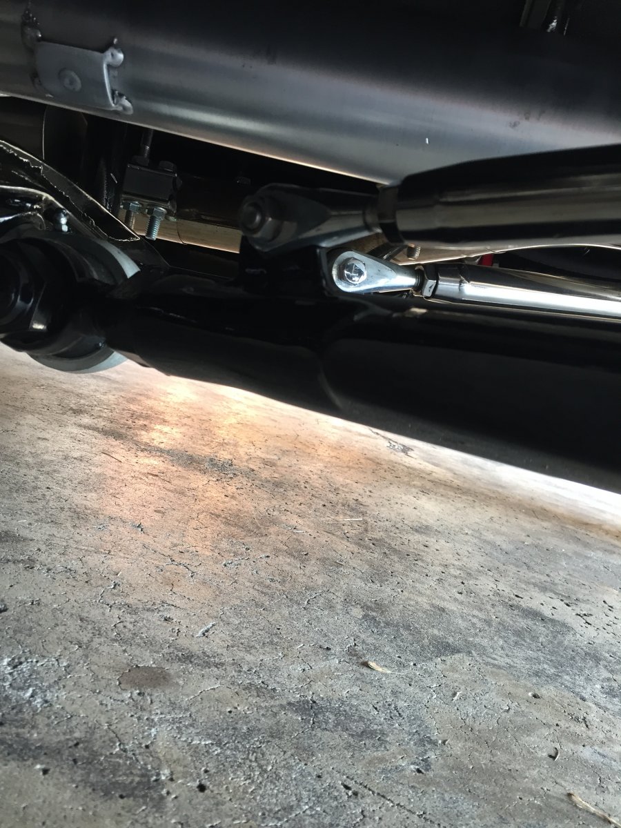

    What is the purpose of the adjustable bars on top of the rear radius rods?

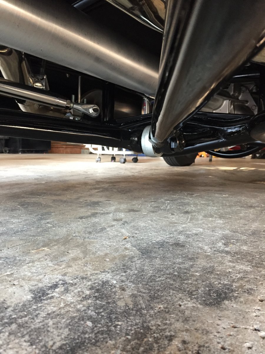

    5B7D1796-A322-4CDA-8B86-723581EEE11E.jpeg 0601B7F2-383A-4EB6-9D2E-4696F91F3599.jpeg D138E8CC-C068-4D4B-B0AA-5D82097517E8.jpeg My 36 rear radius rods were beafed up with a 1/4” pieces down the outside of the arm, it’s blended and hard to see since they are to the outer sides of the car.
    Both radius rods also have a separate 1” tube that go from front of the radius rod to the axle mount for added strength. These rods did make running the exhaust a little more challenging but not real bad.
    Both radius rods also come together at a large spherical rod end (1-1/4”) so The rods should never experence binding only up and down force.

    I planned to use 36 rods on a future project. At what HP do they need to be beefed up? I'm guessing your over 300 with your set up.

    not sure about HP on mine but 300 is probably pretty close to where it’s at, it’s just a 331 w/10-1 and a mild cam, I built it to drive
    You have to watch the radius rods for corrosion, Plus ford had torque tubes that took allot of the stress off the arms. Make them strong and forget about them was my theory

    One observation...respectfully. I see a big angle difference between the radius rod and drag link. No bumpsteer? I wonder if it could be improved?

    No bump steer, there is a thread where a respected person here explains why cowl steering typically causes bump steer. If you read it then you can see that while my setup is not optimal it can work with just a small amount of bump steer. If the car had twice the travel that it does than it would probably start showing signs of it but honestly it never pulls the steering wheel over a bump

    No noticeable bump steer. That's good. I did read the bump steer thread and understand what you're saying about limited suspension travel being beneficial in this regard.
