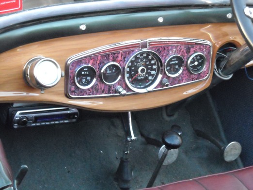

    Recent pictures of my Roadster Pickup showing recent tinkering, new dash, strombergs etc.

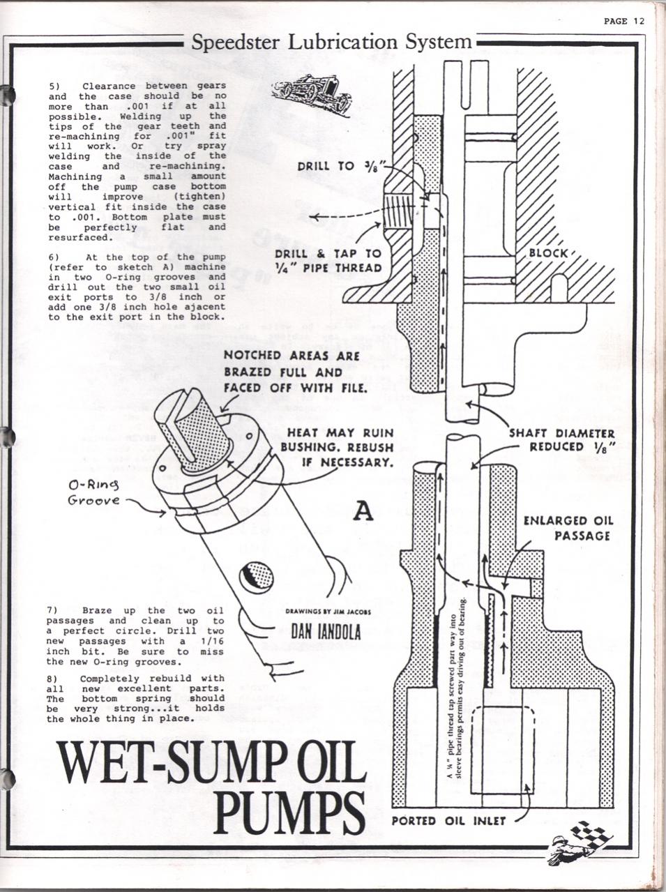

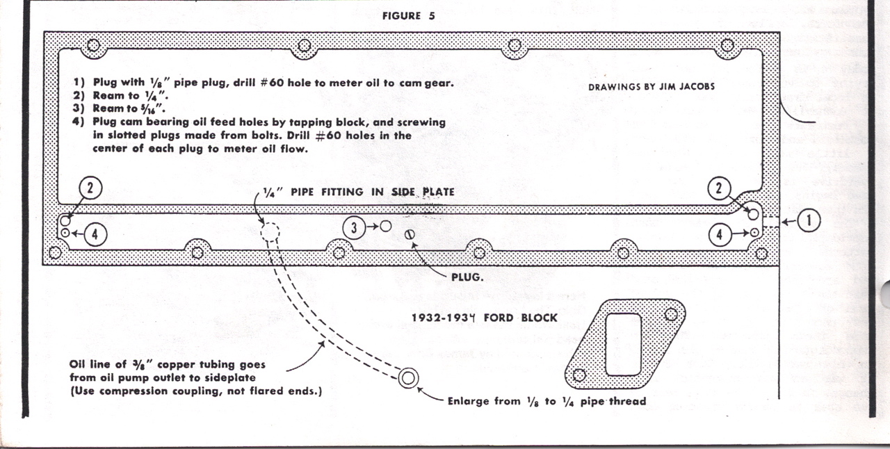

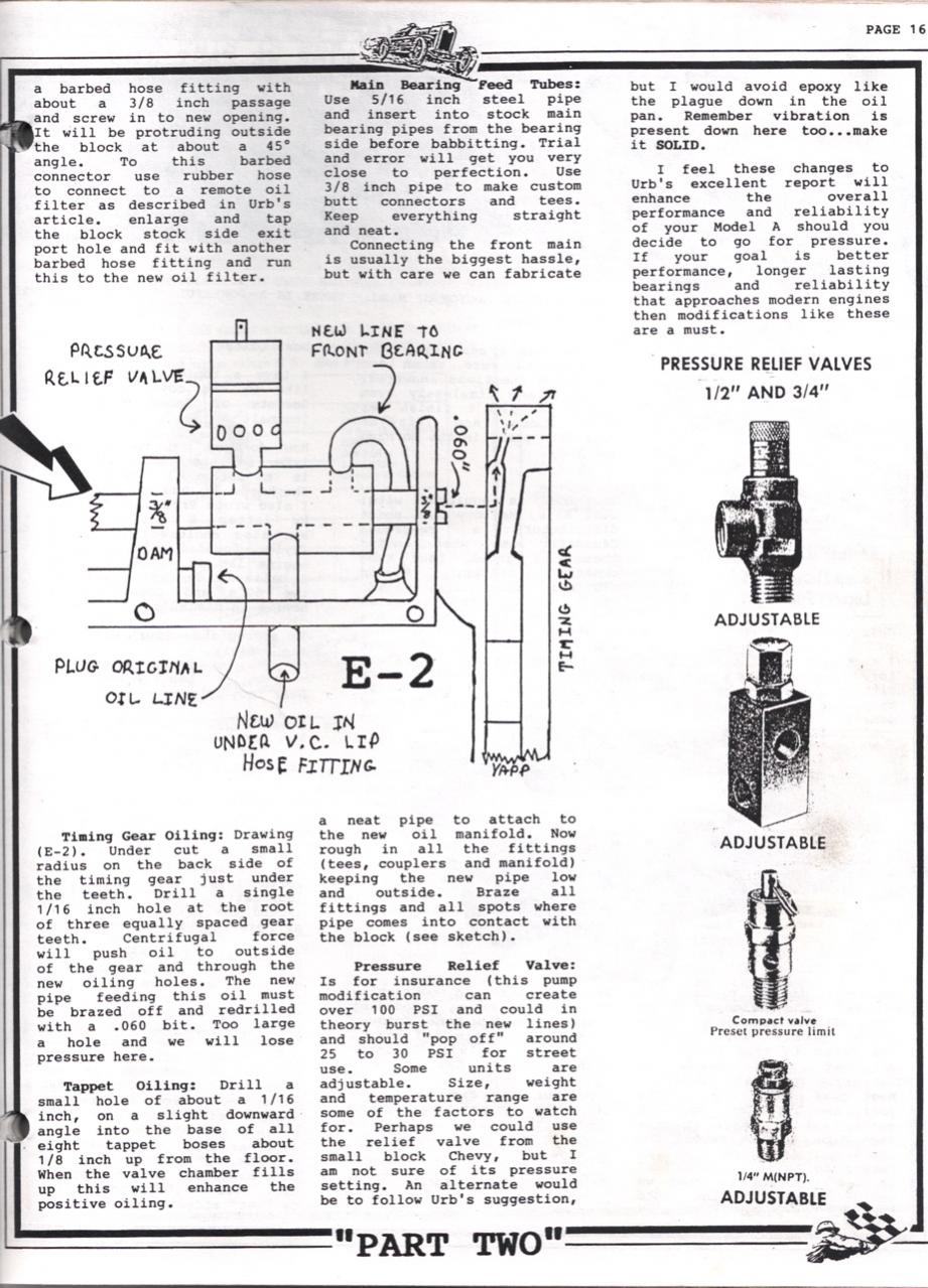

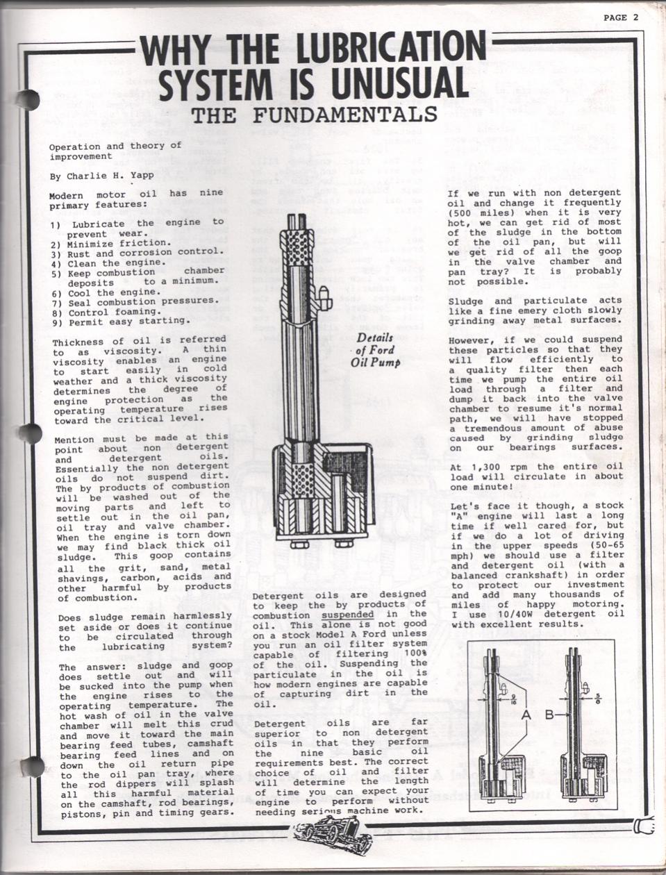

    I am in the process of converting my B engine to pressure oiling. I will plug the oilways to the cam bearings and timing chain chamber, should I drill oil holes in the plugs if so what size ?
  25. I have a book here that I could copy for you.
    Email me your address and I will get it to you. It has all the info you require

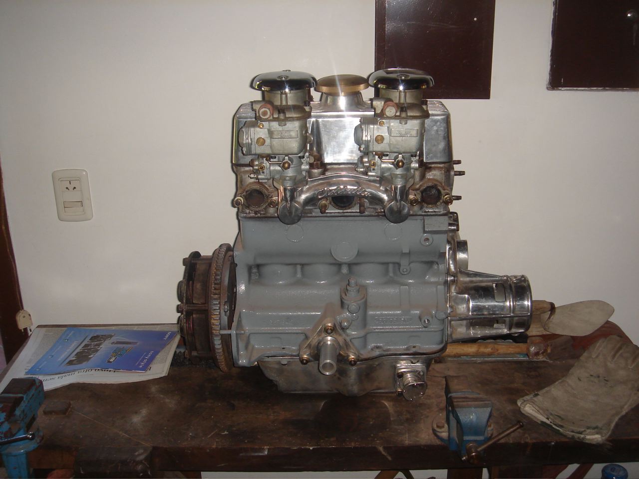

    Saw this photo in the "Robert Stack" thread on the Hamb. Poster said Robert is getting ready for the Harper's Dry lake event. Check out the blown banger he's working on!
