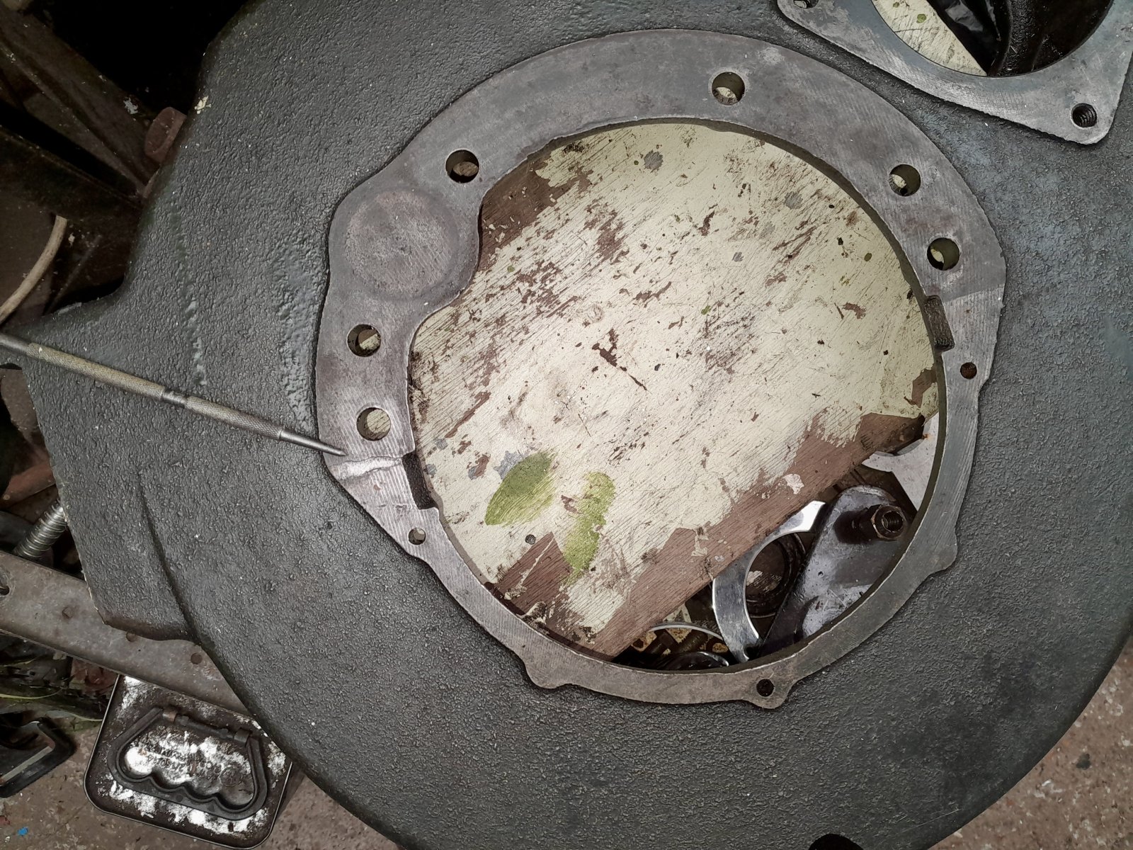

    Checking in with what I think is a common problem.
    What needs to be done about this crack, attempt to weld it, braze it, bolt a stiffening patch across it, or pretend it's a tractor and slap some JB Weld all over it on both sides?
    Or my favourite, drill a hole at the end of it then ignore it.

  13. Put it back together and if the clutch doesn't judder, ignore it.
    Meantime, keep buying more and more engines in the hope of finding a flywheel housing without a crack...
    The37Kid and Outback like this.
  14. I may have revealed too much about my addiction there.

    Reckon I'll be doing just that, if the clutch does judder a decent bracket from the hole below it to a pan bolt would most likely cure it.

    I hog the cracks out V grooving chasing the crack....drill the end of the crack...
    Then preheat the whole schebang using a propane weed burner .....not getting too carried away, Oxy-acetylene silver braze the groove up using Harris Stay-Silv flux and 15% silver. Flip and repeat on the back side.
    I've had really good luck doing this over the years and done it for others.
    Don't have a photo of one but here is a oil pump someone dropped and busted the drive end.. I repaired the cast the same way with silver

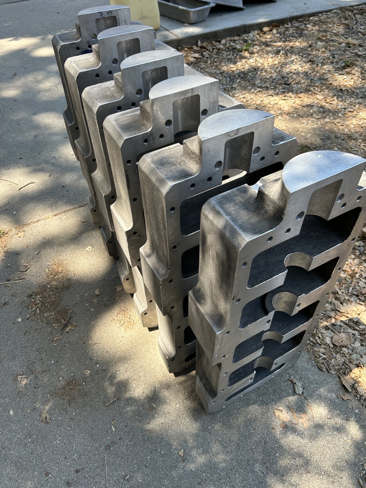

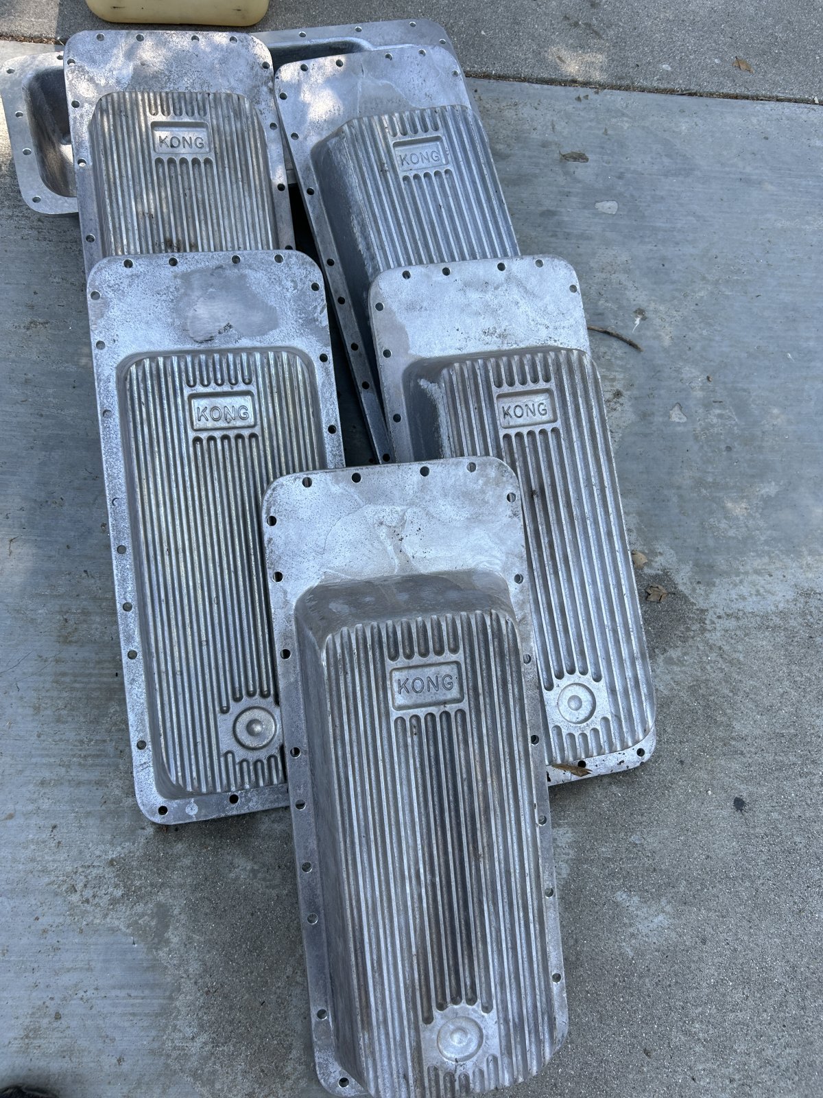

  30. Kong Girdles all ruff machine work finished today
    Going fast, not doing any more runs for awhile
    J
