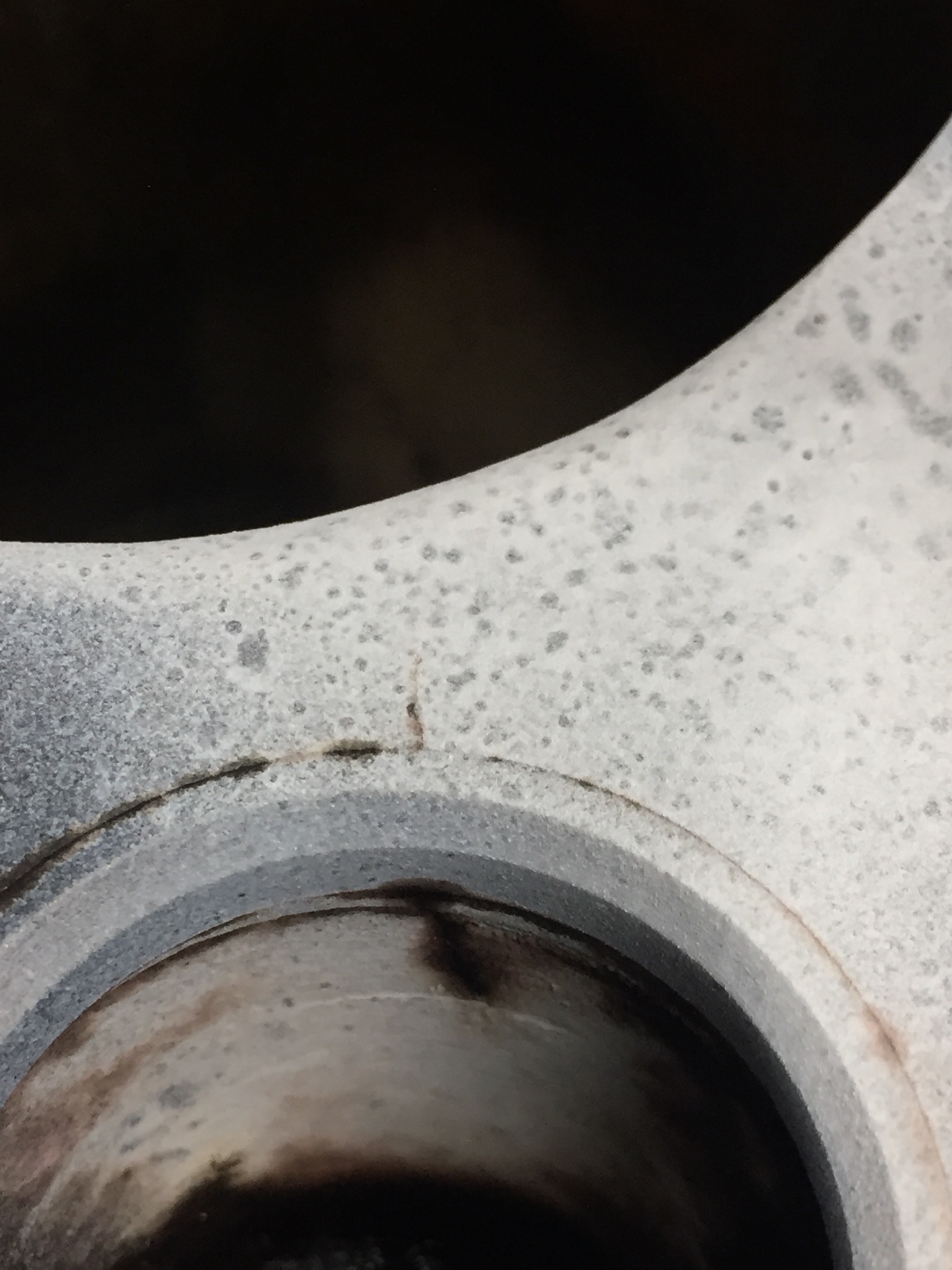

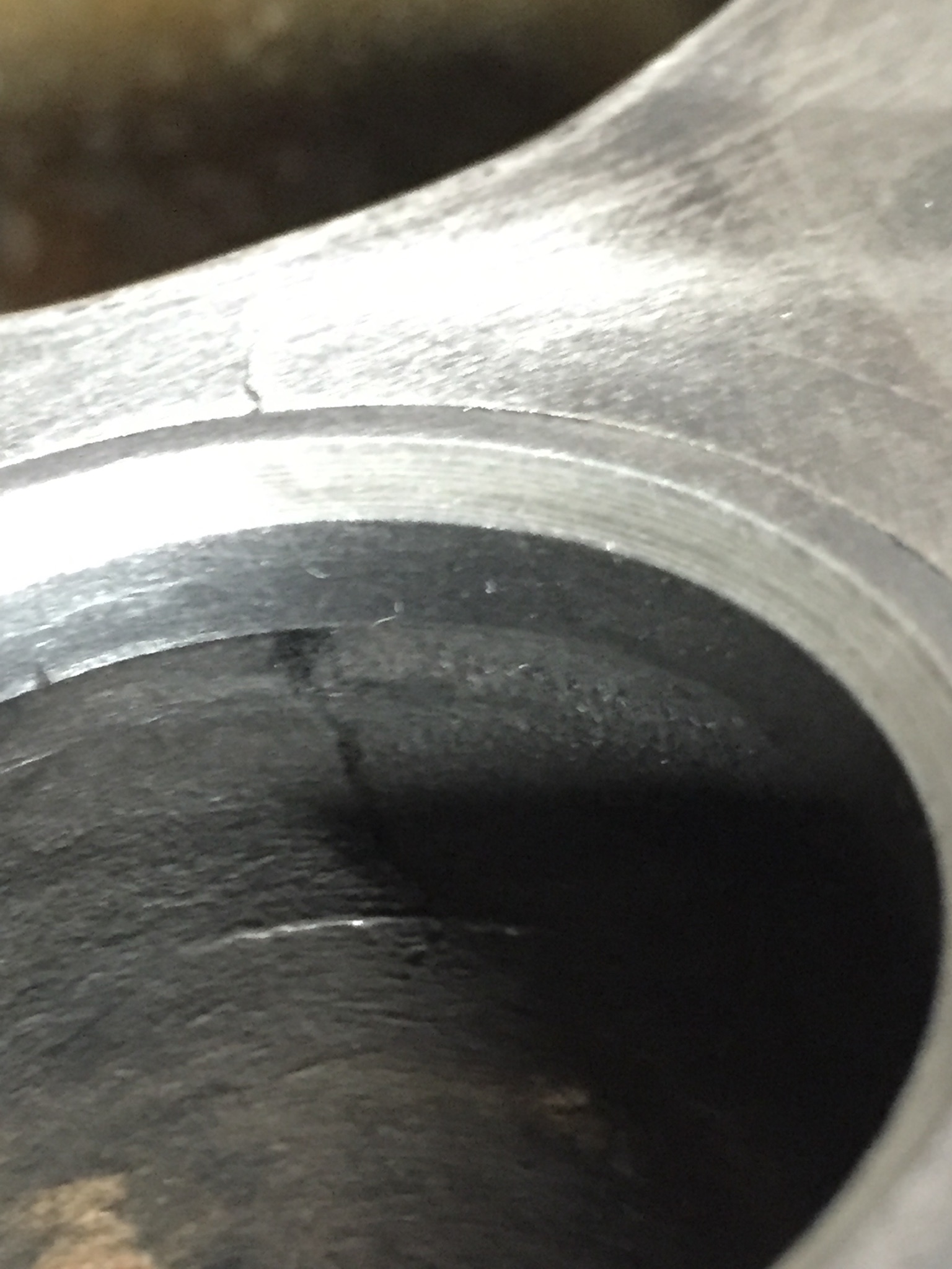

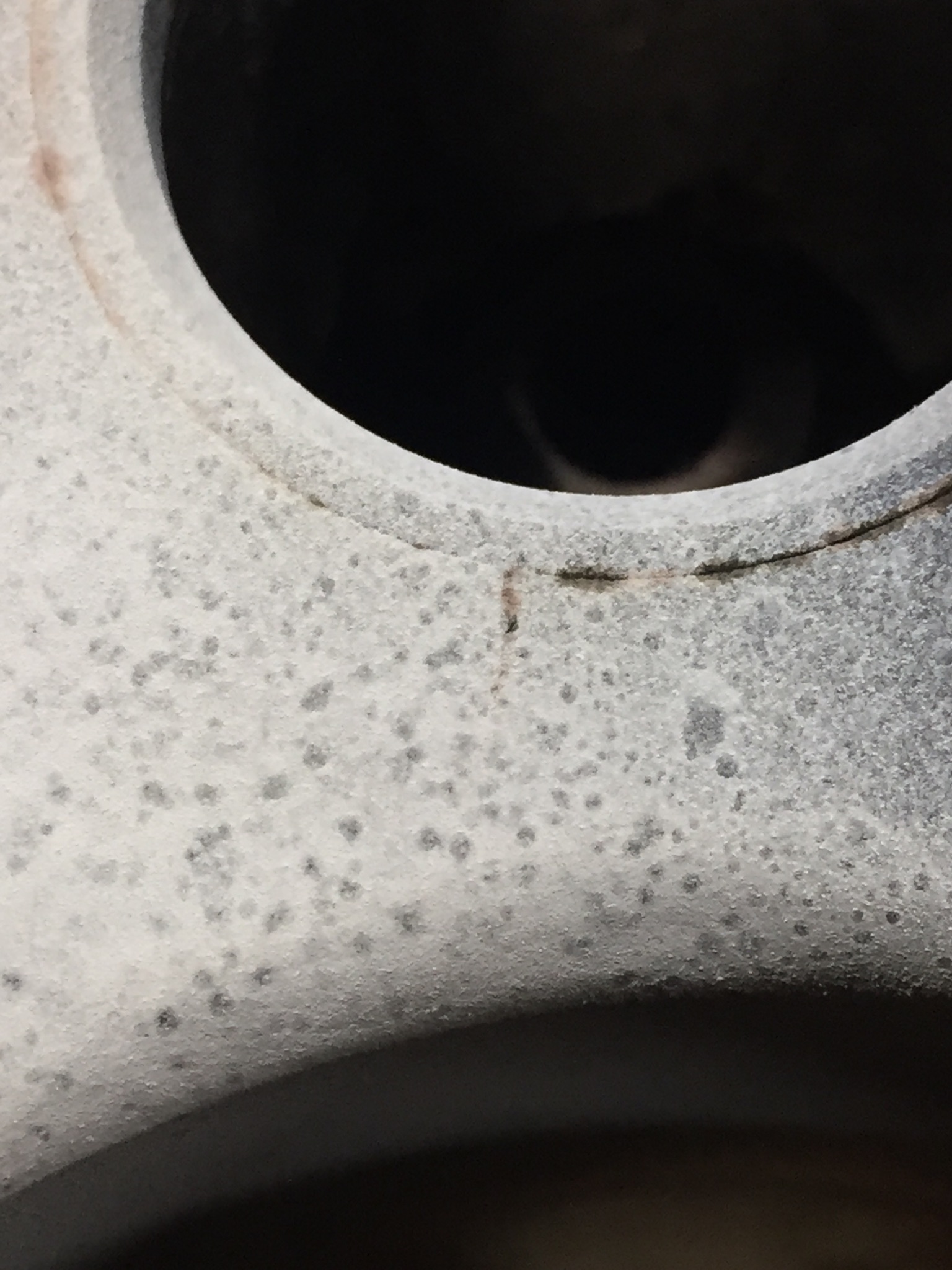

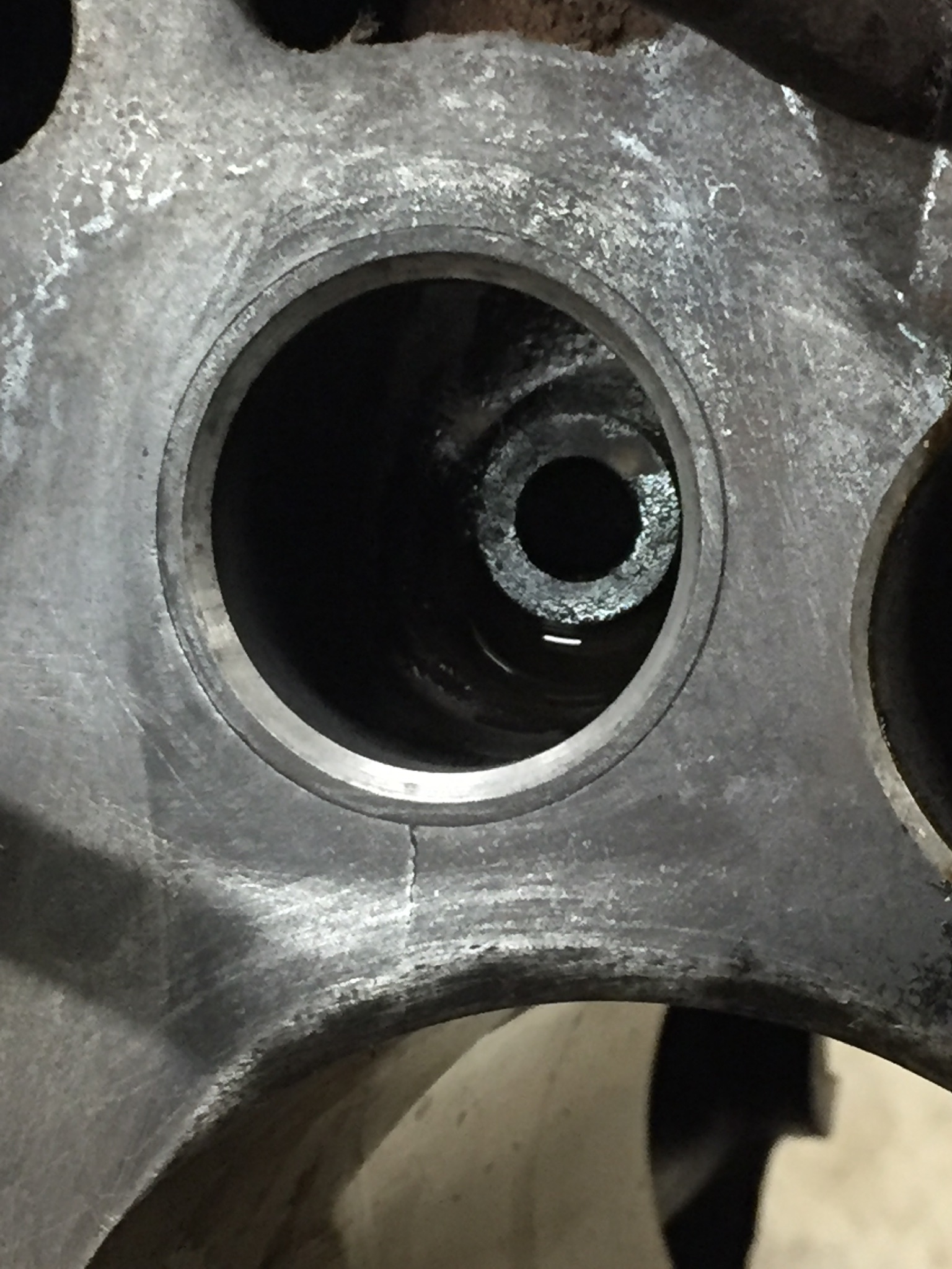

    For those who answered / advised or were interested last month, I spoke to my engine machinist and was advised 2 ways to look at it.
    Pressure test (low pressure) the block to first see if it’s just a heat crack or into the water jacket, if just a heat crack, fit a cast seat( some special cast seat material) and as it would only be run very infrequently, monitor it.
    If into the water jacket, stitch , sleeve and a new seat and it should be okay.
    This was all before I cleaned it up and cracked tested it last night with dye penetrant just to see the extent of the crack.
    Already has a seat installed so could be a old repair as this engine has some history with it.
    No crack to the seat (shouldn’t be really)so chicken and egg scenario!
    Yet to pressure check and see that outcome.
    The full stitch ,sleeve and seat scenario is on the cards but I live in hope.
    My first block crack experience so learning on the run.

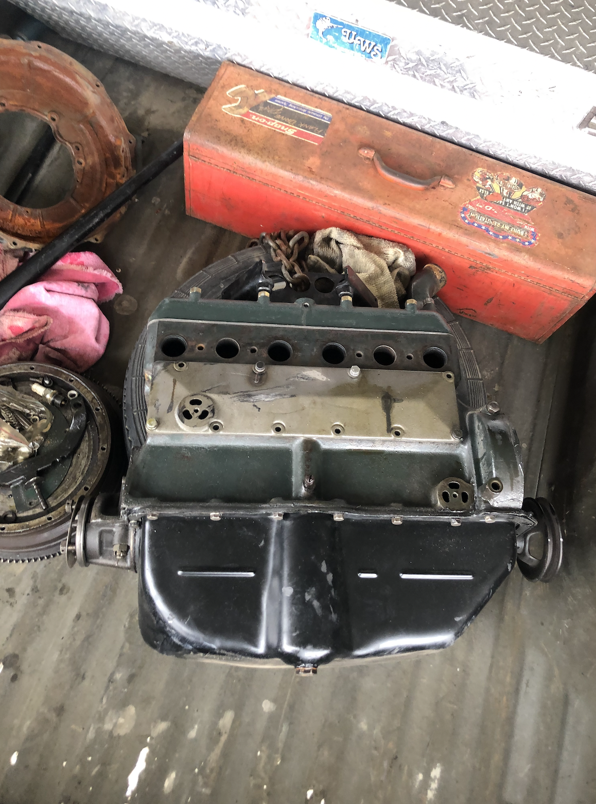

  9. Checking in!
    Went and picked up the donor engine for the Model T.
    Found a surprise, .330 lift cam!
    Screen Shot 2021-06-01 at 7.14.26 PM.png Screen Shot 2021-06-01 at 7.14.15 PM.png

    Thanks Railcarmover, could well be in my future. Definitely worth the save.

  15. railcarmover
    Joined: Apr 30, 2017
    Posts: 657
    railcarmover
    I look at it this way...cracking relieves tension, Odds are its done cracking,fix this and the problems are over. Course, what the hell do I know..we are dealing with the gods of ford grey iron castings..

  16. My $0.02
    This looks like it was repaired once already, I am not sure about the corner of the bore, the ground off edge.
    To me, it looks like it may have been welded once. What is the bore size?
    The crack is not that bad, if you are going to drive it only occasionally, do the pressure test, 15psi max.
    If is leaking just a little, I would just add some sodium silicate and run it. You can do more damage to the port wall with pins and pushing in another seat. The reason is simple, there is marginally enough material there to support having another seat put in and remember, seats add stress to the casting.
    To be honest, blocks are around, having larger valves installed is very inexpensive, babbitt to bearings is again economical. It just depends on your intended purpose with the vehicle.

  20. Barrelnose pickup
    Joined: Aug 20, 2008
    Posts: 1,309
    Barrelnose pickup
    Appreciate your input John, and the pressure test and adding iron tight is on the cards if only a minor leak.
    I also am worried about further dramas doing the major repair route.
    As for blocks being around, larger valves being very inexpensive and Babbitt to bearings being economical, not down here mate, not in our world. My engine machinist is sending 2 blocks across country(a long way) to have the Babbitt redone.
