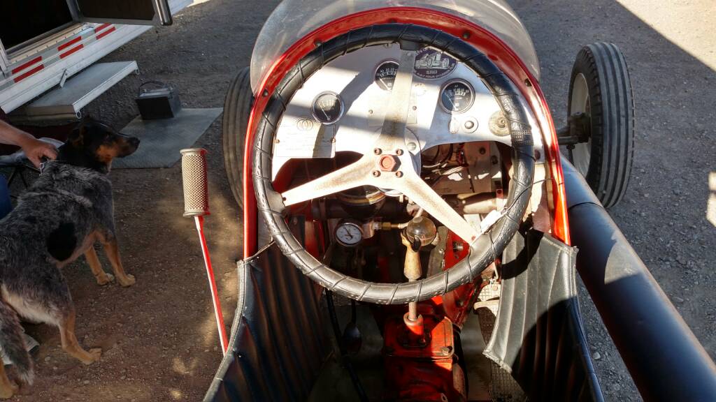

  13. 2014-06-05 17.47.54 (1).jpg I'M IN! At Sonoma Raceway (Sears Point) last weekend we started last (because I hadn't yet been accepted as a "Gold Medallion" car) in a 12 car race. I turned in a qualifying time of over 10 seconds better than my previous time at that track; and 3rd behind two ERA's (pre-wwII) Gran Prix cars). Nevertheless in only 9 laps (that was the race) I was able to get within a couple of hundred yards of the third place car (a Ford 24 Stud V8 powered Sprint Car. Another "Force" for "Bangers"!
