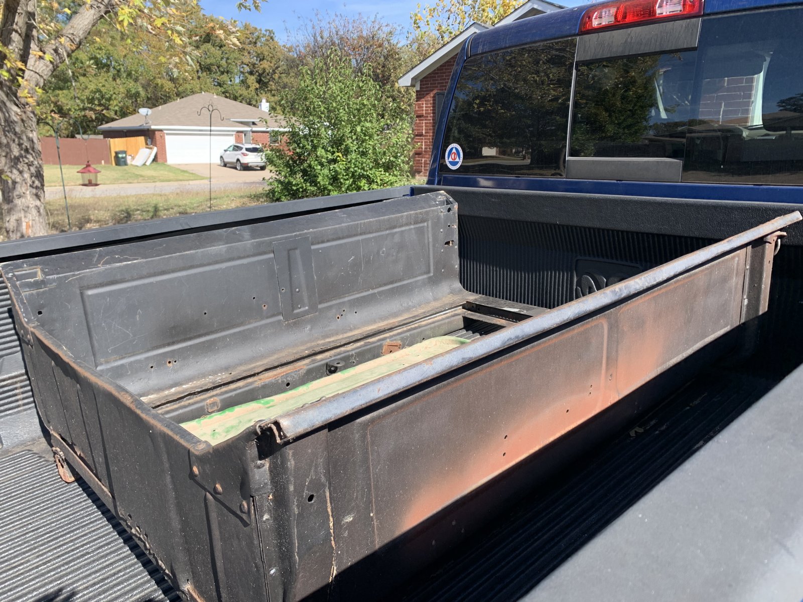

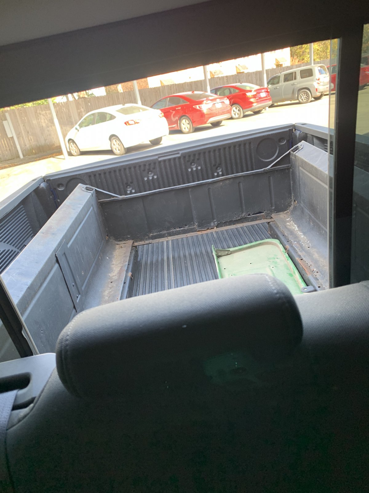

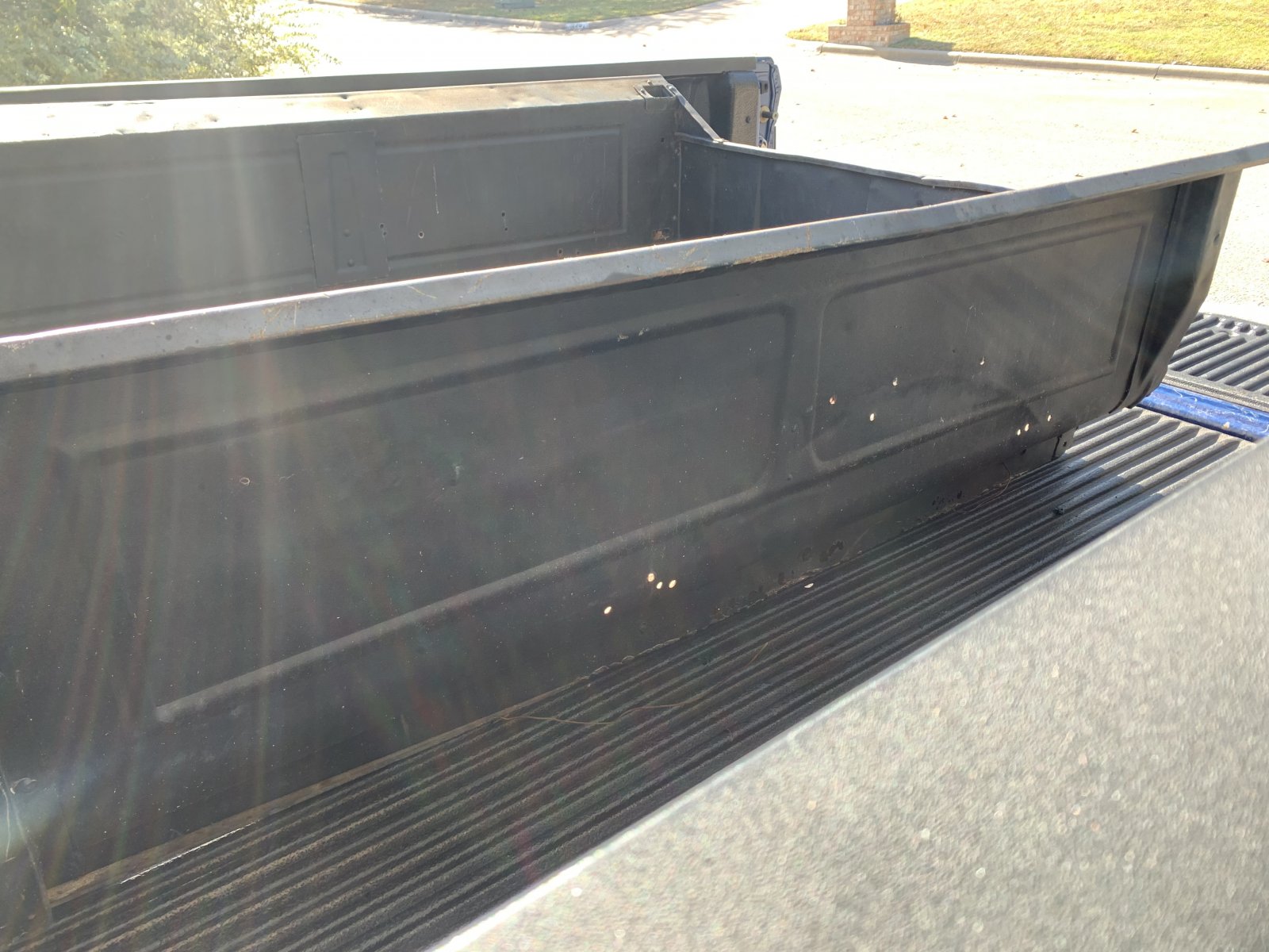

    6F8872B2-BF25-4E1B-86BD-29B60ECCC707.jpeg 9EB16E75-CB23-4840-96B7-BAF5E9A8A4BD.jpeg
    Decided to still pick up the early T bed for $350. It is really solid (panel behind cab is a little fried but not bad) and straight and I like the bed sides… think it will look a little better. If I don’t like it I’ll still have the Model A bed and I’ll just make a trailer out of this one or sell it on.

  25. I've seen double cab trucks, that is the first double bed truck I have seen.
    '51 Norm and trevorsworth like this.

    It really hammers home how tiny these trucks were, or how huge modern trucks are (or both) when the T bed fits between my Ram's fender wells with plenty of room to spare.

    Thats one clean ass T bed... Nice score for sure...
