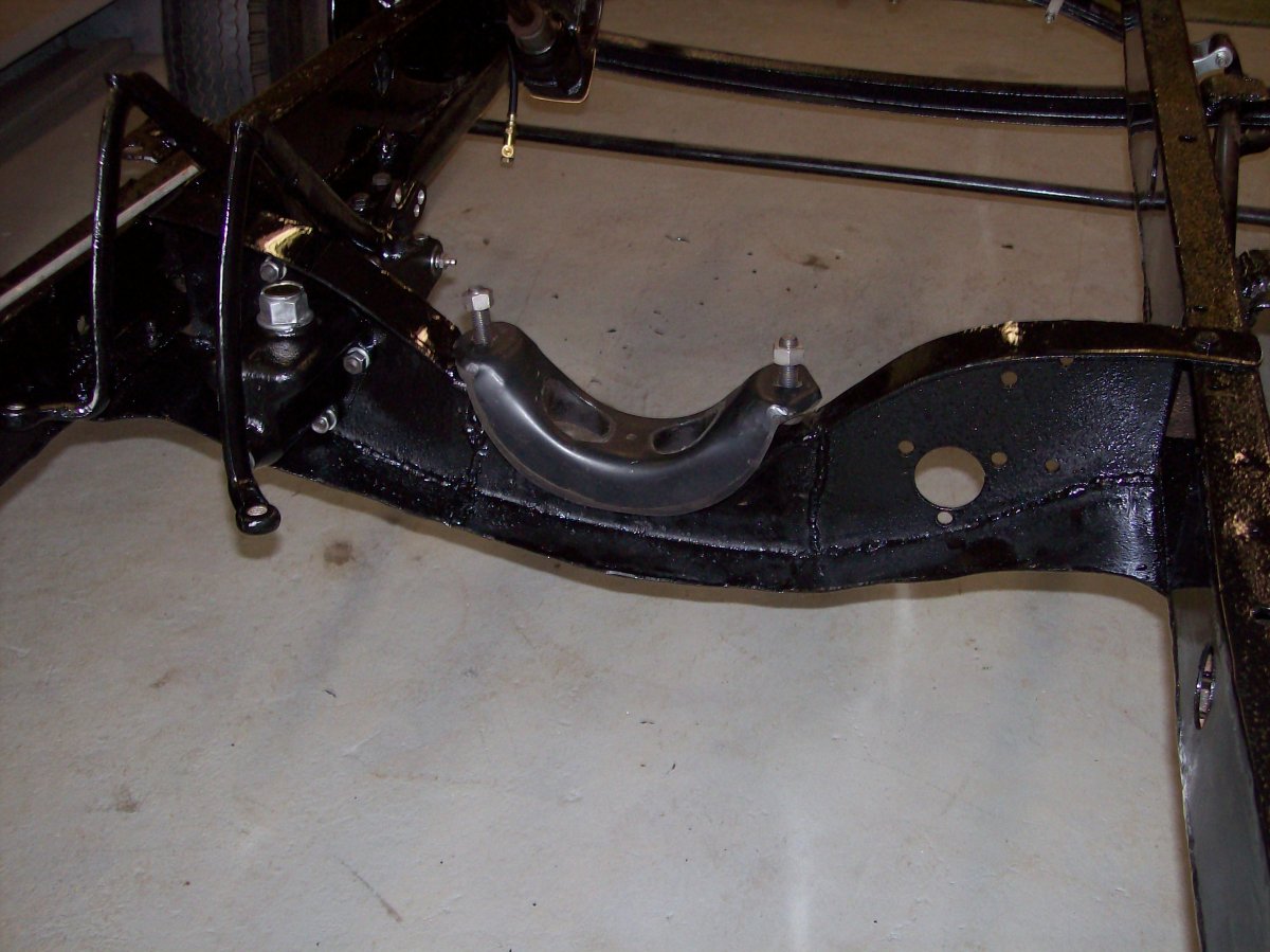

  13. As @flatford39 mentioned, an F1 crossmember is a great fit that gives you pedals and mount for a master cylinder, but to your question, yes, guys have used 40 x members and slice and diced them to fit. There's a few threads on here at least. If you can get it cheap and aren't afraid of a little more work, go for it! Easier than sourcing something you don't have a lead on.
    You'll have to narrow it width wise, and I've seen guys slice and taper the arms to fit into the A frame (40 frames are vertically thicker).
    MBog and trevorsworth like this.

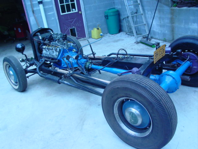

    1934coupe
    Trevor this is A-V8 I did with the F series mount, I think it was an F-3 and I did a bit of work on it. The end result worked out fine.

    I acquired most of an x member from a sub framed ‘46 and since I did not have it all I had to reverse it, front attached to the back. Location determined by bolting up the trans mount, slice & weld until it fit. I had to fab front pieces as well as mount for 48 F1 pedals. I drilled, tightened up bolts and welded nuts to fasten rather than try rivet, boxed frame. Have 2 more A frames & looking for more junk later frames so I can do it again.
