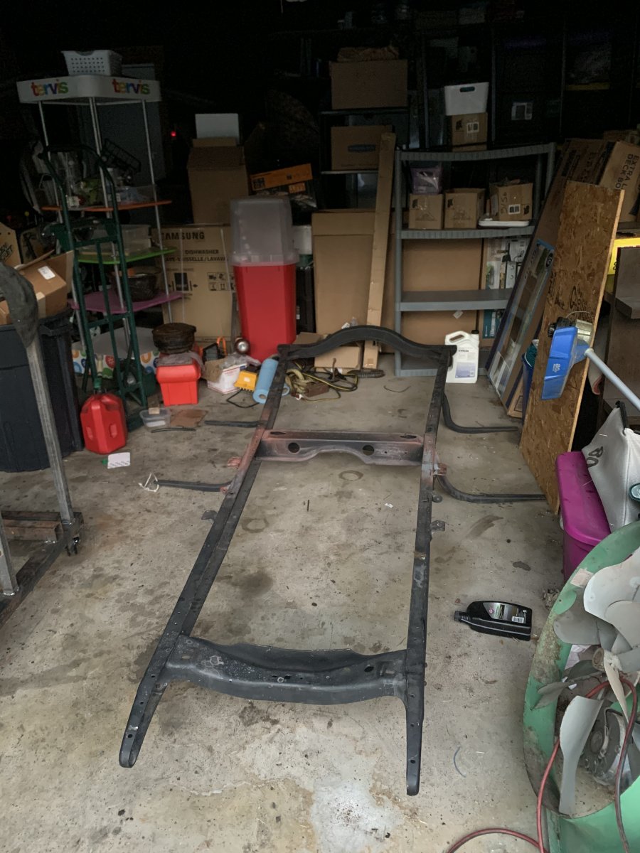

    This frame has no tag that I can find, not a big deal from what I understand in Texas. How can I determine the year of the frame?
    I need to go ahead and get a rear leaf ordered I suppose so I can make up the new perches. The sooner I can get 4 wheels on this thing the easier it will be to figure out the next steps.
    Kind of want to stick with a stock spring in the back, reverse eye in the front... give it a bit of a rake. Is the truck rear spring any different strength wise?

  10. flatford39
    Joined: Dec 3, 2006
    Posts: 2,799
    flatford39
    If you post a pic of the front cross member I can identify it. 30 31's have a slight indentation below the frame rails where the radiator sits. 28 29's are flush with the top of the frame.
    There are different rear springs but I wouldn't worry about which one you buy. You can always remove leaves if you think it's sitting to high. I am actually using a "T" spring on mine as I want it lower.
    If you can find some model A axle bells you can cut of the rear spring hangers and weld/bolt to the 40 rear end. There is a really good thread on it by @Chris on it that shows you what to do.
    The serial number is stamped in the frame under where the left cowl sits.
  11. trevorsworth

  12. alchemy
    Joined: Sep 27, 2002
    Posts: 20,524
    alchemy
    Sure looks like you have a 30-31 frame. Works just fine on a 28-29 too, and you can shim up the radiator if need be.

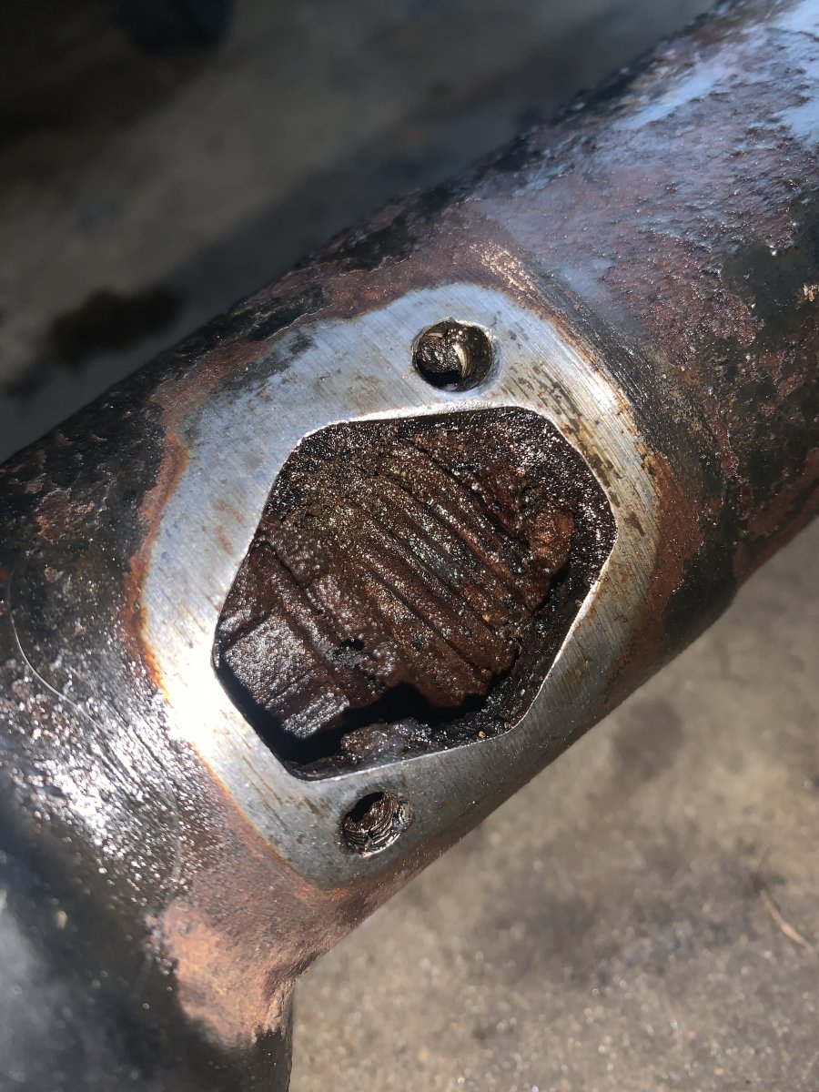

    Playing hell trying to get this torque tube off. Seems like it is seized to the drive shaft. I have removed all the bolts holding it to the pumpkin, the radius rods, and the speedometer gear housing. I can turn the torque tube back and forth a little but the drive shaft moves with it and they will not separate. I have soaked it in PB blaster to no avail.

  16. 1-SHOT
    Joined: Sep 23, 2014
    Posts: 2,702
    1-SHOT
    from Denton
    Have you taken the clip off the speedometer and remover the gear

    As I said there is a bearing in the torque tube about midway. Look for a zerk fitting. If the Zerk is there try greasing it. You can spray PB Blaster down it and let it sit for awhile. It's probably hung up there. Sounds like it got full of water. Hope not, as that is the kiss of death for the gears.

    What's the clip yall are referring to? I removed the whole turtle-shaped speedometer blister deal. There was a gear inside it. All I can see through the hole it left is the drive shaft.
  20. Dedsoto
    Joined: Jan 7, 2014
    Posts: 321
    Dedsoto
    from Australia
    1. Aussie HAMBers
    You should be able to see the drive gear through the window, there'll be a circlip holding it in place
  21. rusty valley
    Joined: Oct 25, 2014
    Posts: 3,885
    rusty valley
    at the very front, just in front of the speedo gear, big C clip, small screw driver will get it
  22. trevorsworth

  23. Dedsoto
    Joined: Jan 7, 2014
    Posts: 321
    Dedsoto
    from Australia
    1. Aussie HAMBers
    Bit gunky in there huh...
  24. 1-SHOT
    Posts: 2,702
    1-SHOT
    from Denton
    Glad you you found it. Frank
