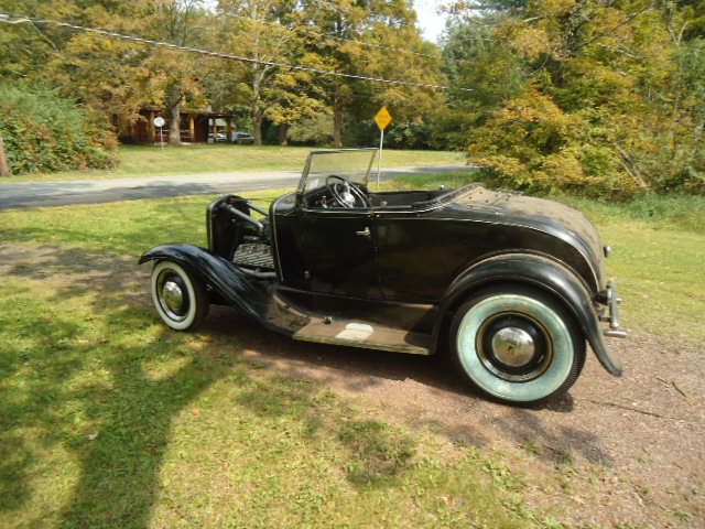

  11. Here's a little motovation for ya. About a 10 year old photo of my Roadster. They don't have to look like a Million dollar deal to have a Million dollars worth of Fun with them. Everything you see sitting on the Tires are take off parts from Customers builds from many years doing this for a living. All I have invested is time.

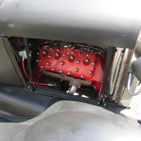

    Trevor here are a few pictures of a low budget build. My good friend Don Butler just passed away last Friday after a long illness but I did the chassis on this Model A sedan, I think it's a 29. He bought the drivetrain from a 37 Ford wheels and all, was supposedly a running flattie. He only cleaned it up we put a open drive conversion, F1 steering box. The chassis and body were decent. He did the body work and sprayed it. A pair of buckets from a junk yard. He didn't have much money so he bought used and swap meet. We read the A Rod book by I think the name is Tardall. He was driving it and enjoying it since built in 08. So go slow and enjoy.
