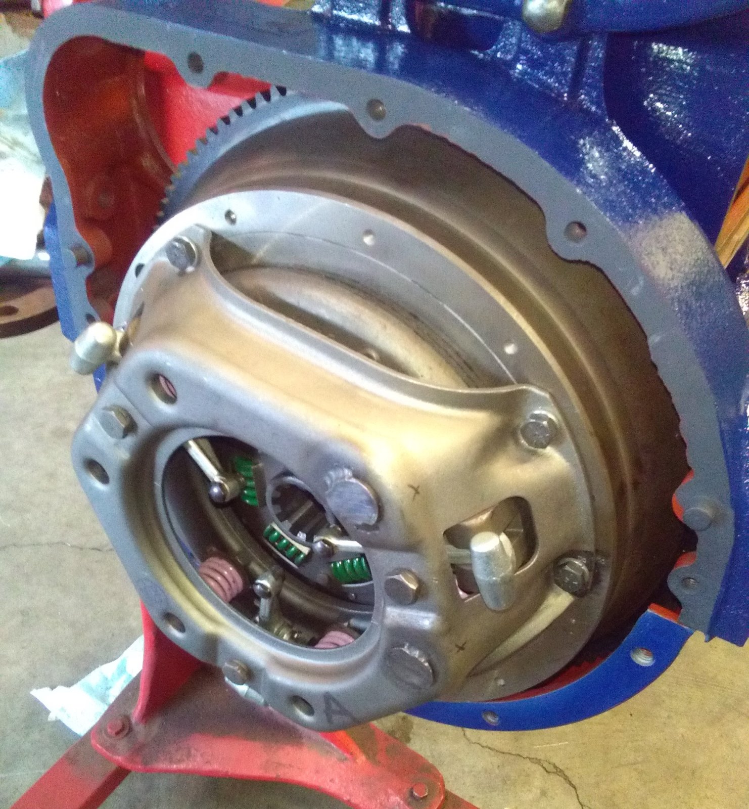

  7. On looking hard at what I have.... is this the wrong pressure plate? When it is installed with the disc there is not a lot of play left in the fingers. If I put a straight edge (2x4) accross the top the fingers are almost an inch in when installed. I am also including a shot of the plate when it sits on the table. As this is a lightened flywheel is it possible this is for a stock flywheel?
    Outback likes this.

    Dan from Oakland
    Just measured the clutch fingers on on an engine here with the disc installed. From the surface where you have the 2 x 4 sitting on your cover to the tips of the fingers is 0.580". (To clarify, the finger tips are 0.580 forward from the flat rear side of the pressure plate.) Again, this is with the disc installed and the pressure plate mounted on the flywheel and torqued. The pressure plate in you picture looks correct for a converted flywheel. I don't understand your 1" dimension- that would mean that the friction surface of the pressure plate and the springs are compressed WAY too much. How thick is your disc?? the one in this engine is new and measures pretty close to 11/32" (0.343"). The overall height of my pressure plate from the flywheel to the rear most surface is 2.790"
  9. Something is off the arms don’t look like in the right position
    It looks to me the pivot points are too low in the cover like the fulcrum blocks are too long
    These are the ones located under the 3 bolts shown in the last picture

    wuga
    My observations. I run a 9" long style clutch on my banger lightened flywheel with no issues. I have not personally used a 10-10.5" pressure plate, but I have read on several occasions that the pressure plates with the external counter balance as shown in your pictures cause interference and bad contact. Those counter balancers have been removed to get good contact.
    Warren
  11. . From fingers to the rearmost part of the pressure plate is .75". Other measurements are similar. it does also look like the clearance from the fingers to the springs on the clutch is very small .40"

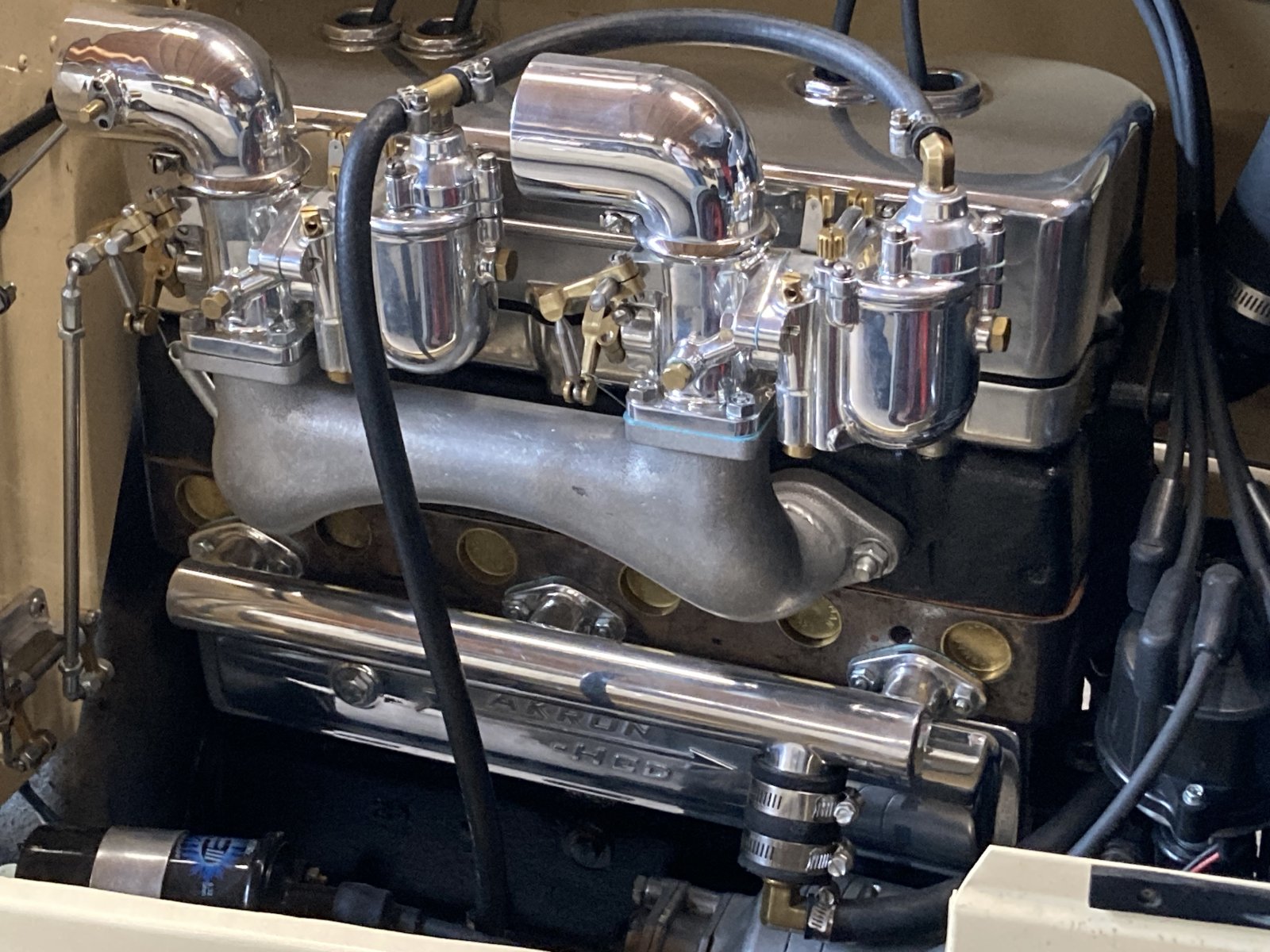

    Kevin Pharis
    Makin progress today on another thing I don’t really need for the Akron-Hed motor. Will get out the tiny tools tomorrow morning and finish the raised lettering detail. I’ve only got a couple of the tiny tools… if I break em both this thing gets the smooth look!
    burl, studebakerjoe, 40 Olds and 2 others like this.

    winduptoy
    Do you need to just lengthen your clutch linkage rod?
    Seems to me that I had to do that at some point in the past to make all the parts play well together for the V8 clutch. Also, the pads on your pressure plate fingers are threaded. You can run them out some to get them closer to the throw out bearing....again, seems like I've done that too at some point in the past.
    My personal experience is that a lightened flywheel and V8 clutch is a modification that makes an A more drivable than any other....good luck

    Kevin Pharis
    Only took 4 hours but the little .030” ball mill survived the whole thing! Will carve the back off tomorrow, then a crappy polish job to finish:cool:
    burl, studebakerjoe, Flatdash and 5 others like this.

    Kevin Pharis
    Only now, can you all truly grasp the udder ridiculousness of this side cover project! :rolleyes:
    jet996, mvee33, burl and 8 others like this.

    Outback
    from NE Vic
    From you Kevin it is not at all surprising! Does it improve the performance at all? It's gotta be worth at least half a gigawatt!
  23. I had the clutch pedal adjustment all the way out. It really seems like there is not enough movement. The clutch sat at the machinists for a couple years. I wonder if it is flat out the wrong one. I also have a stripped out hole on the flywheel preassure plate mounting. At this point I am very skilled at pulling the engine, so I will look at getting a burtz flywheel and clutch and change it over the winter.

    winduptoy
    I've had to lengthen the clutch rod...which is different than adjusting your current one all the way out
    I use the Speedway pressure plate https://www.speedwaymotors.com/Flathead-9-Inch-Long-Style-Clutch-Pressure-Plate,25142.html with good success
    ..and it is my understanding it comes without the starter ring gear...just be advised
    Good luck

    wuga
    We 've moved two starter ring gears from the stock flywheel to the Burtz 30 lb flywheel. Just involves a little heat. We have also used the Speedway 9" pressure plate. Depending on which transmission you are using, you may have to go with a custom disk. I think this only applies if you are using a T5 otherwise the speedway disk works. Just to reiterate, I really think your current problem lies in the pressure plate you are using.

    Dan from Oakland
    Pretty sure the Speedway one linked above is actually a 9N Ford tractor pressure plate without the counterbalance weights and non-adjustable fingers. They work ok, but require extra pedal pressure to disengage.

    wuga
    That is the one I run. As stated above, the counter weights interfere on some bell housings. I find this clutch plate quite comfortable and my 80 year old legs know.

    Kevin Pharis
    Haven’t had time to drive it yet… buy my rudimentary arithmetic skills suggest about .0000000001 gigawatt if installed with no gasket in a salt water environment. The advantage should be most noticeable below sea level! ;)
    Outback likes this.
