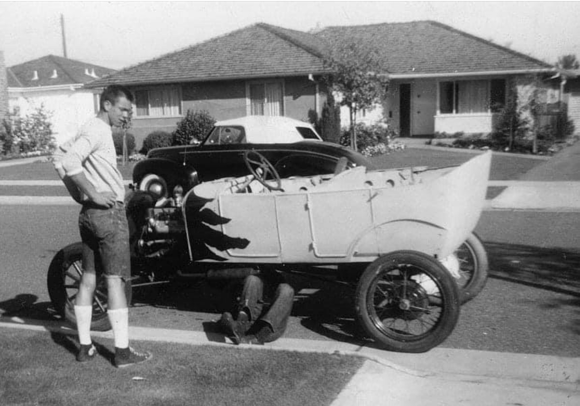

    Front wheels look like stock T wood wheels, rear wheels and rear may be stock Model T from 1926-27. Bob

    The fronts wheels are typical 21” wood spoke wheels, standard equipment on ‘26 open cars. Rear wheels are T wires

    Thanks guys, I wondered if they may be wooden spoked wheels, not a common choice now but I'm sure it was more likely back in the period
