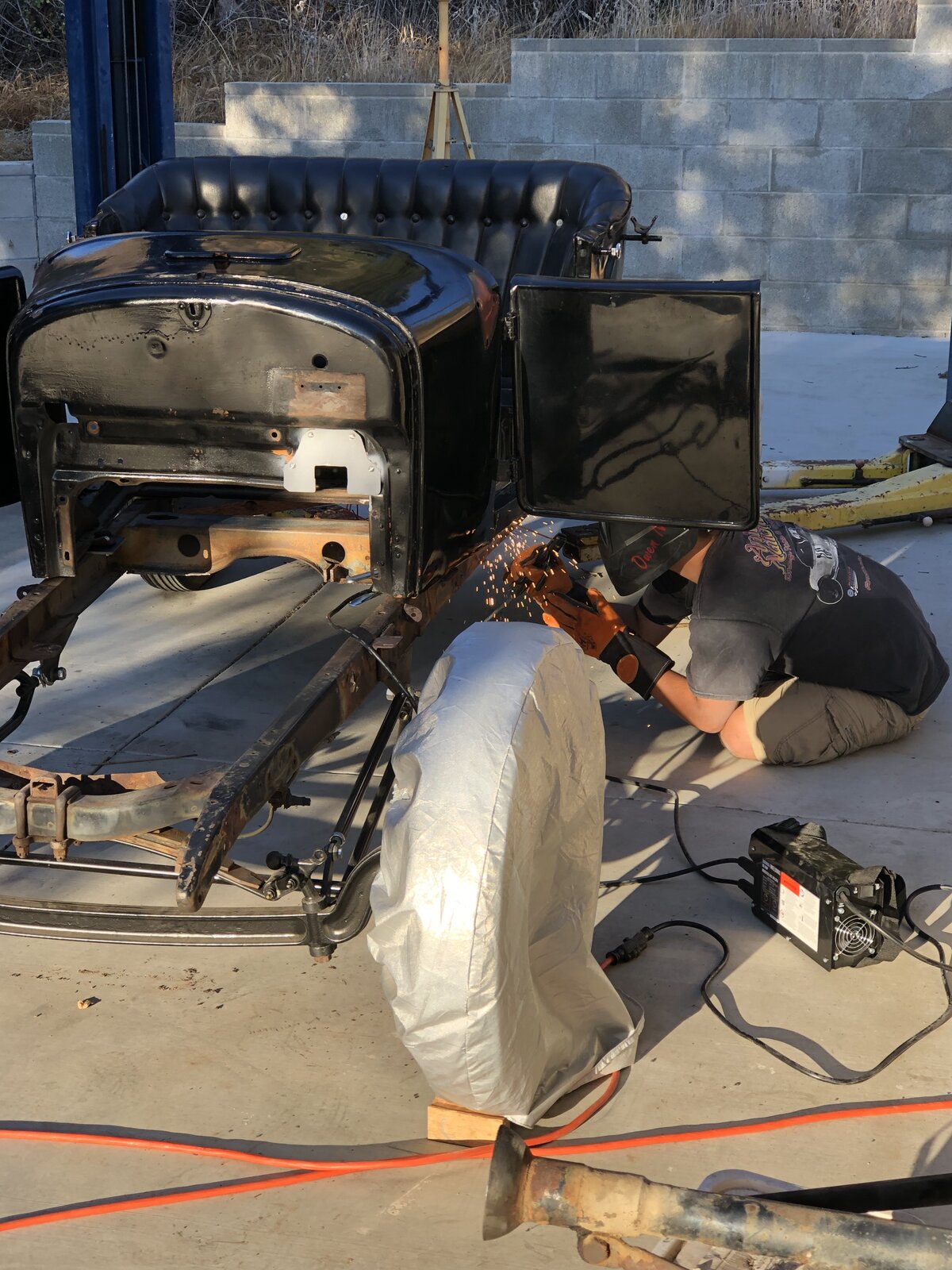

  20. 6ABD95F7-AE56-44A0-9956-5F548C4C4071.jpeg 6A64DDAC-B6F3-4994-B961-59D485C6D650.jpeg Been hella day
    Started with course prep at ElMirage for next weekend
    Then Son Owen putting body mounts on chassis

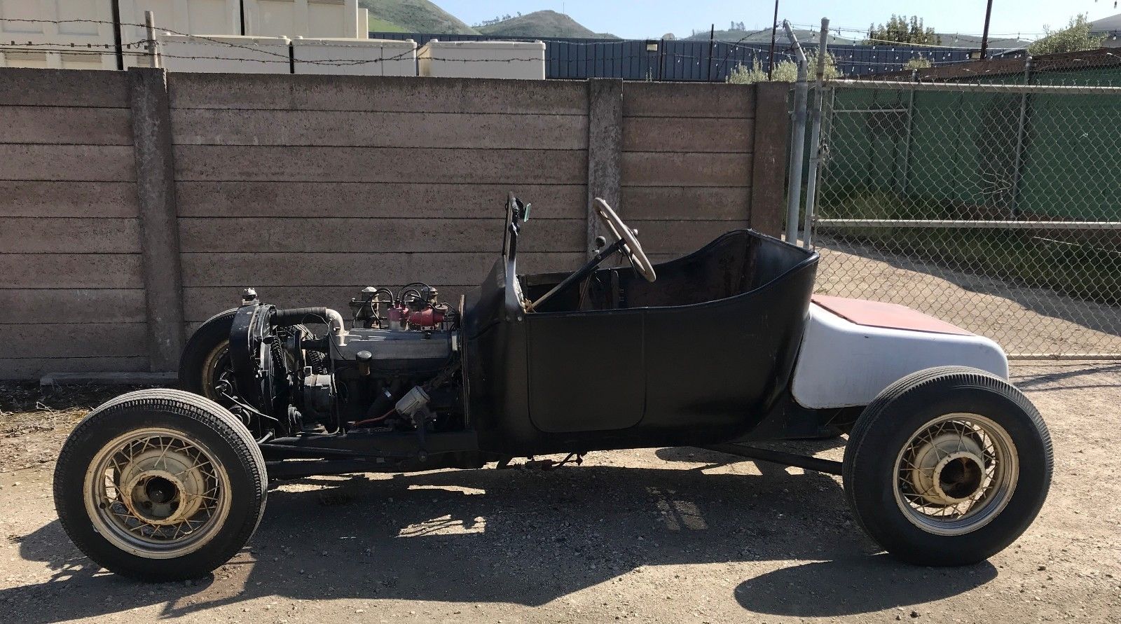

    Hey Retson:
    Does this car look familiar? It came to me from your neighborhood

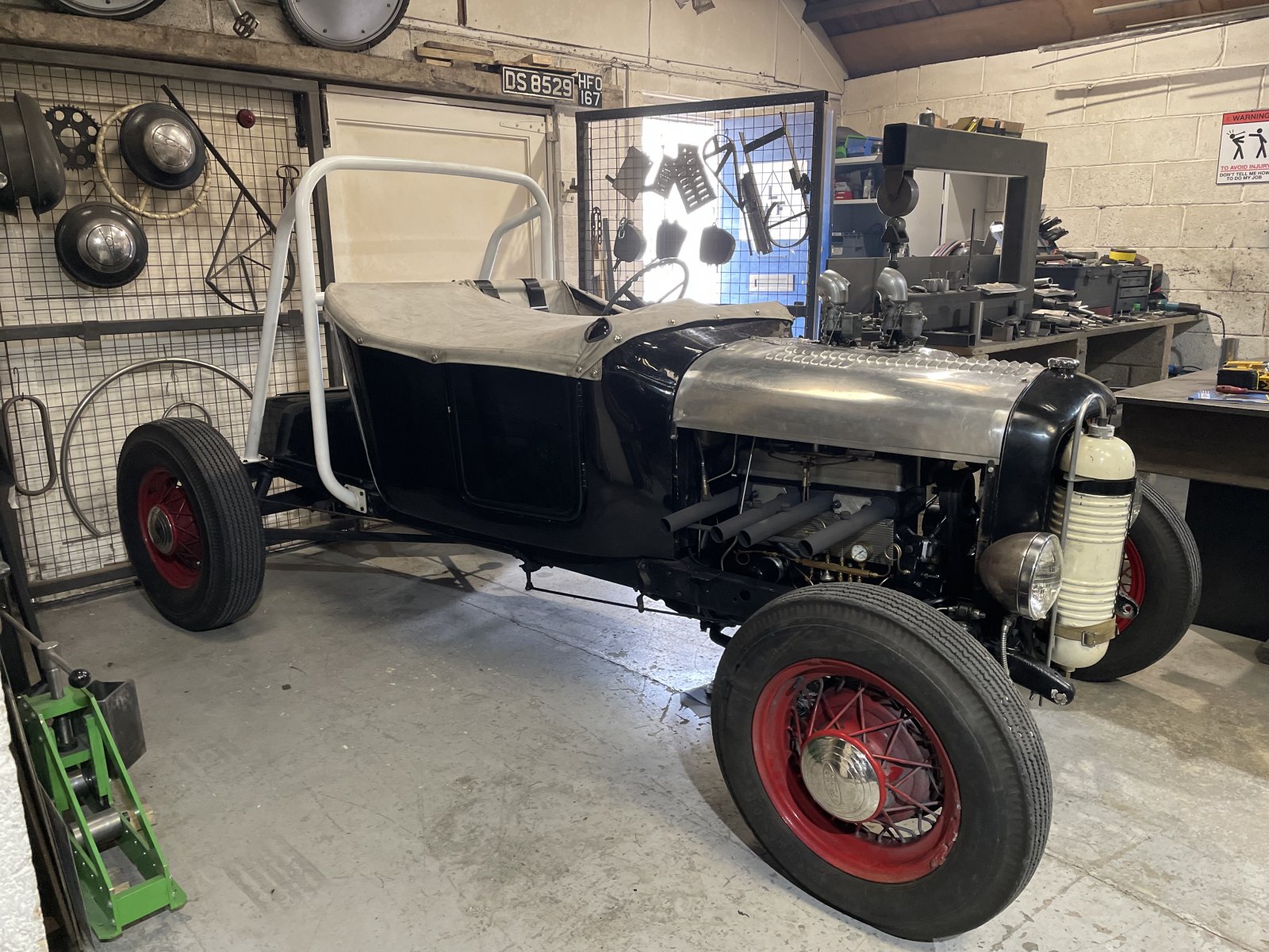

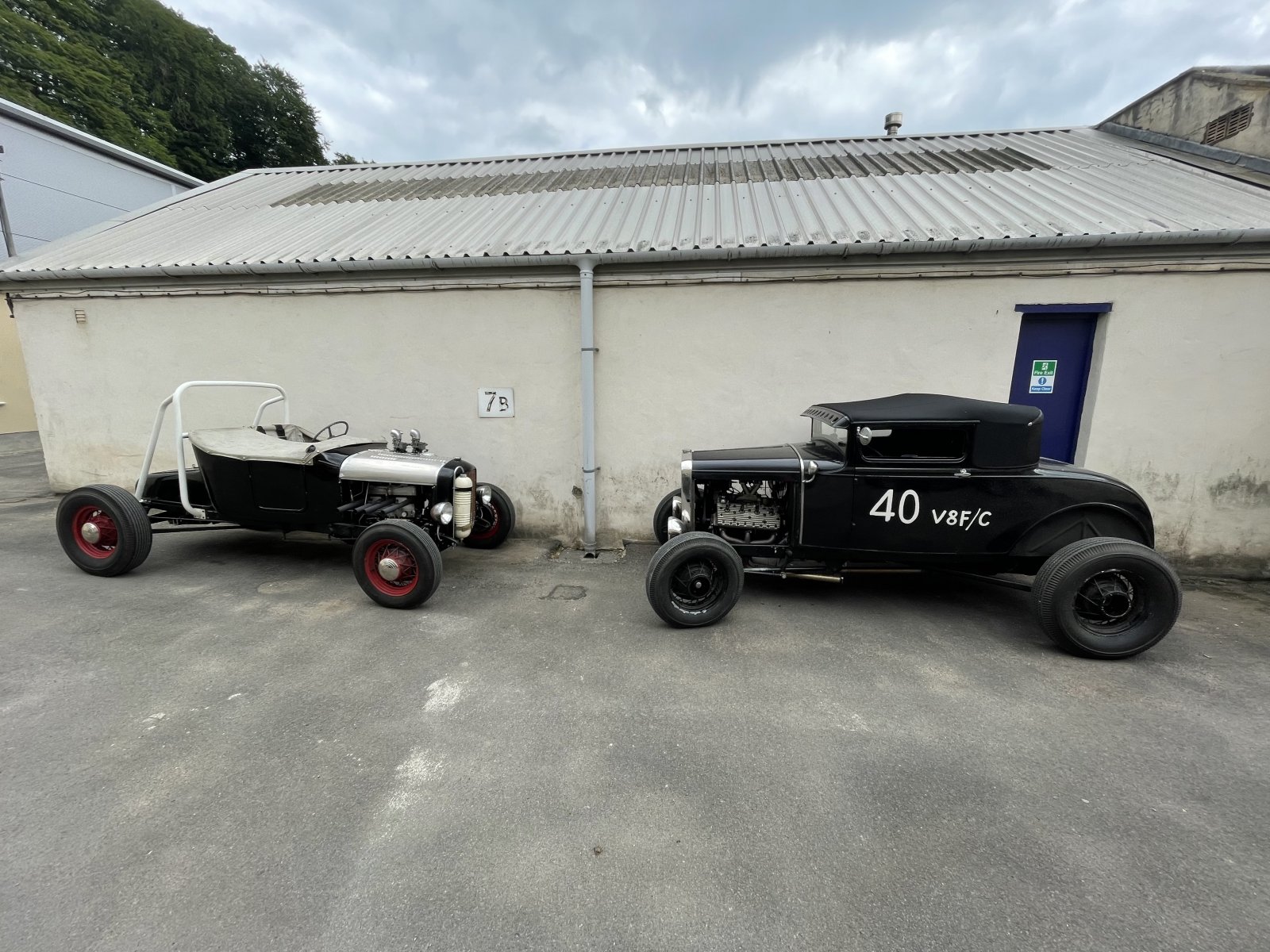

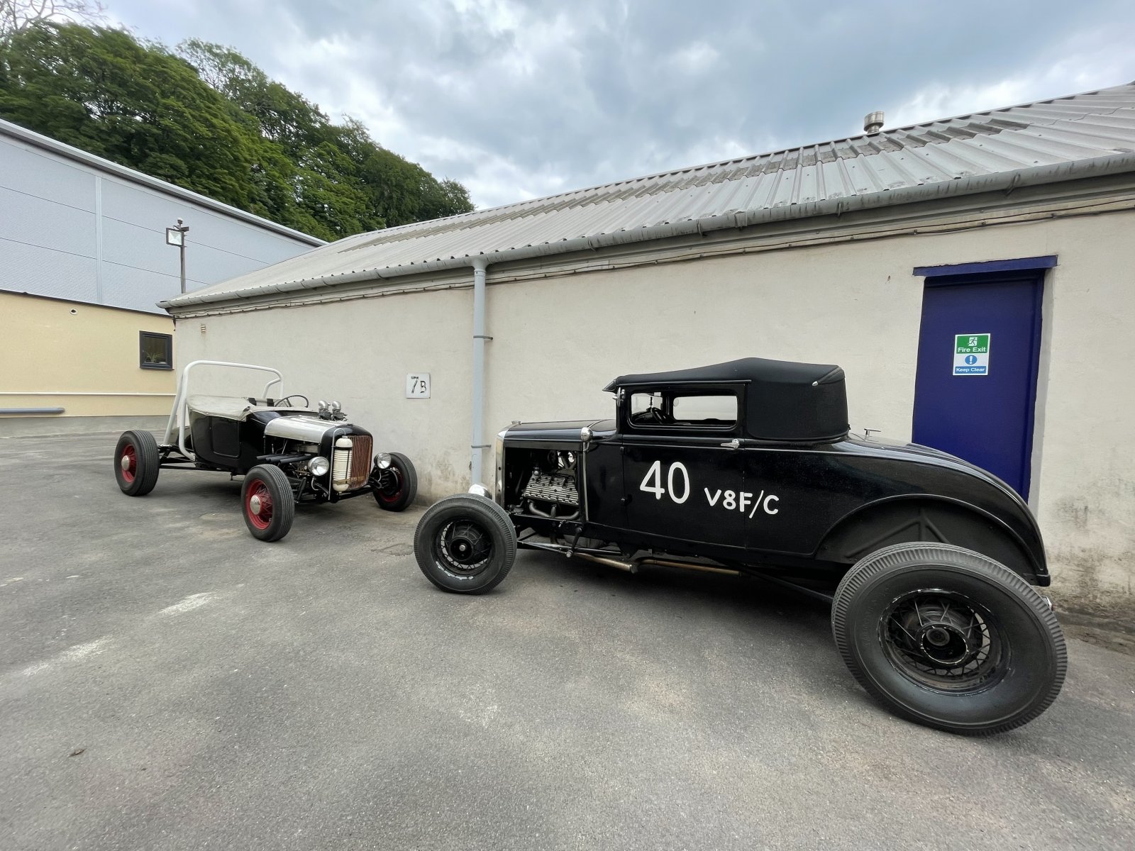

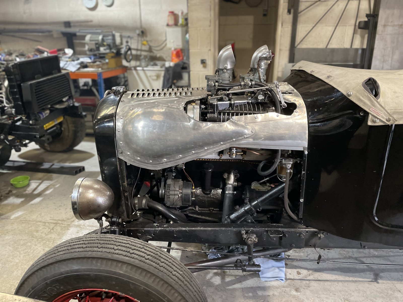

    Well, the car is finally all together and running well with just a few days left till Pendine Sands.
    I’ve had to change the exhaust to four shorties as the four into one lake style headers were glowing red at around 3000rpm. Cam overlap and waisted spark ignition means flames were heating the exhaust too much.
    It’s fun on the road though. Spinning the rears in all three gears, but the rod brakes suck. Need to spend more time than I have at present going through them.
    707EDBD9-B0AE-4C7C-ABF6-27526BA426B8.jpeg 2EF8AFA2-0537-42B3-A8AD-C293A9483F34.jpeg 467F5DD9-84A8-4C41-BD1E-1F90476EBFCA.jpeg E465A3B7-DD67-4660-B3F2-416965051797.jpeg E2958007-6354-4B5D-97D8-19D5A922BD88.jpeg 59C257F8-A17A-452F-8A39-61F04B6E6B75.jpeg E57BBCD4-17A4-4FDC-B293-75501A32E9E9.jpeg 15DF4B9C-34DB-40A8-8B5B-456240B39601.jpeg 26AC2235-F431-4A67-8B7C-A191B3BBDEDD.jpeg

  30. I don’t reckon I’ve seen that car before. Where is he from?
