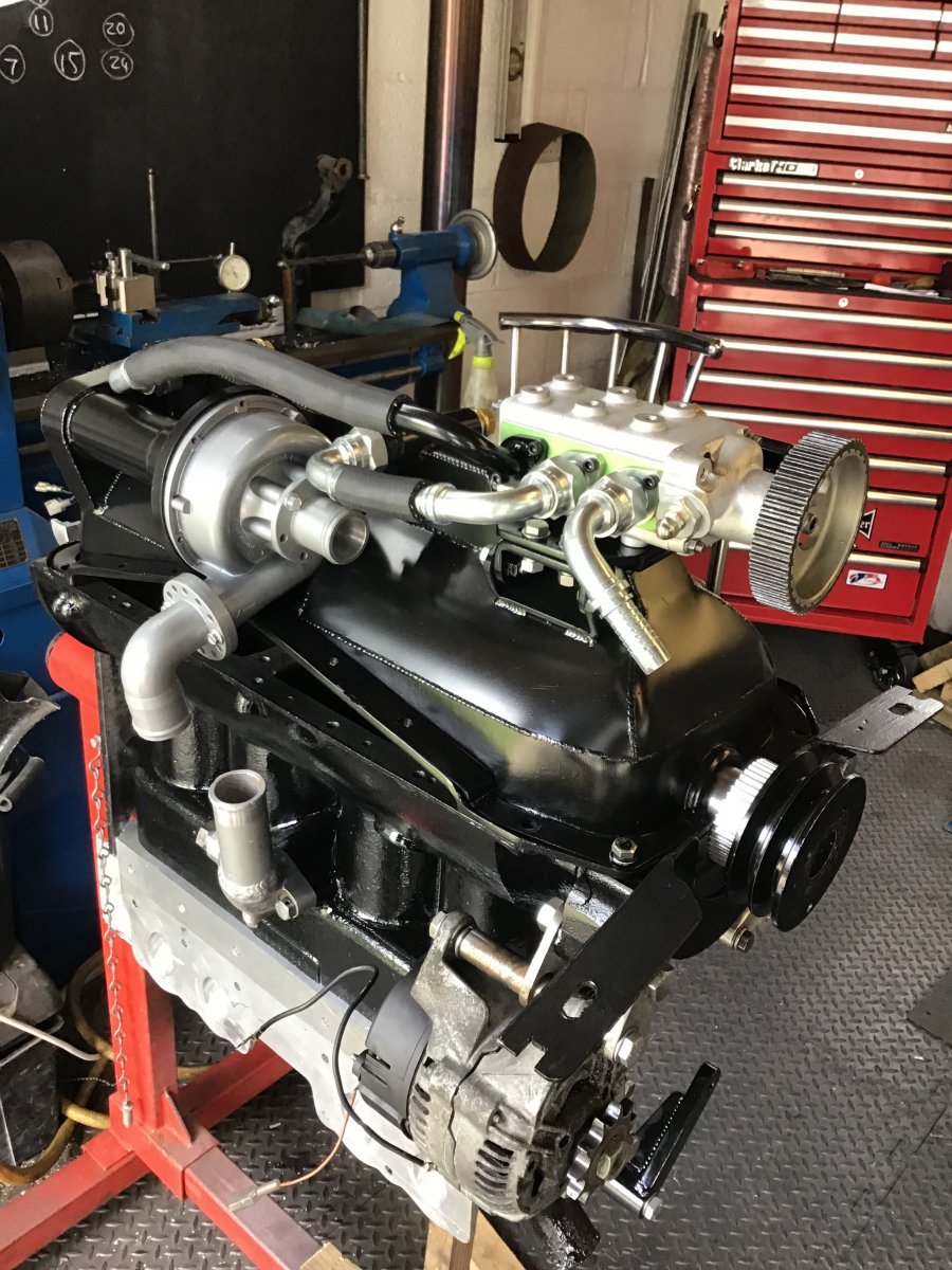

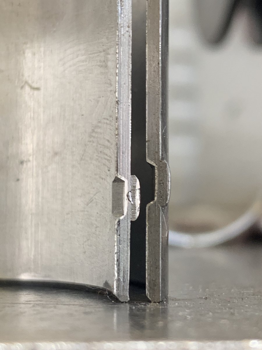

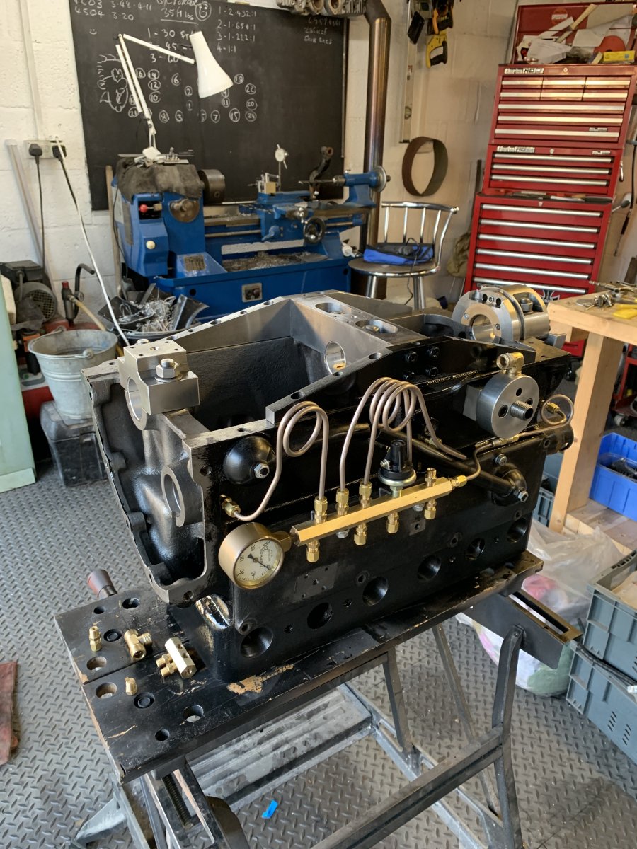

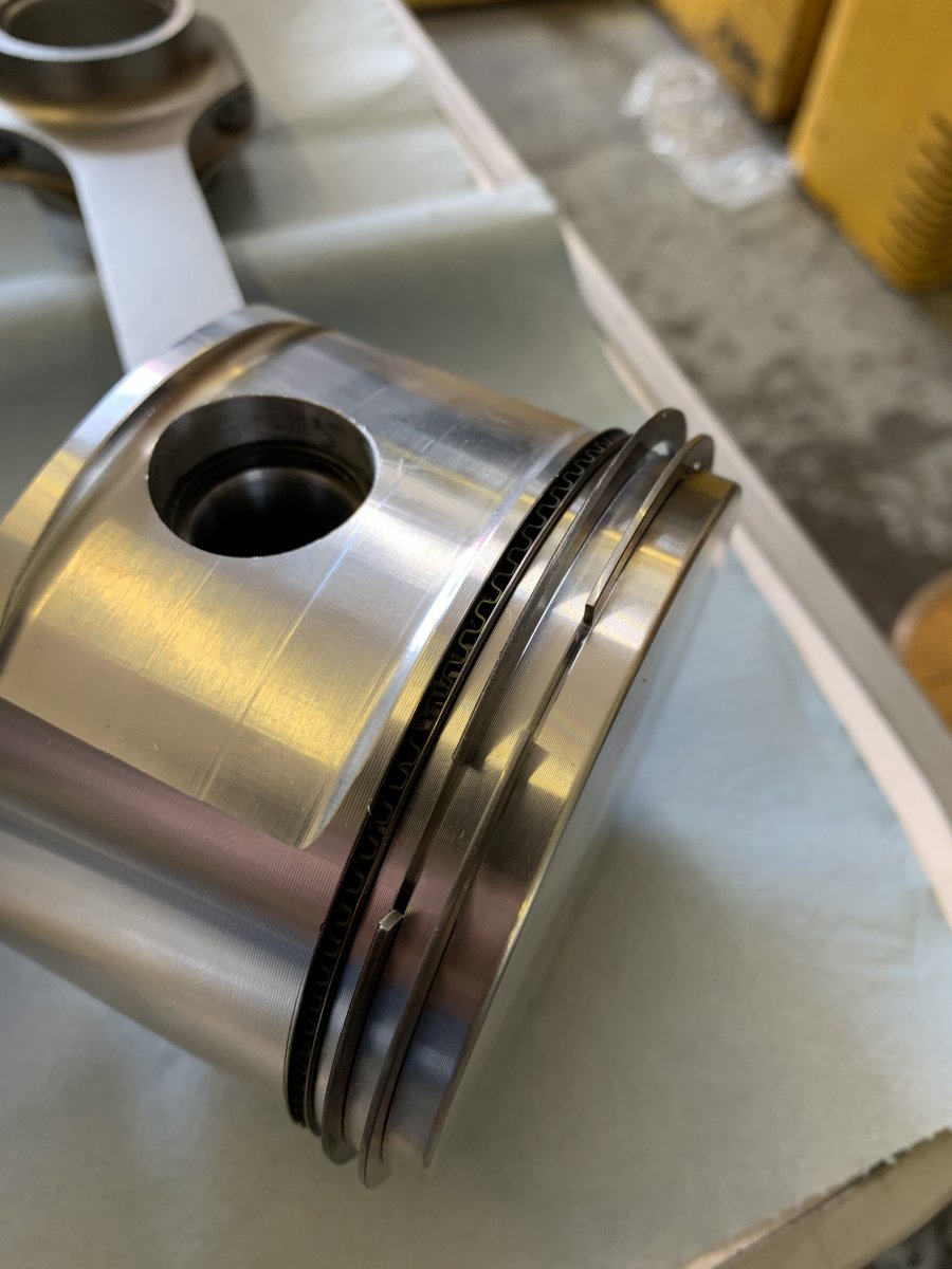

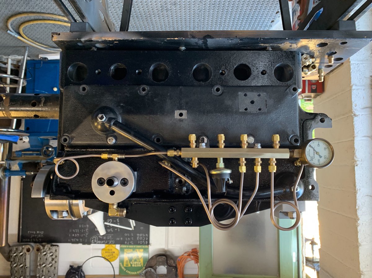

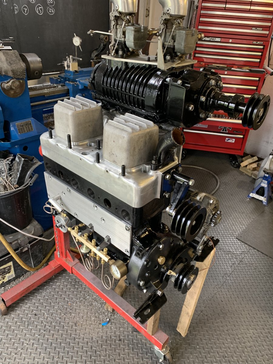

    I finally got mine running. Sounded great till a big end shell picked. Stripped it down and found a tang position problem with the bearings allowing the bearing to run up the radius on the journal.
    Thinking that was the problem, the motor was fully stripped, cleaned and reassembled. Fitted and run up only to pick up the same big end.
    Got the motor apart again and looking for the cause.
    B3B4C64A-CB76-47F7-85D8-5316DBEAF963.jpeg 7ED56AC1-95AE-4064-9791-81116473E1BD.jpeg FE0115B6-D7D4-4048-80CE-75548C5DD9AD.jpeg 838239E8-F3AE-4FCD-B40F-74B55F4261C6.jpeg 8B9E1DC8-8365-43F3-896E-36736057F221.jpeg 59FCA092-E431-44B9-BADC-F624621FD6AD.jpeg D7C3A2C1-D100-4693-8EAB-4C897A6A5E99.jpeg B59CD78A-1F6C-4389-9D9F-5BA88315796C.jpeg 480D5769-E9F0-49B3-A5B0-EC2B77938EDC.jpeg F7A410B2-F9B6-4D1B-8FF1-14E7AD6F1093.jpeg 83E4BE9E-F36D-428C-AC1A-731425214993.jpeg CDF43E23-7215-4084-A8E4-A456AC6DA31C.jpeg 6D262A2A-18C1-438F-B1B5-1BF59BE8C4CE.jpeg 6CF4CAAE-753D-43A2-B1DD-44C410B5622C.jpeg DF5B3CAB-0440-46FE-985D-BB3F36B32DD3.jpeg 7EFBC2B7-86FD-4000-A7A2-B3FA49660FA2.jpeg E445A71D-6E75-41A2-9A8D-7A66E54F03A8.jpeg 156AC9E2-EFBD-4627-8F35-1CA0926354F5.jpeg 754B2573-E620-4D3A-9D3F-E87816BB7CB9.jpeg 8F670879-F5AC-446D-AEF6-C88CB1111F85.jpeg CC8F7EA8-28C3-46A7-85F2-AD02F3544B6F.jpeg 6D31D43E-01AE-4D96-95A7-93CD25EF55D2.jpeg

  4. I'm worried about a basic electronic ignition and a downdraft carburetor. Then I see Nutrocker post. It's like a glimpse into a mad scientist's lab. Incredible! Any videos of that setup running?

  5. Still dancing the hokey cokey with that engine Pete?

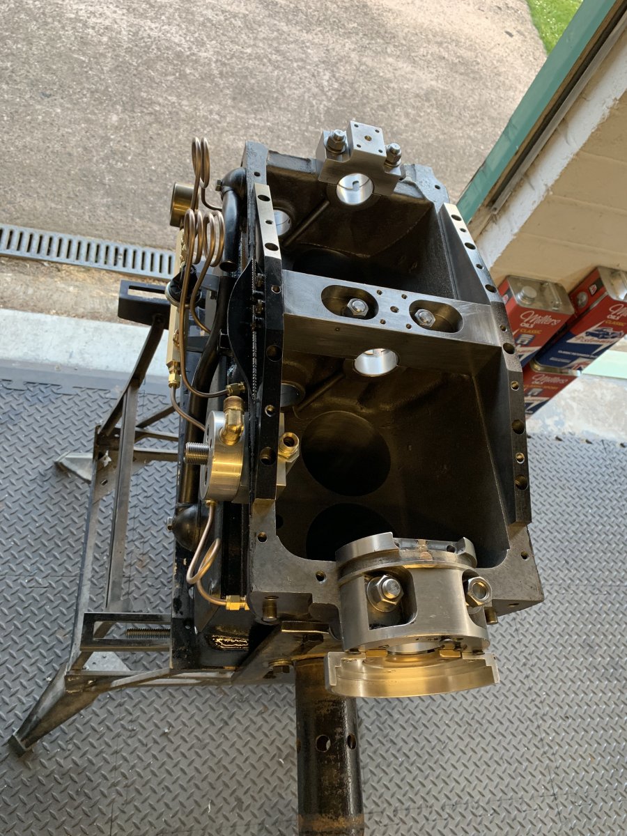

  6. nutrocker
    Joined: Jan 12, 2007
    Posts: 378
    nutrocker
    Yeah, sort of. I keep going back to it and trying something different but still don’t seem to be getting enough oil at the big ends. Plenty of oil through the crank, but as soon as I fit the bearings the flow seems to dry up. Checked all the clearances and they’re all fine.
    I’ll get there.

    @nutrocker that is absolutely insane. And I love it ! Haha

    It sounds like you are starving the rods for oil? The pics of the crank don't show the cross drilled holes, but I have to believe they are there. Matching up the shells with grooves to the feed holes will help. As a rule of thumb, the oil passage to feed a single main and rod is min 1/4", to feed two rods 5/16". How much pressure are you pushing?

  10. nutrocker
    Posts: 378
    nutrocker
    Yes, crank is cross drilled. I have good feed to all mains and big ends, until I bolt big end caps on then it dries up. The mains are set at .0025” and big ends at .0015” clearance. The oil feed holes to all the mains is no smaller than 5/16” until it gets to the groove in the mains. The drilling in the crank is 3/16”.
    I can run any pressure I want from 20psi to over 200psi. It’s a race dry sump pump and I’d set the idle speed to 40psi and a max of 60psi. It had a very high flow if needed too.
    At the moment I’m working on modifying the big end shells by adding a groove and/or a X to allow better oil transfer from the oil feed hole in the journal around the bearing. Currently there’s nothing in the bearings.
    Pete.

  11. johnneilson
    Joined: Apr 12, 2011
    Posts: 1,244
    johnneilson
    Pete,
    OK, that makes sense, the rod journals are long in length and that will be an issue.
    making a small groove in the bearing where the oil feed hole is will cure the issue. (360 degrees around)
    I don't run that style rod/bearing combination, using Chev V8 style, 2.0 dia and .860 long.
    John
    nutrocker, Old Dawg and Dannerr like this.

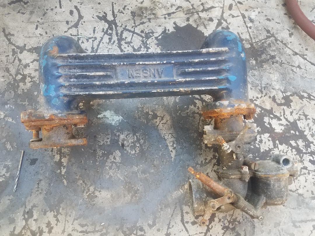

    Spied this my little eye when I was buying the winfield head..half buried in a box of junk,looks like it spent a few years in a mud puddle. Got it at the 'new bro' price after ponying up for the head. The two bolt adapters are cast iron aftermarket ones (edit,homemade but nice work) I can port some to fit a pair of webers I got..tried running them with individual manifolds but no bueno..need a plenum.. thumbnail (38).jpg

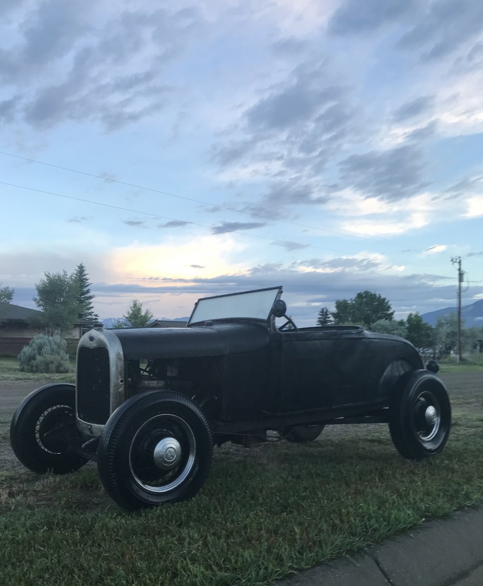

    Checking in-hope you guys all had a good 4th! I've managed to drive my roadster 30 out of the last 36 days, logged a little over 700 miles. Only got drowned once! A couple very pleasant 100+mile Sunday morning trips up near Yellowstone and surrounding areas. I live at 5500' and everything goes up from here. 43/42 mains/ 71 PV's. A little rich still, but livable especially with the 8:1 head. One thing with the dual carbs-97's or 94's- good mileage! low-mid 20mpg. Rethinking my rear shock/suspension setup. Tspring with 2 leafs removed (they were cracked anyway) it rides really nice but if I hit a frost heave or something it compresses, then Springs! up, totally overpowering the shocks. Not cool in a corner. I've got a good pair of 36's I'll try. They're way stiffer. I'll report back.

  16. joe1932
    Joined: Dec 23, 2013
    Posts: 90
    joe1932
    from ny
    Jet96 Add some pics of your car or road trips. Thanks Joe

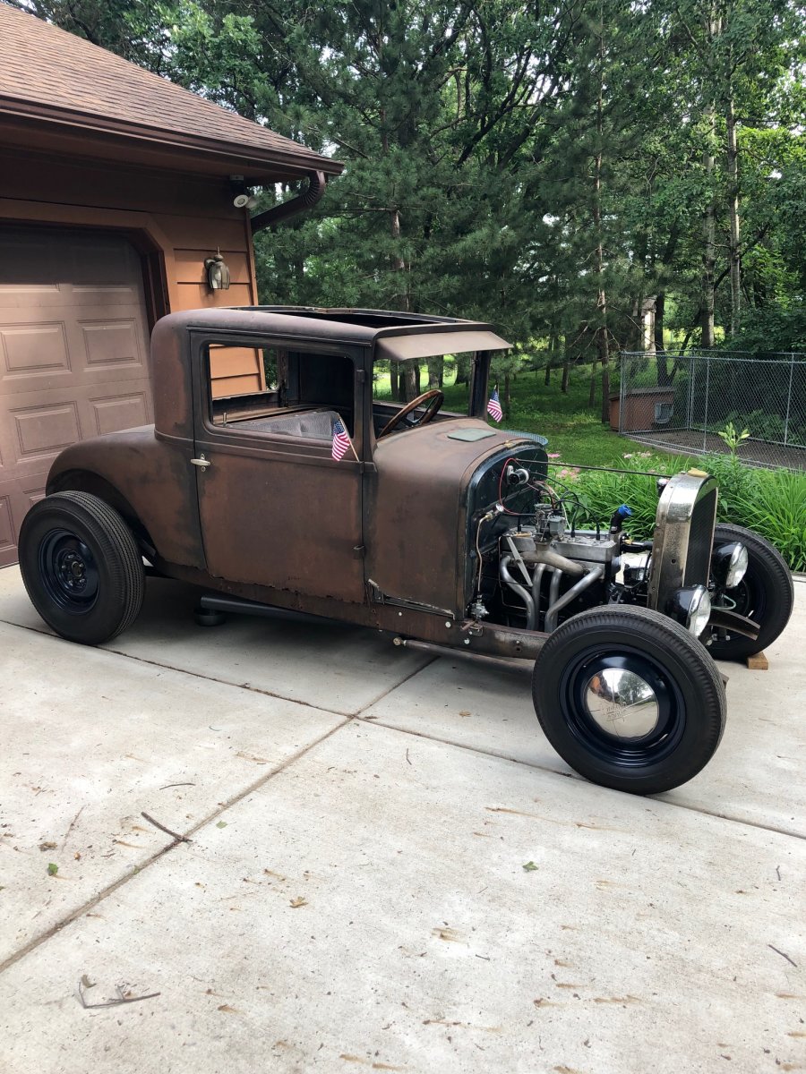

  19. burl
    Joined: Nov 28, 2007
    Posts: 715
    burl
    from Minnesota
    checking in for the month its already july.Got this beater fired up and holding water.Just need to finish rear brakes and get my windshield glass in to take it for a spin. 4th.jpg

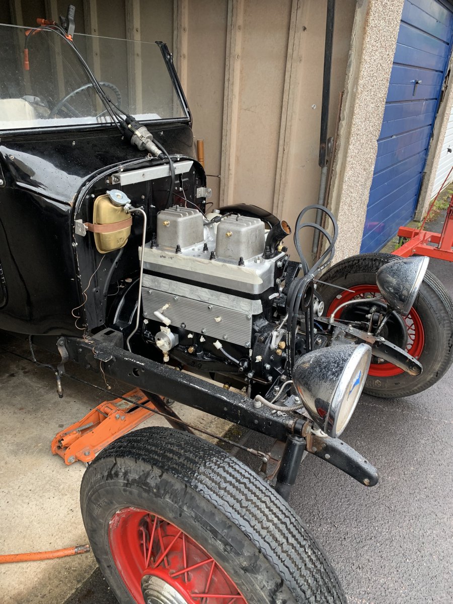

  23. @nutrocker
    That is one insane (in a good way) banger!!!!
    Did you machine those pushrod guides filling the old valve seats?
    Did you cut out the old seats or taper the plugs?
    Are the flush with deck or +/-?
    I need to do that to fit up my Alexander head.
    Thanks!
  24. 40 Olds
    Joined: Jul 2, 2008
    Posts: 55
    40 Olds
    Hi hotrodA
    You can get those from Secrets of Speed
    Valve Plugs (sold each)
    $16.95 IN STOCK
    Fit Model A & B Ford with "F" head OHV conversions.
    Special CNC'd aluminum Plugs fit into the (unused) intake valve seat on OHV "F" head conversions.
    They are non-mechanical.
    Used to support the head gasket and channel OHV oil return to the crankcase.
    The large OD is sized for a press fit into a hole machined in for a hardened ring seat. The large OD can be turned down to fit a stock valve seat.
    Best to install first and then deck the block. Plug should be flush with or a hair below the deck surface.
    The small OD is pre-sized to press into the empty valve guide hole.
    This part is included with all our OHV kits.
    secretsofspeed.com
