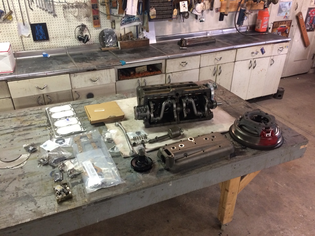

    Got my engine today. Counterbalanced and inserted, Stipe cam, 6:1 Snyder’s Head, cut down flywheel with V-8 clutch. I am excited to see How this makes the ol coupe run along.
    On another note anybody have any suggestions about repairing these cracks in a cast iron head?

    Is it just the two vertical cracks around the stud hole at the water neck ?
    If so, I would braze them . ( oxyacetylene) Use a high quality flux matched to brazing rods recommended by your supplier.
    Find and drill the end of the cracks, to stop them going any further. Grind the crack to a u shaped groove on the outside and the top so that it is not just a hairline crack, not too deep though , make sure repair area is completely clean. Pre heat the head in an oven , temperature isn't critical (not to hot) but it needs to stay warm enough so that the brass will flow without freezing while you do the job. Brass melts around 875C so the head will only need to be heated to about 900-925 ,way less than welding and way less chance of cracking as it cools. These cracks are only small so pre heat and cooling shouldn't be a big issue.
    You may want to drill the crack from the top down the inside edge of the stud hole as well and carefully braze the inside . It depends on how far the brass flows from the outside.
    Once it is all cooled, clean it up with sharp fine files... and paint it red!!:cool:
    I wouldn't use a drill through the hole , just a round file...a drill might catch on a lump of braze and break the side back out.
    You could of course just find another head and send that damaged one to me!!;)

    Thanks for the advice. My initial thought was braze also. Those are the only cracks I can see. I think I need To find someone with more experience with brazing than I have to help. I also need to relief cut the bottom to clear piston pop up. I will get the engine put together and in the car and can swap heads later.

    Binger, is that from Bert's? Pulled the engine from the roadster yesterday and taking it to Bert's Tuesday.

    Yes it is from Burt’s. I have been in the waiting list since late April. They are super busy and good rebuildable cores are getting harder to find is what Dan was saying. He says he gets 1 in 10 that he can use. I was glad I had 1 out of the 5 I took him.

    Another method is to knock out the cracked section and using the remaining bolt hole as a base fill the area in with nickle rod,then re drill. Its critical that mating surface is dead nuts flat and the neck is flat as well,I use no gasket,just a bit of silicone when assembling.
