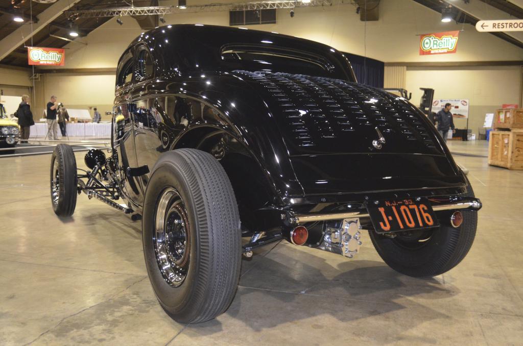

  17. 117harv
    Joined: Nov 12, 2009
    Posts: 6,594
    117harv
    I am a conservative guy, I do what I do because I enjoy it, and dont seek the limelight. Since my work has been mentioned here, I thought I would post a couple pics of some of my work that went on another HAMBers ride. The front bones were done by me, they were chromed after he recieved them, some may recognize the car.
    You can see in my threads I am very picky about my work, I have done work for several members with no complaints.
