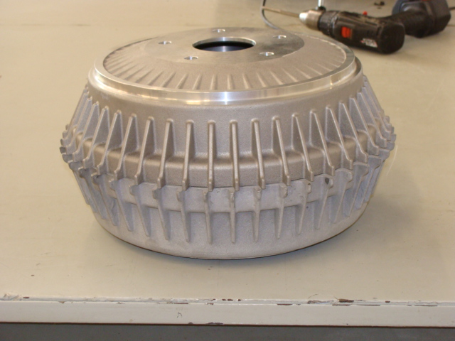

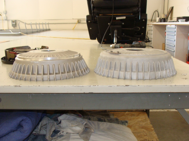

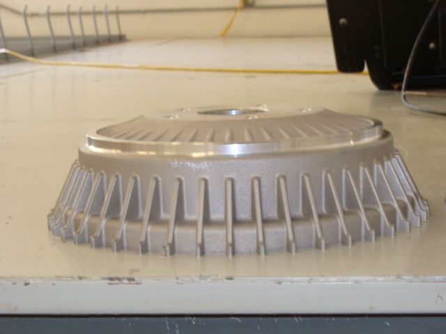

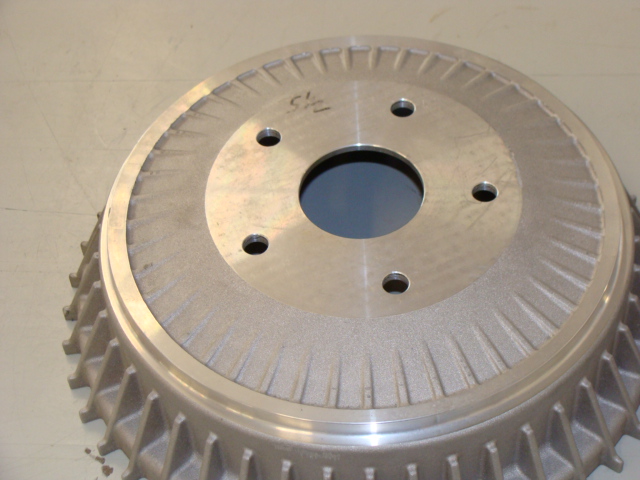

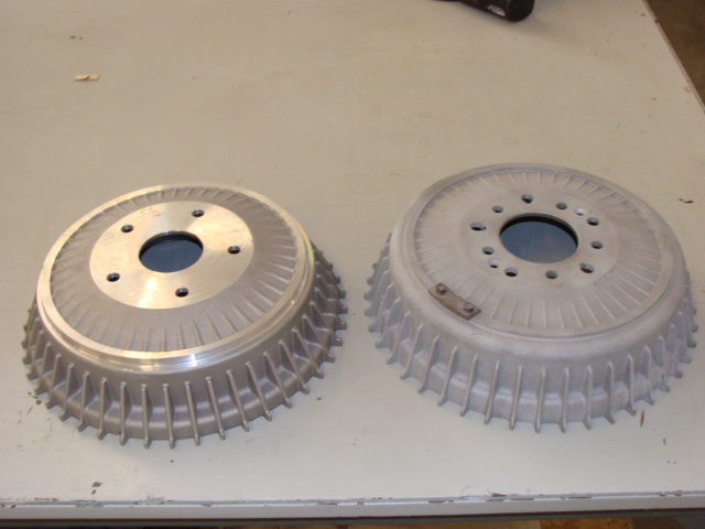

    I could not find a thread that showed any picture of these and the other thread had alot of questions about them.
    I recently purchased a set and took pictures to compare them to the original ones.

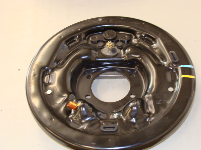

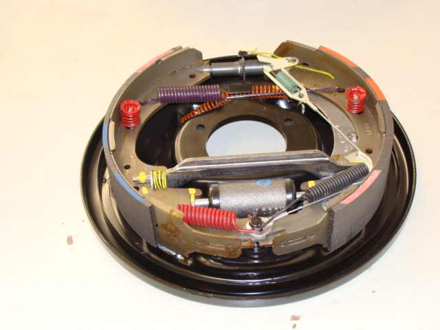

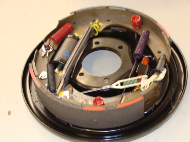

    If anyone wants a better picuture or measurement of part of this let me know. The pair cost $995.00. the brake backing plate assembly apears to be a new ford part.

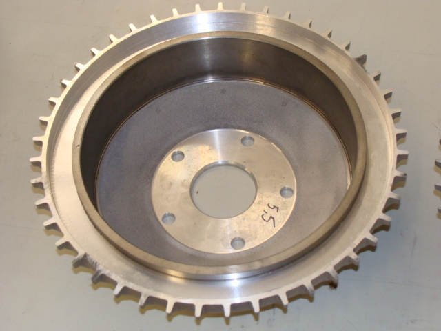

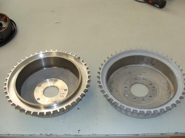

    here are some more pictures

    Is that $995 for the drums only or for the drums and brake assemblies. If that includes everything that is a good deal IMO. They probably have some money in R and D and it must be tough to make these because Bob Wilson has been trying for years and still doesn't have them available.
    The ones you picture look really good. The brake assemblies look like rear units due to the self adjusters on there.

    Sooo, its base on a 11" drum? Can the drums be bought seperatly? Wonder if they would fit on the f1 48-52 front brakes. Please do tell all.

    Rear backing plates. What are you putting them on?
    They do look nice.

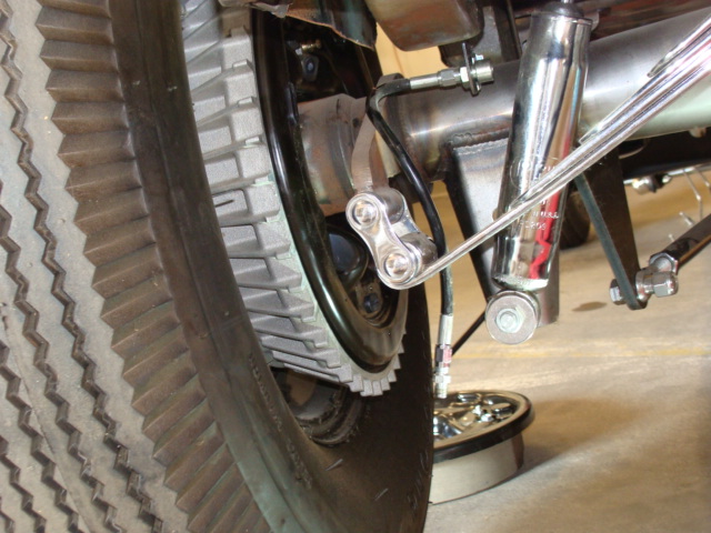

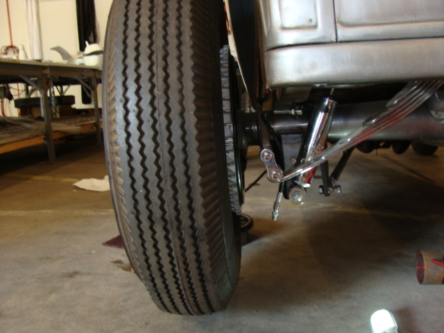

    The price is $995.00 for the drums and brake assemblies complete.
    here are some pics of it mounted on my model A.
    I am not shure if you can buy the drums only. they will put in whatever bolt pattern you need for the drums.

    Yes PLEASE...more info, especially since these are 11" drums-NOT replacements for ORIGINAL 12" Buicks. Also, WHERE available? DD

    Ahhh...I see that now. Pretty clever setup.

    Ah, so these aren't intended to be used on the front ? Can you add hubs, remove the self adjusters, and run them on the front, or is the bolt pattern on the backing plate wrong for early Ford spindles ?

    Ok I'm a needn to be skooled on this, they look nice but, These backing plates are just Late model Ford brakes for a 9", why cant you just take a worn out Buick brake drum face the inside out to mate to the 11" drum face and use it as a drum cover and get the same results?
  21. I'd say it's worth it if it had old-style baking plates. Too bad they didn't do it based on '40 Ford or Lincoln Bendix plates.
  22. What axle is that? Website says big bearing Ford 9" only.

    If you look at pic #6, Ther drum does not appear to have a large enough flat for a 9" axle flange to fit in???The Buick drum does not have a big enough wheel mounting surface for a 5.5 dia BC wheel. The 46-48 hubs fixs this as they hang over where the Buick tapers in.

    My axel is a new winters V8 quick change with the late outer big bearing setup, they can set this up for just about any axel or bolt pattern.
