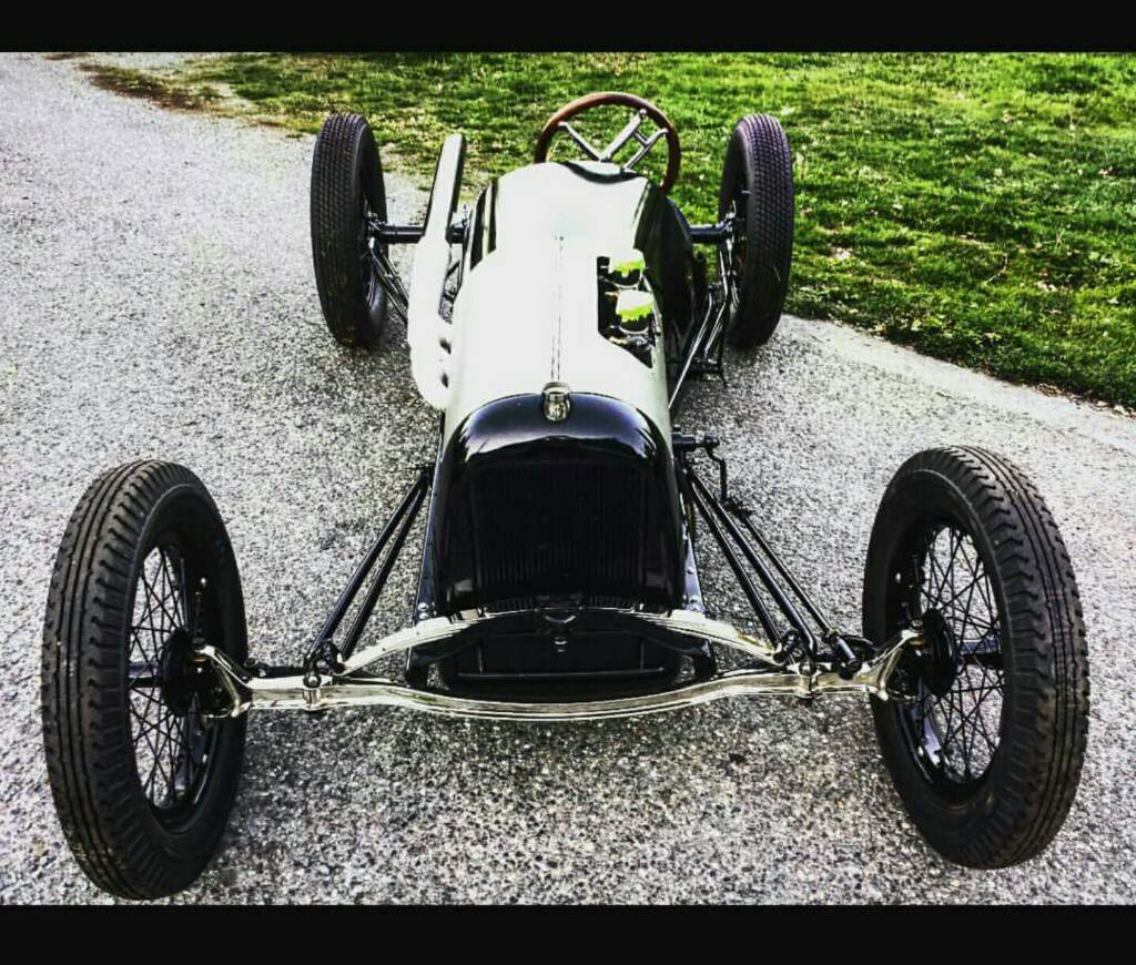

    Here is a copy of John Gerber's 1920s sprint car.... the Whippet Special that I built.
    Model T engine with an SR Fronty OHV conversion.
    Whippet grill she'll
    Modified T frame
    87" wheel base
    21" Hayes fronts
    20" Buffalo Rears
    Chevrolet 490 front axle
    Small drum Ruckstel
    For more build pics you can check them out on my instagram @santiagormichael

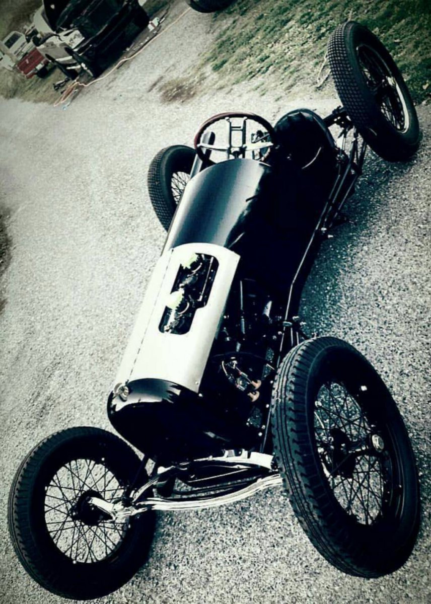

    Here is the original Whippet Special

    that looks like a FIRST class job! thanx for posting, any more images/details?

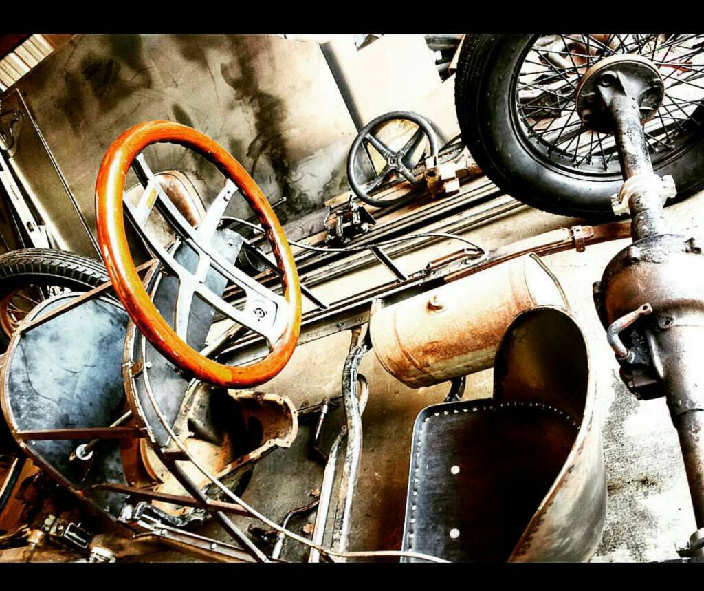

    Here's a few more build pics....

    Fat man steering wheel

    WOW! That looks great! Is the offset something Gerber had in his car or artistic licence on your part? I'm slowly putting a Bobtail together based on the RAJO Jack and Noel Bullock cars. Sonething about those Bobtails that just looks so right. Bob

    That's the way Gerber did it, I tried to build the cars as close as I could based on pictures. The offset help with the weight distribution.
    Both the Rajo Jack car and Bullock cars are really cool cars!!

    It still has the stock transmission brake. we added an aftermarket brakes that slide over the rear drums. Similarly to rocket mountain brakes. This is hand operated brake only

    This pic your looking at has a 26-27 large drum ruckstel housing on it for mock up. We needed the ruckstel housing for building the seat and shifter clearance while the early small drum rear-end was getting rebuilt. Sorry for the confusion
