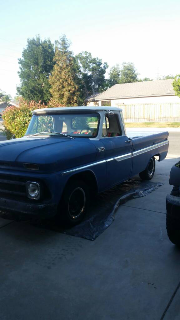

    Coming in as a newby to the board. Finally getting started on my old pick up. The plan is to convert the 3/4 ton running gear to some newer 1/2 ton and gain the ability to run over 50 mph. The truck has some body issues but was very complete. Came with a '71 350 on a old powerglide. The rear end is an old eaton with what appears to be 4.56 gears. I scored a complete front end and an 8.5" 10 bolt rear end on the cheap that included a few air ride parts. I also swapped the powerglide across to my brother for a 700r4 after the pull. Some pics of the deal along the way so far..
    As was when paid for..

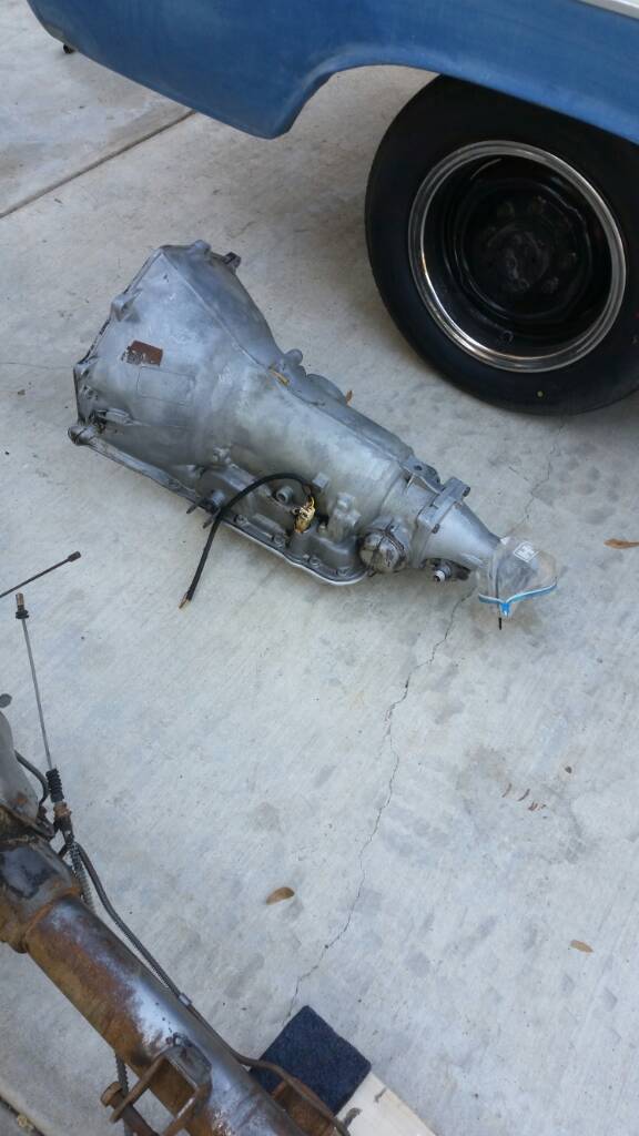

    I got a chance to inspect that plate and it looks like the motor mount is mismatched and wouldn't reach the chassis from the xmember. Looks like I'll have to replace the mount to delete the plate.

    Thanks. This is the front end I will disassemble and rebuild for use until I save enough for the PB dropmember. It has manual steering box but it will due for a while. I got a booster. Ill need a dual master but the proportioning valve is present. .[​IMG]

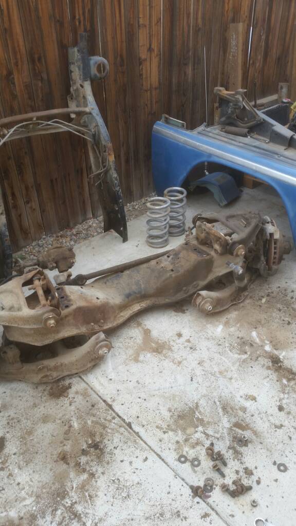

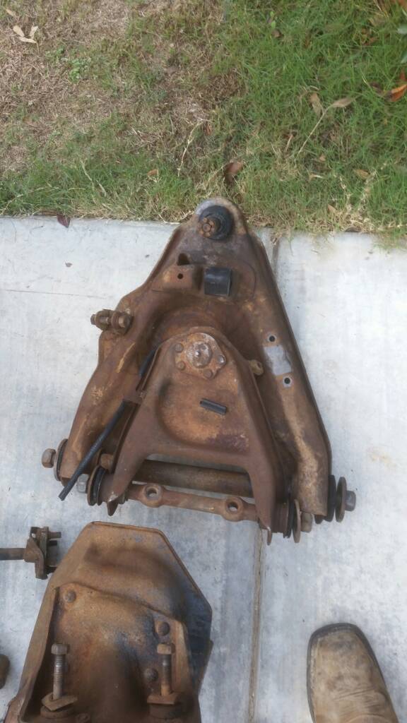

    Got back from the rig yesterday. Got back to the tear apart today. I had the spare c10 front end to get blown apart to rebuild as a temporary until the dropmember can be afforded. [​IMG]
    It was loaded with coils, so I built a compressor at work so that I could unload the spindles and control arms. The tool worked great.[​IMG]

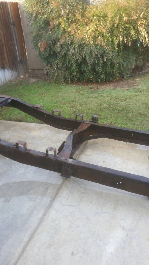

    I really needed to pull the bed to do the rear end swap and suspension work and I figured a day spent taking it off would save days of crawling under and struggling with space issues. I didn't plan on a frame off, but the more I look at the truck the more I want to do the stuff right and make sure it's clean. [​IMG]
    There's so much bad work below the surface. Rear coils welded to the trailing arms...[​IMG]

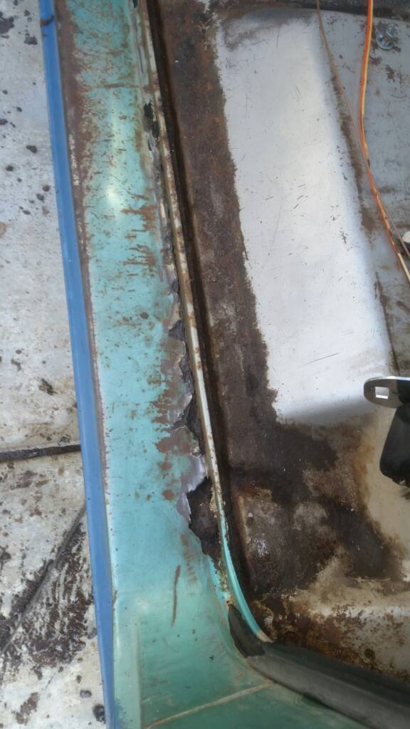

    Got the cab stripped of everything. It's way more roached out than I thought. It's going to need a fair amount of sheet metal work. I'm going to just bite the bullet and have it blasted and epoxy primed before starting it.[​IMG][​IMG][​IMG][​IMG][​IMG][​IMG]

    I did. The cowls look surprisingly clean inside. The rust came from the rocker weeps being clogged under the weather stripping and water collecting inside the front corners. On the driver side the water came from the firewall and holes where the tire spray was allowed to come in. I didn't include a pic of the driver rear corner with the nasty hole. They had a blowout up front passenger at one point that separated the pinch in the floor panel and the foot panel if that makes sense. It created a gap and all of the water coming off of that tire sprayed inside through that gap for what looks like years.

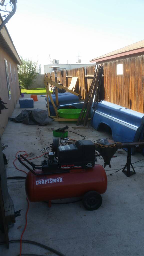

    Thanks. That was some work getting it all the way down single handed. I made really good use of the picker and engineered it into a cab hoist with a drilled hole, a 10" x 1/4" bolt and some lumber and ply wood. The impact wrench was also key.
