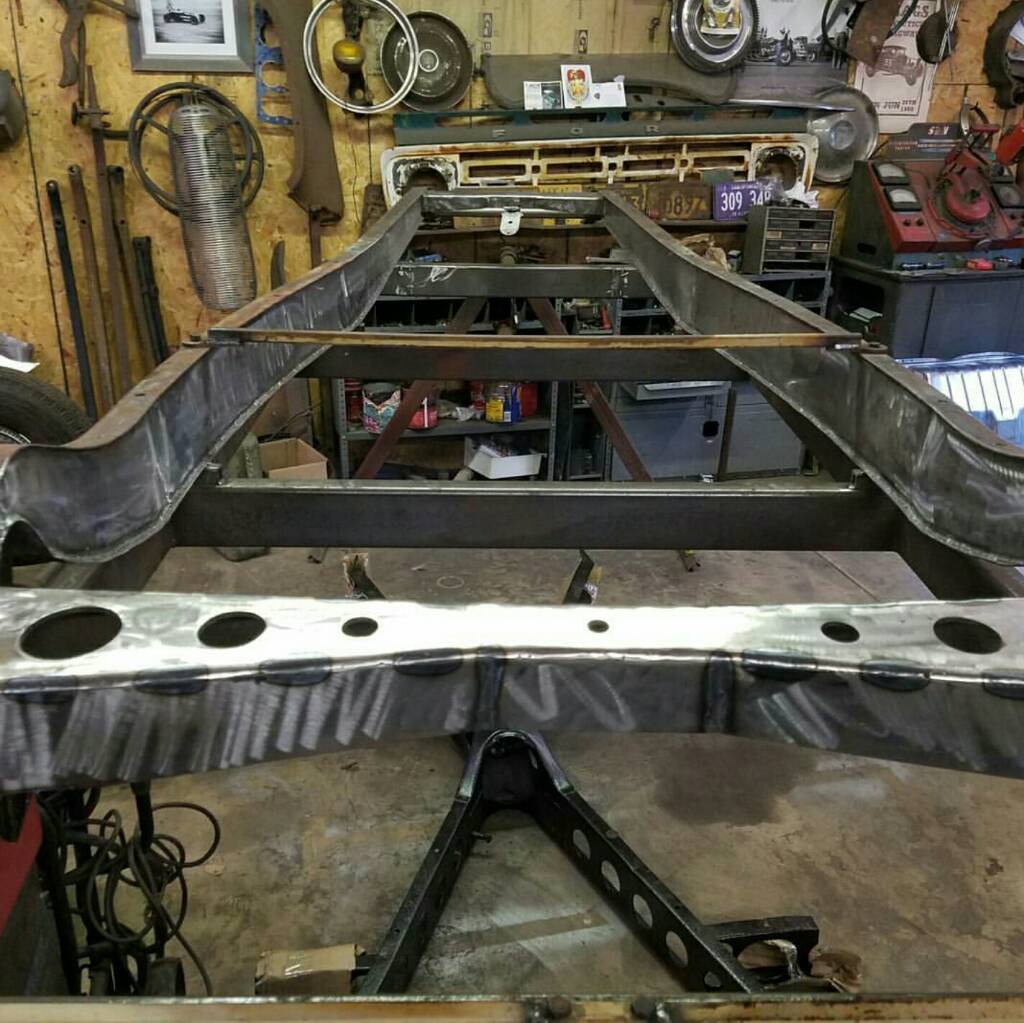

    All boxed up. Ready for the X member and engine/trans

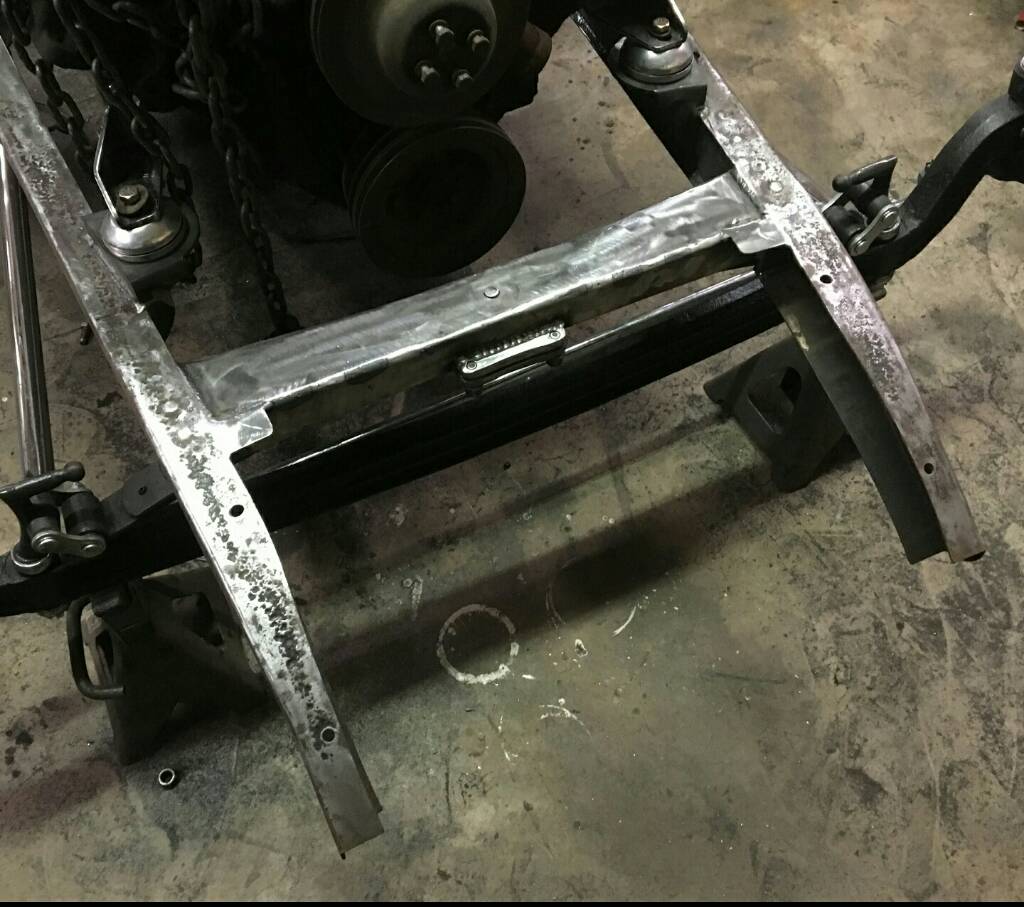

    Some more progress pics. Ready to put the x member in. Using one out of a 40 Ford. This will be slid forward and positioned in place to mount the 39 Trans.

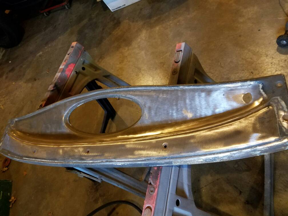

    Started on my dash today. Filling the stock hole......
    1480194410992.jpg [​IMG]
    Sent from my SAMSUNG-SM-G891A using The H.A.M.B. mobile app

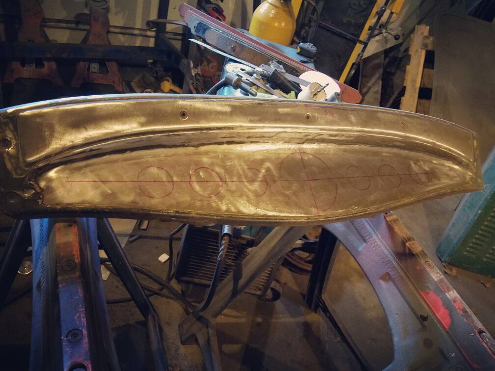

    HomemadeHardtop57
    Dash hole closed and fooling around with layout for gauges.
    ls1yj, enloe, AHotRod and 1 other person like this.

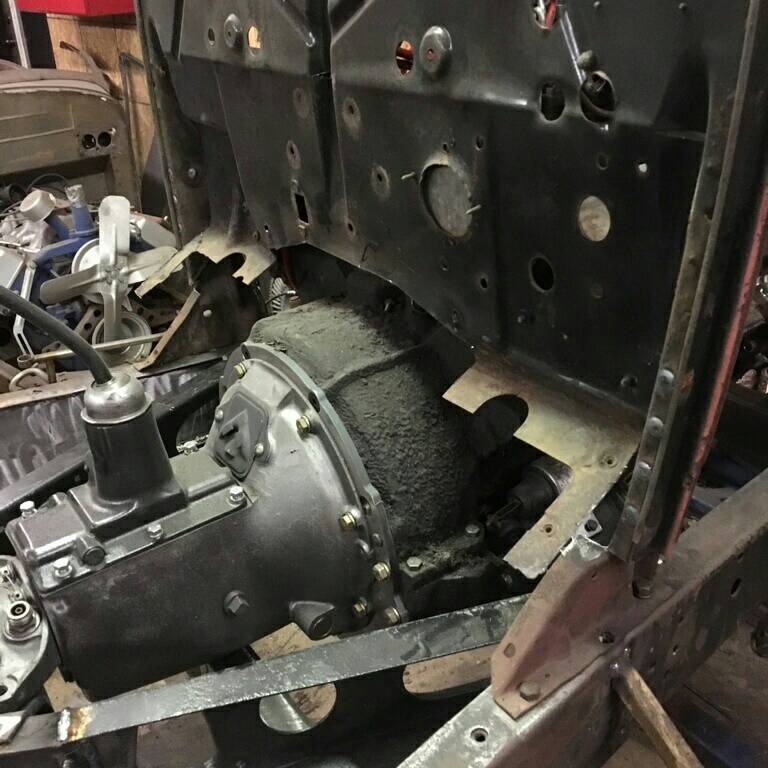

    HomemadeHardtop57

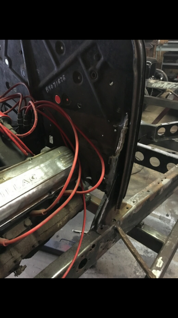

    Andy, who is helping me out with the chassis , came up with the slick idea of pie cutting the firewall on the sides along the bottom as well as the front of the feet. The firewall was then pulled back making room for the motor and keeping the trimming at the bottom at a minimum...with a stock looking top. It worked out great

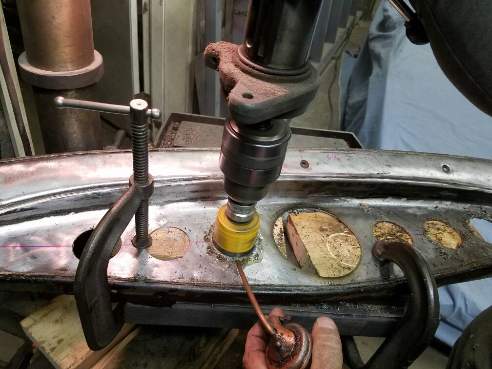

  20. HomemadeHardtop57
    Joined: Nov 15, 2007
    Posts: 4,199
    HomemadeHardtop57
    Thanks Koz for letting me use your hole saws and for the good shop hang. Nice catching up with you

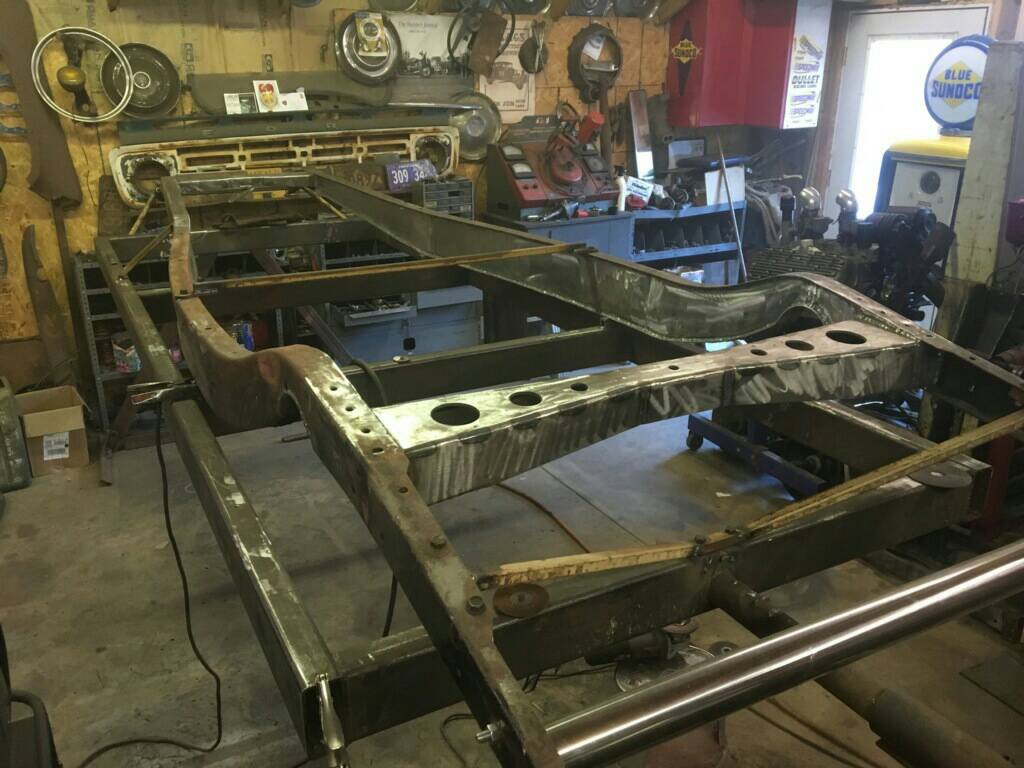

  23. HomemadeHardtop57
    Posts: 4,199
    HomemadeHardtop57

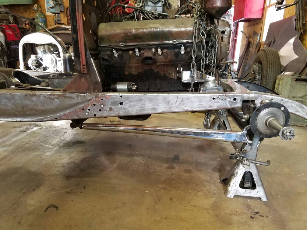

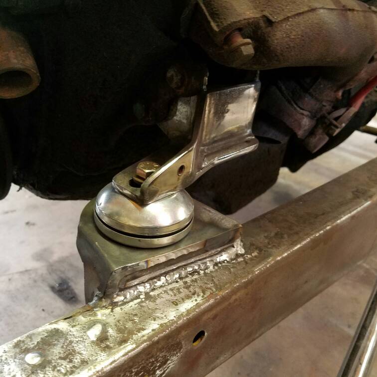

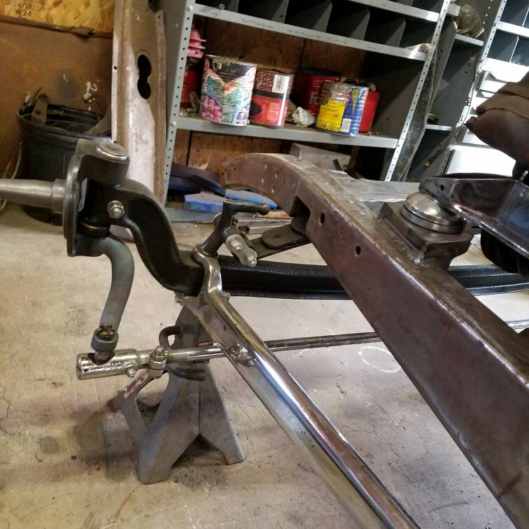

    Frame flipped over and front wishbone mounts welded in. We took advantage of the X member leg and positioned these a bit inward to allow for more tire clearance.

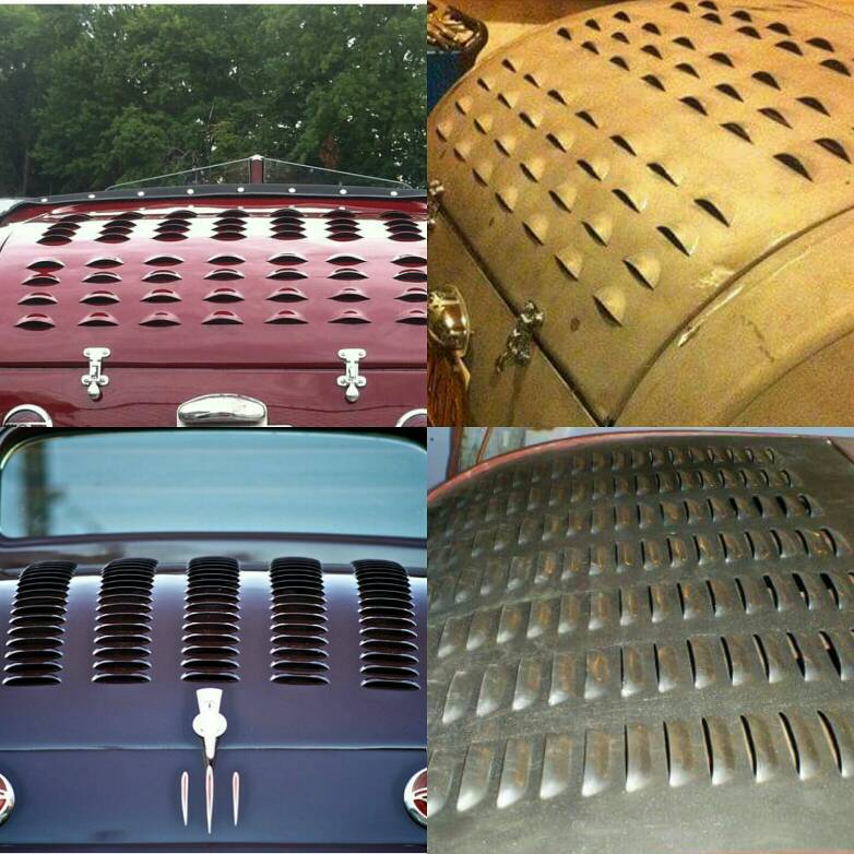

  27. HomemadeHardtop57
    Posts: 4,199
    HomemadeHardtop57
    I am trying to decide on what style of louver to go with on my new project. I have two that I do. Top two pics are my hand cut and hammered ones. Those are more of a clam shell old style. Two pics on bottom are the ones my hydraulic press punches. These have a rounded edge too but a longer top. Hummmm going to do my deck lid, roof inset, and an aluminum hood that I'm going to make.
  28. bengeltiger
    Joined: Mar 3, 2012
    Posts: 469
    bengeltiger
    Both louver styles look great especially the traditional clam-she'll ones but "hand cut and hammered" in volume would have me looking at the press style.
