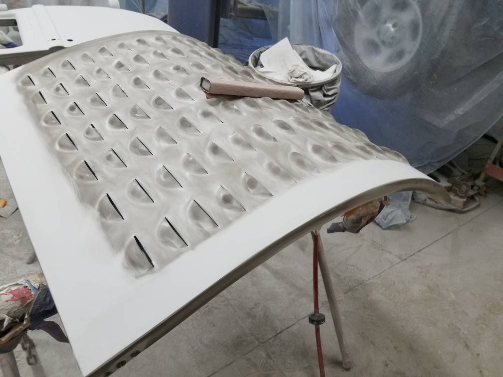

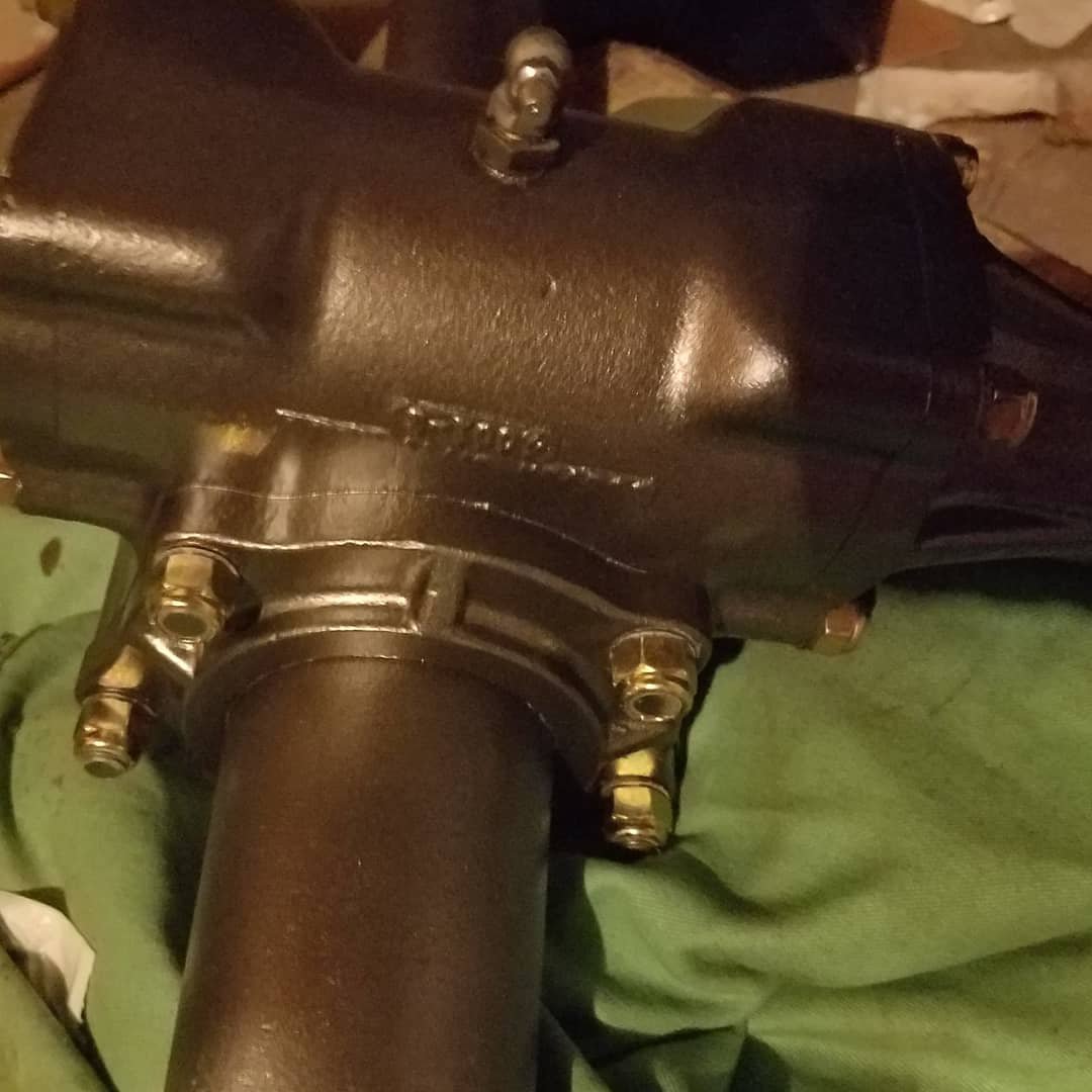

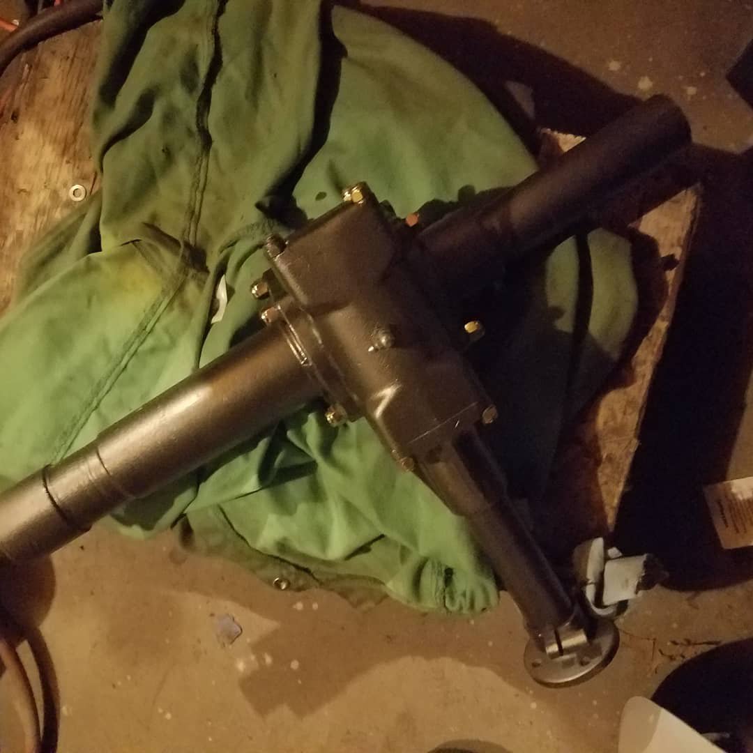

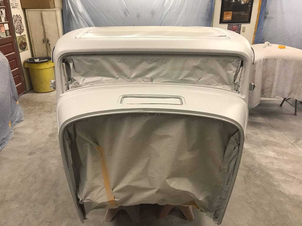

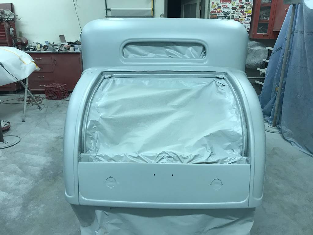

    Decklid getting blocked and guidecoated. Steering box put back together , lubed, new hardware, and ready to go IMG_20190211_174535_498.jpeg

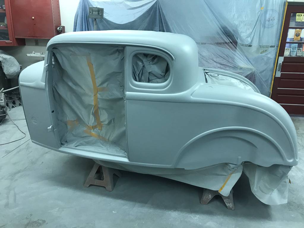

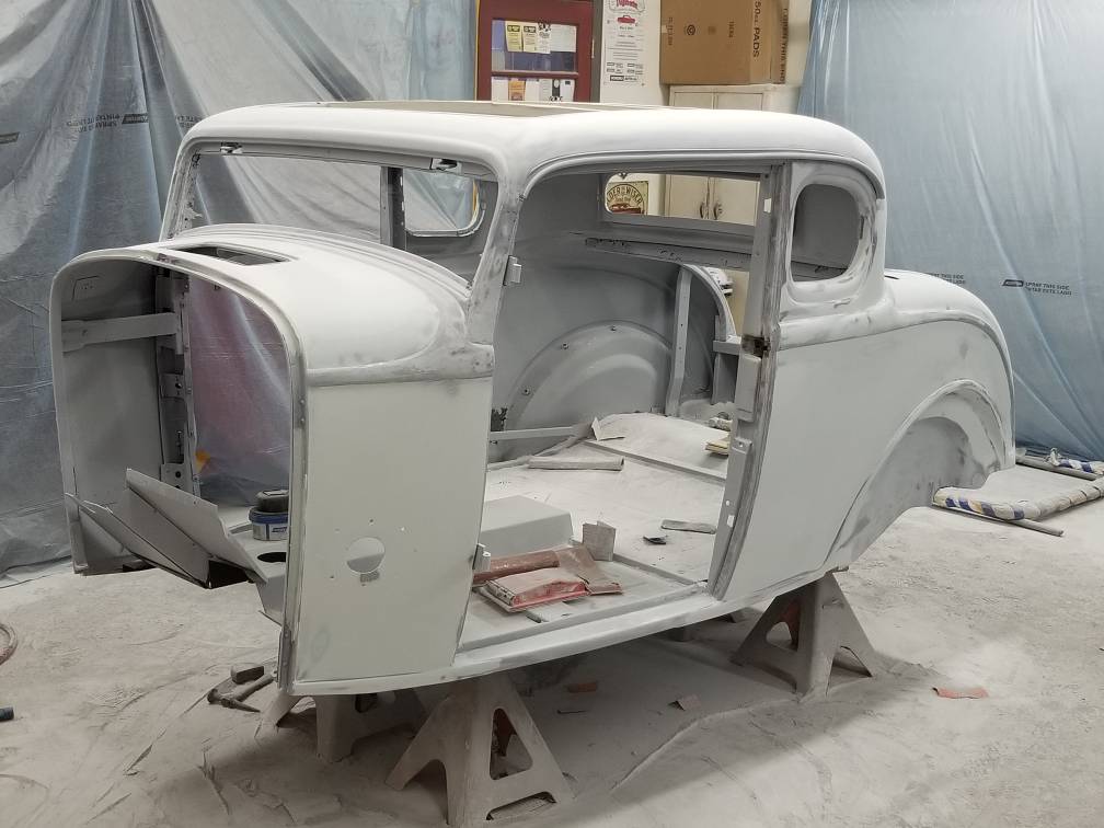

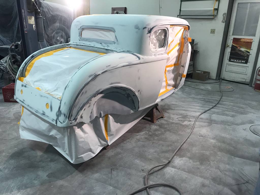

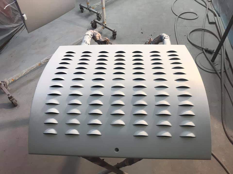

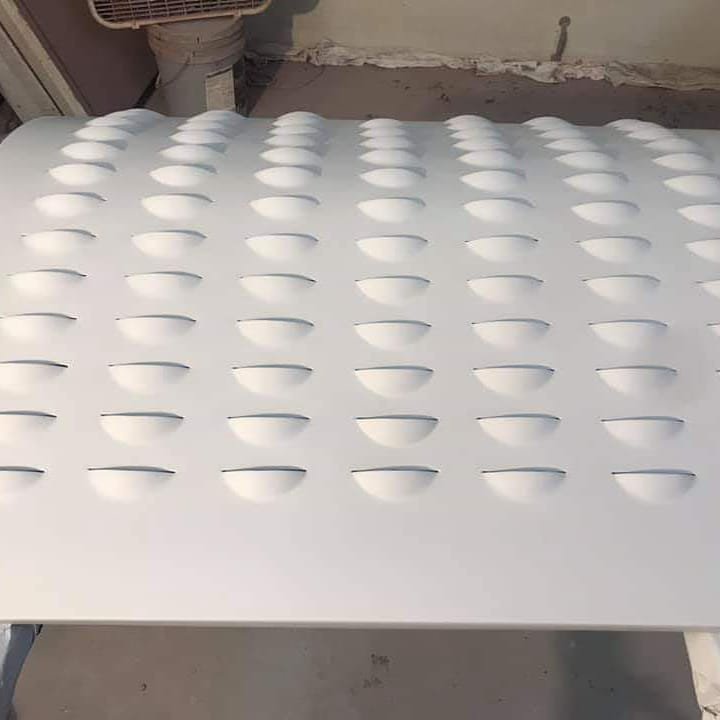

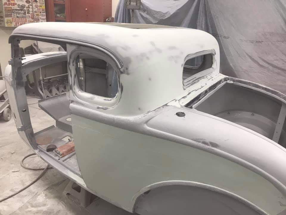

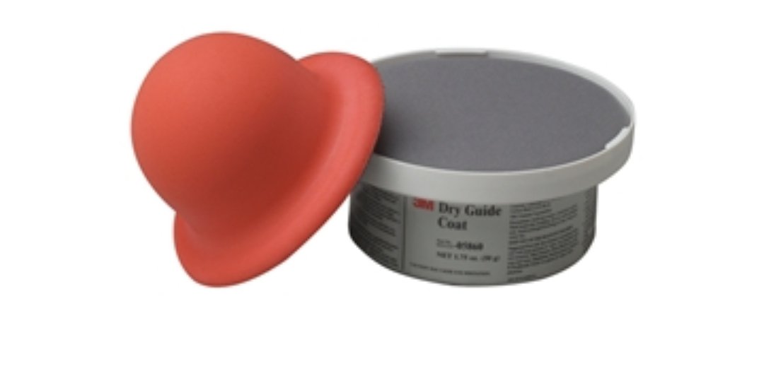

    Oh that dreaded stage so many talk about...prepping "The Louvers"...however it looks as if you're signature louvers have some spacing that may make finishing a wee bit less tedious? I was wondering what guidecoat is so I looked it up...Helps identify imperfections in surface...so the there is an additional coat of the lighter primer after you guide prime or are both compatible with final paint?
    Thanks again for sharing this detailed adventure with us...
  6. HomemadeHardtop57
    Joined: Nov 15, 2007
    Posts: 4,328
    HomemadeHardtop57
    The "guide coat" can either be quick dusting of another color of primer on top or you can use a product that is more like a powder, wiped on with an applicator. We are using a guide coat made by 3m which wipes on
    The guide helps identify low spots, but also lets you know where you have sanded and where you have not. The entire surface is sanded down several times with progressively finer sand paper each time...with guide coat put on before sanding begins each time.
    The spacing on my louvers does allow for a bit more sanding area between louvers, but not much. Screenshot_20190217-192301_Chrome.jpeg

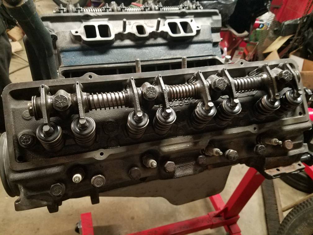

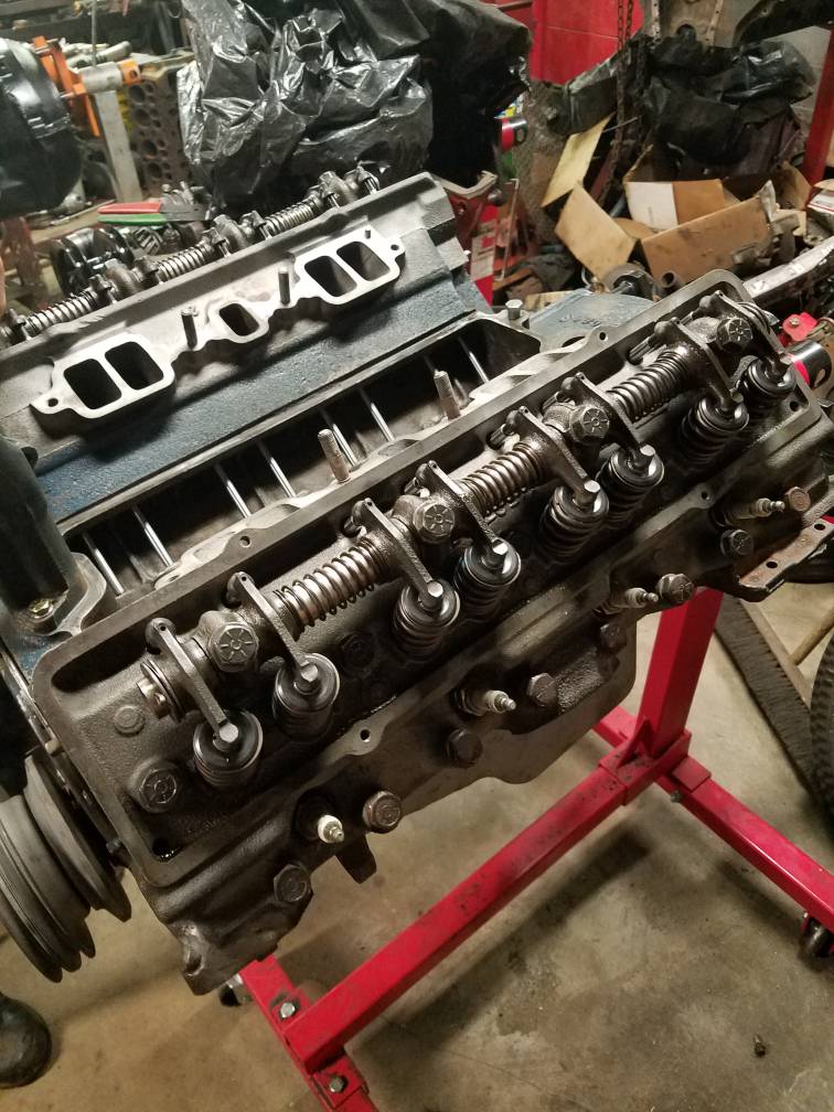

    Engine is all ready from the machine shop. Machined, bottom end assembled. Coming hack to my place for paint and top end assembly then back to his shop for break in on the stand 20190221_200252.jpeg IMG_20190221_202249_943.jpeg 20190221_194437.jpeg

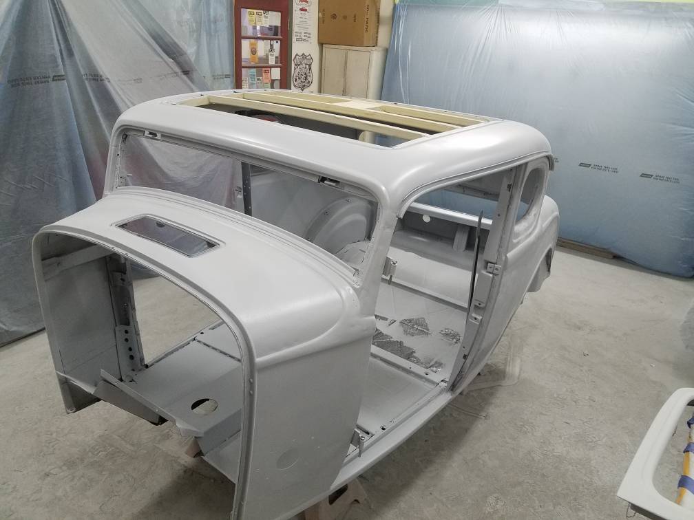

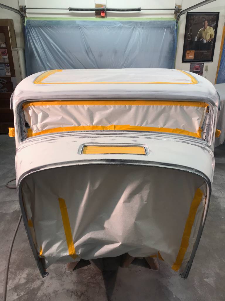

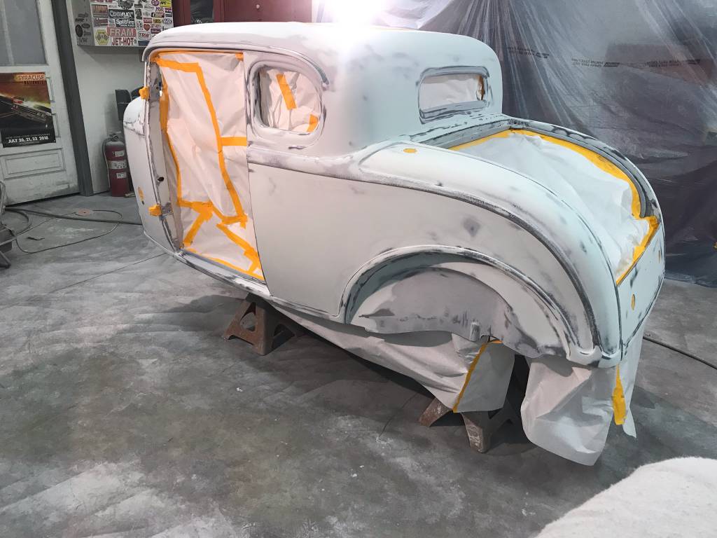

    Bodywork progressing at Dave's place..Im banging away on the engine at my shop 20190303_130018.jpeg IMG_20190303_175218_605.jpeg

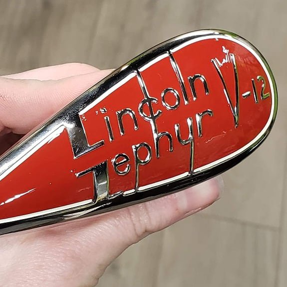

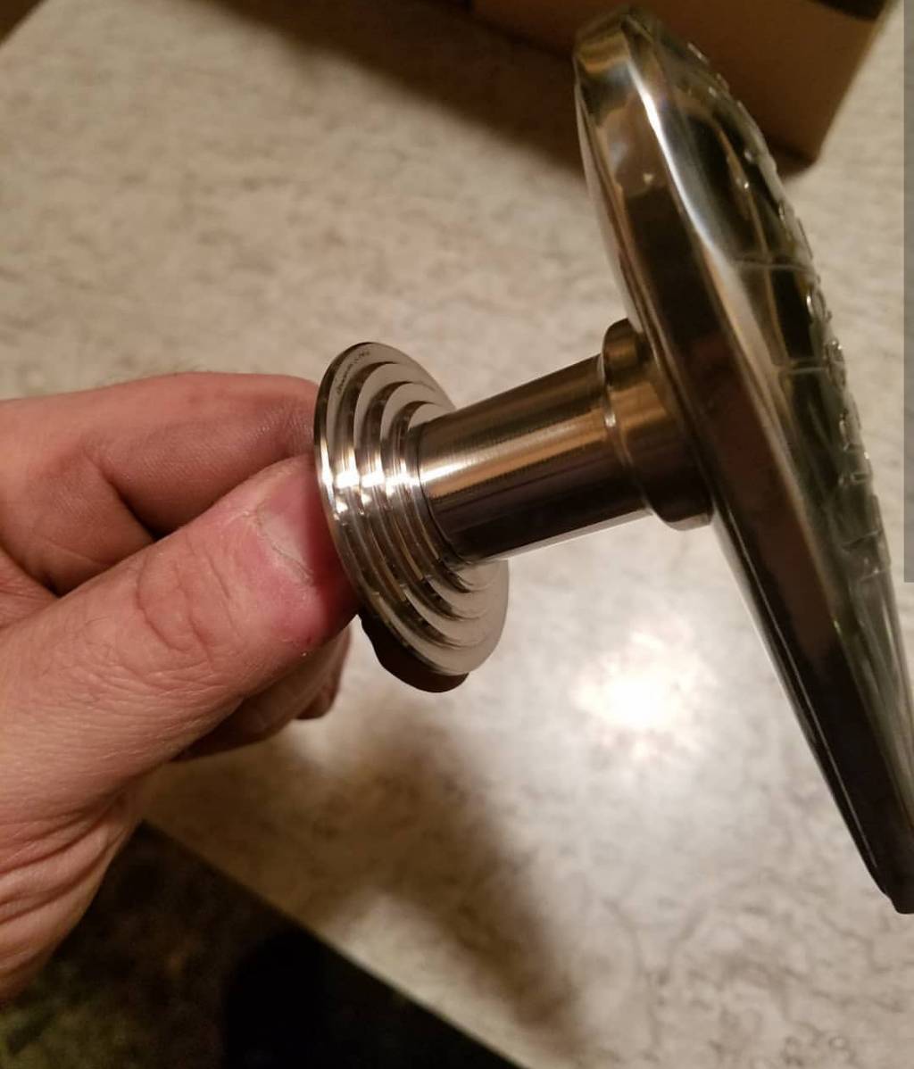

    Hot rod Jen painted and pinstriped my trunk handle... Here's a couple pics still wet Screenshot_20190311-221545_Instagram.jpeg Screenshot_20190311-221605_Instagram.jpeg Screenshot_20190311-221519_Instagram.jpeg IMG_20190311_221325_173.jpeg IMG_20190311_221325_160.jpeg

  30. Wow! That handle came out fantastic!
