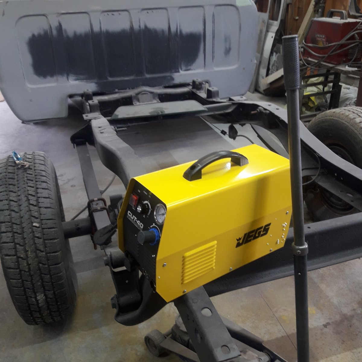

  23. Guess we'll find out huh? Call me the Guinea pig :D 20210418_164321.jpg 20210418_164633.jpg

    Scratch start or pilot arc?
  25. To be honest i have no idea, but I'm gonna assume pilot arc. I took it out of the box and that's about as far as I got. The bodyshop has exploded and i don't have time to turn around lol. Just shut it down for the night. Everyday I'm not at the firehouse, I'm in that shop 12-14 hours a day :rolleyes:
