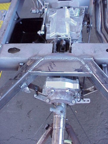

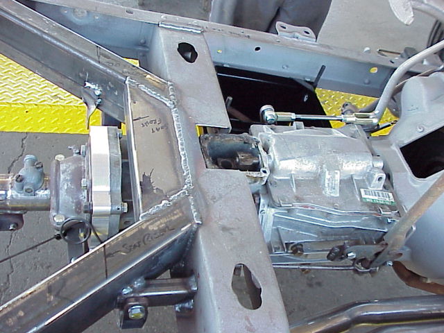

    Here are the pics. I built the thing.

    Thanks for the pictures, and BTW I emailed you.

  21. Thanks for posting those pics. Many of us have been working on the T5-torquetube idea.

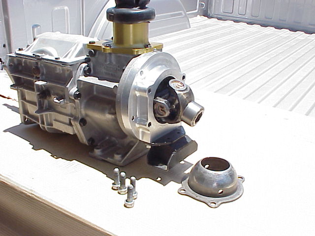

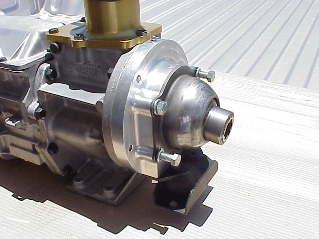

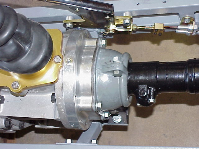

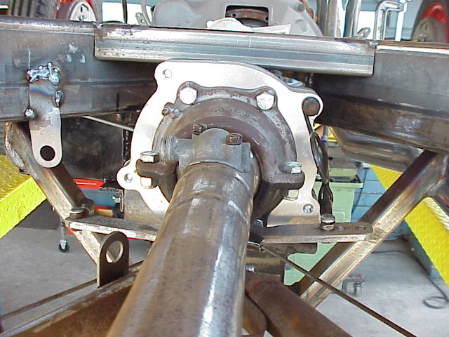

    I have made two different adapters for the T-5. One uses the Jeep trans, the other is for the S-10 4x4 trans. I think the S-10 trans is more versatile. I can post pics of the S-10 adapter later tonight.
    I have received enough feed back from the Model "A" groups that I am working on a casting patern so that I can cut my costs to a point that I could offer a kit that would include the adapter, the yokes and the U-joint with instruction on how to do the modifications. I have been running this in my '27 RPU for some time now with no problems.
    RDR, John Heckman and rexrogers like this.
  25. I have made two different adapters for the T-5. One uses the Jeep trans, the other is for the S-10 4x4 trans. I think the S-10 trans is more versatile. I can post pics of the S-10 adapter later tonight.
    I have received enough feed back from the Model "A" groups that I am working on a casting patern so that I can cut my costs to a point that I could offer a kit that would include the adapter, the yokes and the U-joint with instruction on how to do the modifications. I have been running this in my '27 RPU for some time now with no problems.[/quote]

    The trans spline and the driveshaft spline are different. No mods to either spline required for the adaptation. The adapter bolts right onto the trans flange. Torque tube bolts to adapter. The drive shaft and the torque tube have to be shortened.

    Here are a couple of pics of the adapter I made for the S-10 4x4 trans
