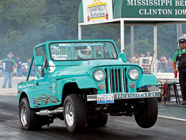

    image.jpeg A jeep Dana 44 from 1971 to 1975 will have a pumpkin that is in the middle or centered . This is because they were still running the 18 transfer case .
    The model 20 jeep rearend in later jeeps 1976 to 81 had this rear and isn't to bad either . Don't do any hole shots it has a weak pinion support bearing . My buddy race yes race his jeep with the model 20 for a few years but upgraded to one piece axles.
