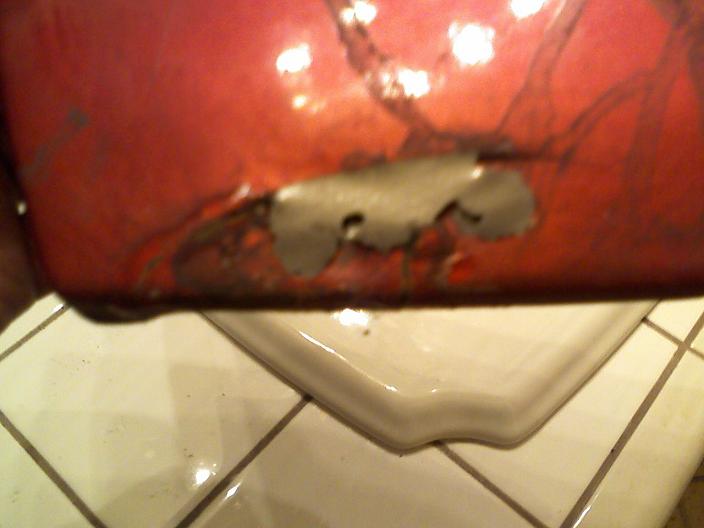

  27. Broken bike side covers. Three separate broken pieces become one again.
    JBWELD, ACE Hardware rattle cans, and urethane clearcoat.
    I chose JB Weld over the others because it had the right amount of fillers to match the same "hardness" and flex as the sidecovers. It does no good to use a hard patch that doesn't flex along with the material being patched.
    Everything was bevelled and tapered to make a gentle transition between filler and base material so no cracks or seams show up later.
    To replace the broken mounting studs, I ground some bolts to shape, and JB Welded them in place.
    Stronger and prettier than new.
    Click on a close up and see how awesome it looks.
    THE LIGHTS ARE TURNED OFF. Only the camera flash.
    I wish I could do this for a living. It was fun to do.
