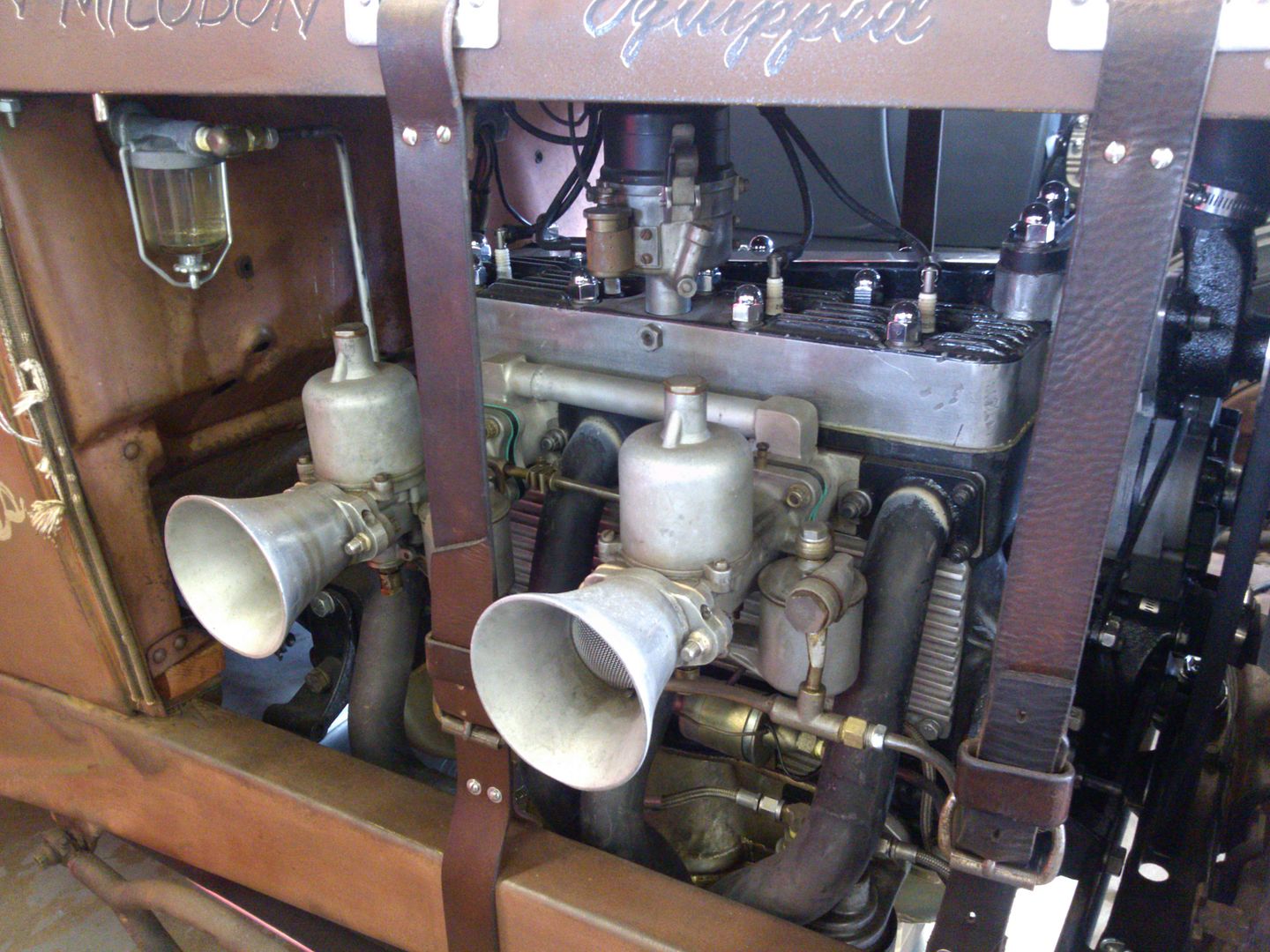

    Before I pull it though I'm going to add a little bit more carburation - twin downdraft SU's on a Riley manifold is the plan.

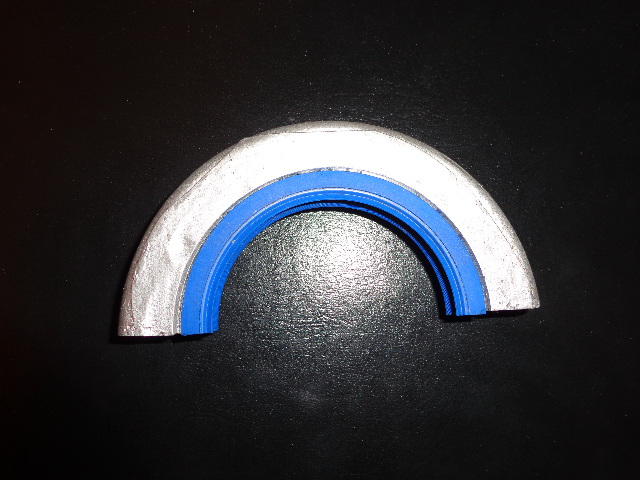

    Oil seal day 2. I have the casting machined to accept the oil seal. it was a little trickier than I thought due to variences in the casting, basically there are no true surfaces to measure/machine off.
    I'm not a machinist by any means, just a hobbiest that happens to have machine tools so I kinda feel my way through these things.
    the lip the seal fits in required me to put shims under the part inorder to get it to have a consistant thickness. After I doped that one out it went well.
    Tomorrow i'll test fit it in the block and see about machining the main cap and making a insert to hold the other side of the seal.

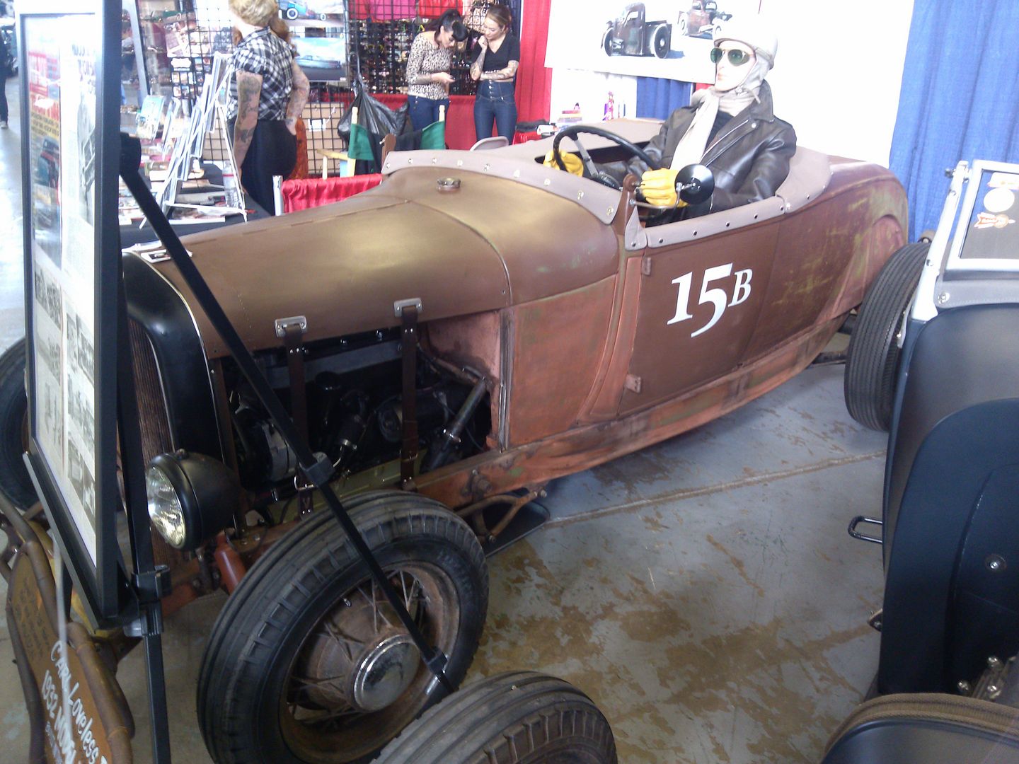

    Thank you for posting pics of the carl loveless roadster. The tech stuff on this motor has always facinated me.

    Thank you for posting photos of the display especially the magazine tech items.
