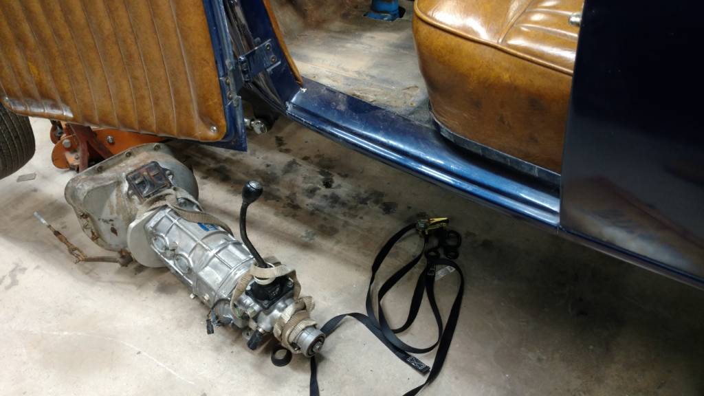

    Happy banging in 2021 all yous banger nuts...
    This years project 1. Dynamic absorbing flywheel and 5 speed into Adobe Roadster.... IMG_20210101_101309072.jpeg

  10. What 5-speed is that? Looks Mazda-ish?

    @winduptoy , man that shifter looks far back, very cool adaptation though. Some clever folk out there.

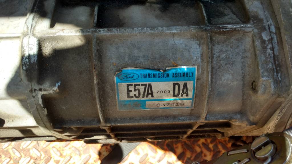

  15. winduptoy
    Joined: Feb 19, 2013
    Posts: 2,316
    winduptoy
    ToyoKoygo... I think '83 up for a Ford 2wd Ranger first is a little low like 4:1
    But the car has 2:22 rear gear IMG_20200717_151020090_HDR.jpeg

  17. Ah, so it would be the same as my old 2WD Mazda B2200. That had a huge gap between 3rd & 4th.

    ToyoKoygo TK5 1st: 3.96 2nd: 2.07 3rd: 1.39 4th: 1.00 5th: 0.84 I think that Mazda splits were a little different
    Its got to be better than 1st Gear: 3.520 : 1 2nd Gear: 1.604 : 1 3rd Gear: 1 : 1 that's in it now

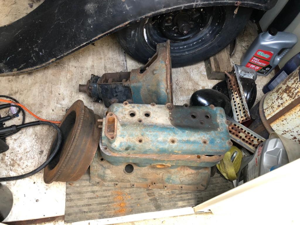

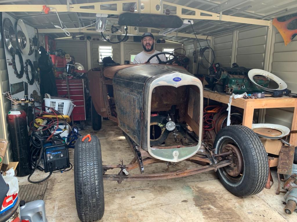

  27. Checking in! Got a trans and spare block from a friend, and bought a roadster for pack of beer this weekend!
    What I thought was going to be a rough year is turning out quite awesome!
