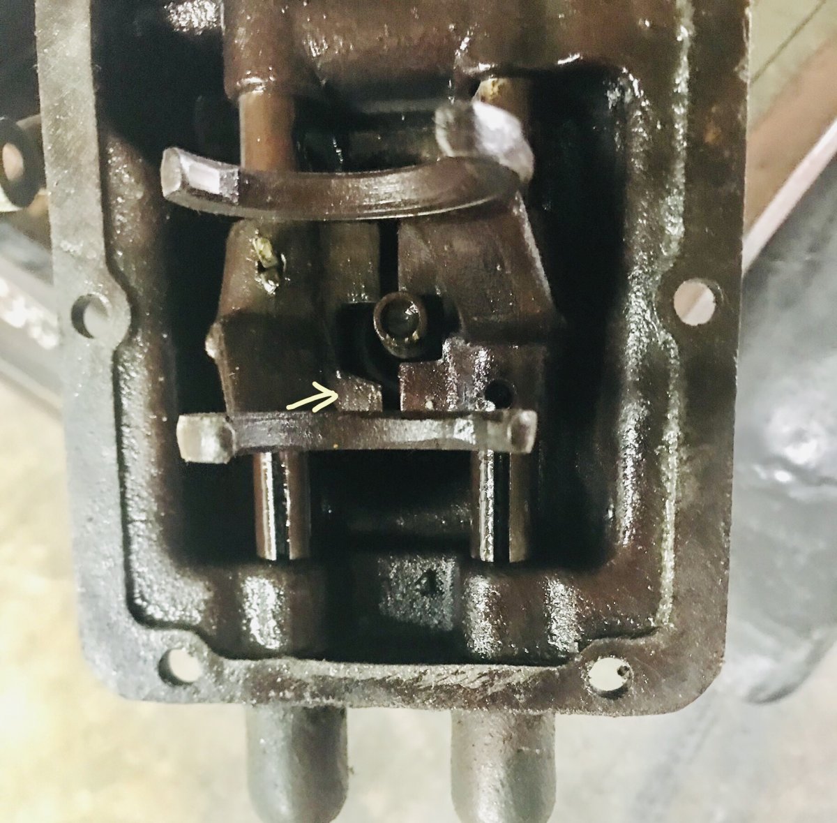

    Sunday I pulled the transmission lid off my pickup- I really had to square up my shifts from 1st to 2nd haha. 9C996A9E-3B27-45E5-B71C-18C4A90BB81A.jpeg

    Doin same thing. Notches in forks not that bad, but ball on shift lever is about a cube.

    Shutter Speed- it was curious,on my pickup the gates are hugely worn but the ball just barely. On another the ball was a cube barely bigger than the stem but the gates were almost perfect. The one I ended up using had some wear on both but will work for now.

    Yeah @Jet96, hard tellin not knowing what kinda wear+tear these things have suffered.
    It’s my 1st trip inside a banger trans, and I’m rebuilding the “tower” for starters. I’m wondering, with the trans still in place, and with the top open, is there a way to rotate the gears for inspection to determine if a removal/rebuild is necessary?
    Any suggestions? Rear end on jack stands..clutch depressed..slow spin of rear wheel..or?
    I can spin the crank, but would be pretty slow goin back and forth.
    Is my ignorance showing?!
