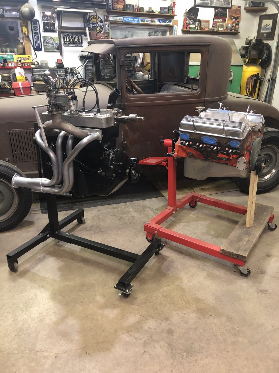

    Checking in for January.What a contrast for $$ per horsepower spending enough to go pretty slow 327 is going in another project banger.jpg

    Rule of thumb is generally that the price of building a good four banger is usually the same as buying three SBC crate motors.
    Dannerr, Old Dawg and burl like this.
