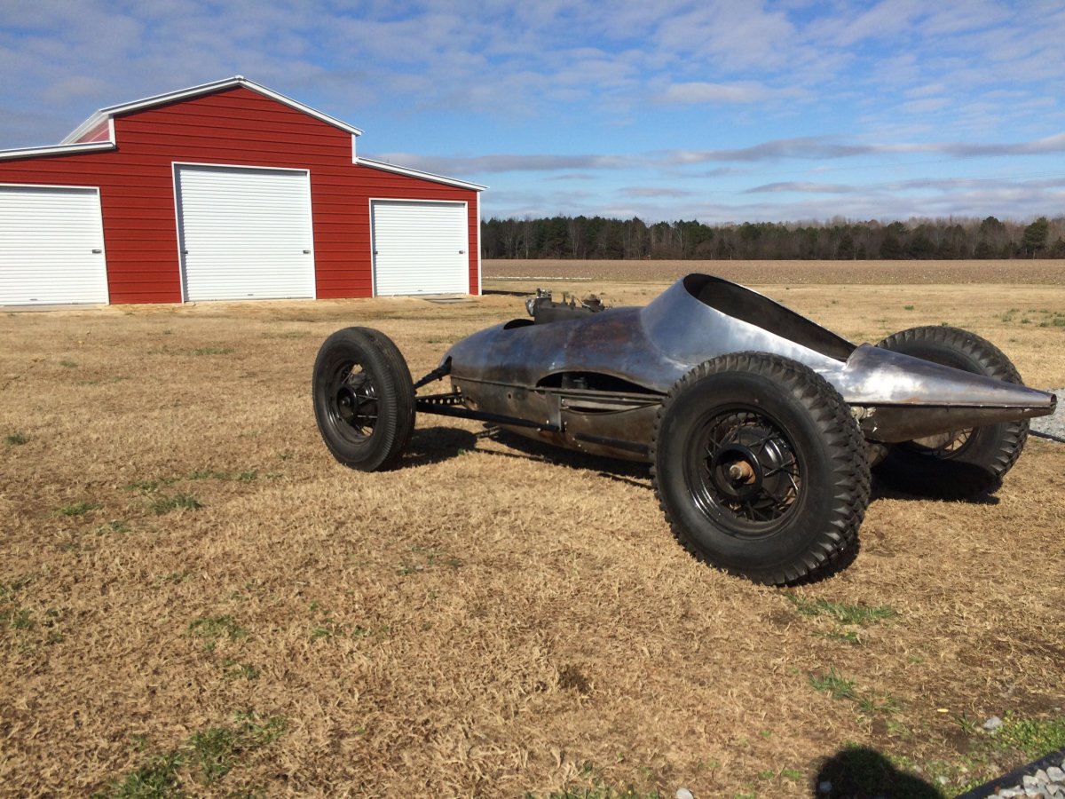

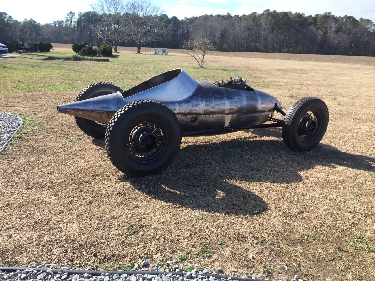

  2. IMG_2180.JPG IMG_2178.JPG A re-creation of bill burkes first tank. But with a banger.. hope you guys enjoy...

    Man, that is nice.
