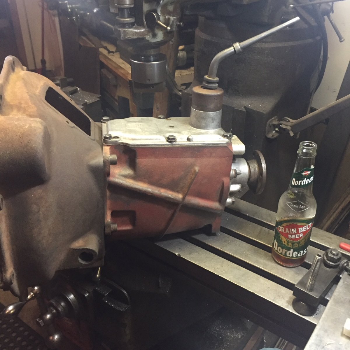

    burl.....what Volvo transmission is that you're using? Is it a 4-speed with 4th being an overdrive or ??? It looks like you're using a AA bellhousing. I ask all of this because I hope to get started soon on my to-be-banger-powered '31 coupe and am open to considering various options on transmissions. The #1 choice right now would be the '84-87 Ford pickup RTS170 3-speed + overdrive. I recently bought a AA bellhousing and I'm constantly keeping my eyes and ears open for a RTS170 transmission locally.
    Considering other machining you've done, I guess it's safe to assume you did the lightening of the flywheel yourself as well? A friend of mine has a shop that is pretty well equipped and would probably be willing to put my flywheel on a diet. I'm curious what youre flywheel weight is now? What about re-balancing when it was lightened....just a automotive machine shop that does crankshaft/rotating assembly balancing?

    Transmission is a Volvo m40 4 speed
    Ford AA bell housing
    Volvo clutch and pressure plate
    Volvo throw bearing assembly
    I lightened the flywheel myself on our large lathe started around 53 pounds down to about 41.Local guy that runs bangers on the street with lots of mods thought his car actually ran better with a stock flywheel.Will probably have the assembly balanced before I assemble it.The transmissions are out there if you look for them.Found three of them from one guy that was saving them for a project.They fit nice in the same spot and the shifter ends up in the right place fast four.jpg

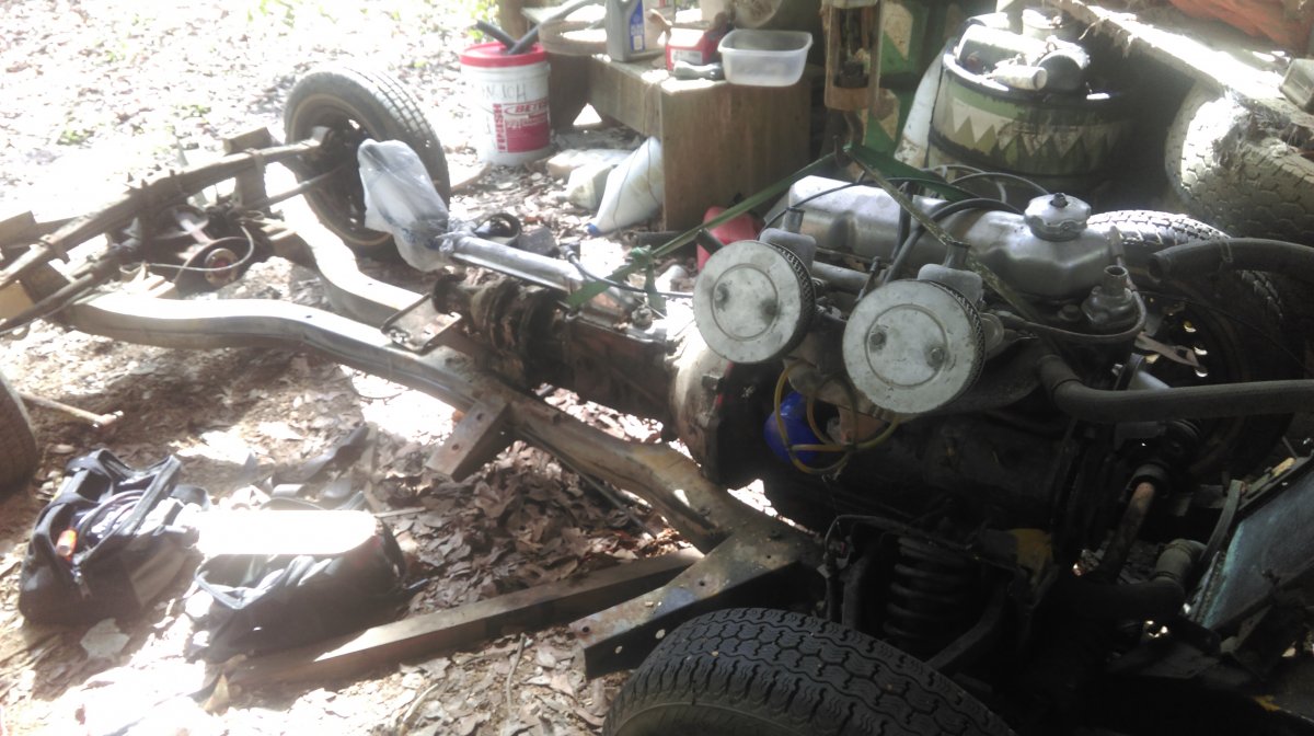

    The box of the m41 is the same as the box for the m40, but with a Laycock overdrive unit bolted to the tail. It's longer, but would bolt on to burl's motor. In this picture, the od unit is under the shifter. IMAG0395.jpg Sorry about the crappy picture quality. It's the only one I could find on my phone. I'm slowly putting a 1966 Volvo b18 with an m41 trans in a Triumph Spitfire. That shift extension can be replaced with a top loading shifter like burl's. Bolt on.

    Wonder how well those side drafts work on ford banger ?

    There's a hamber on here, manyolcars, who says they work really well. I'm in the process of seeing for myself, but have some work still to do. Those homemade manifolds are pretty terrible from a flow point of view, just tubing brazed to stock manifold ends, so there is a good bit of constriction and a pretty radical step (the carbs are 1 3/4"). Probably not ideal, but they are what I had lying around, so...

    The casing length (excluding O/D) of the Volvo trans is 8.875". The length of the stock A trans case is 6.594".
    So even with the AA bellhousing, which is 2" shorter than the A housing you need to shorten the torque tube .281" (9/32") or push the rear back that much. Moving the engine ahead is also an option.
    Also--when looking at Volvo transmissions, avoid the M4. This is the first iteration of the M40, but has weak syncros, in my experience

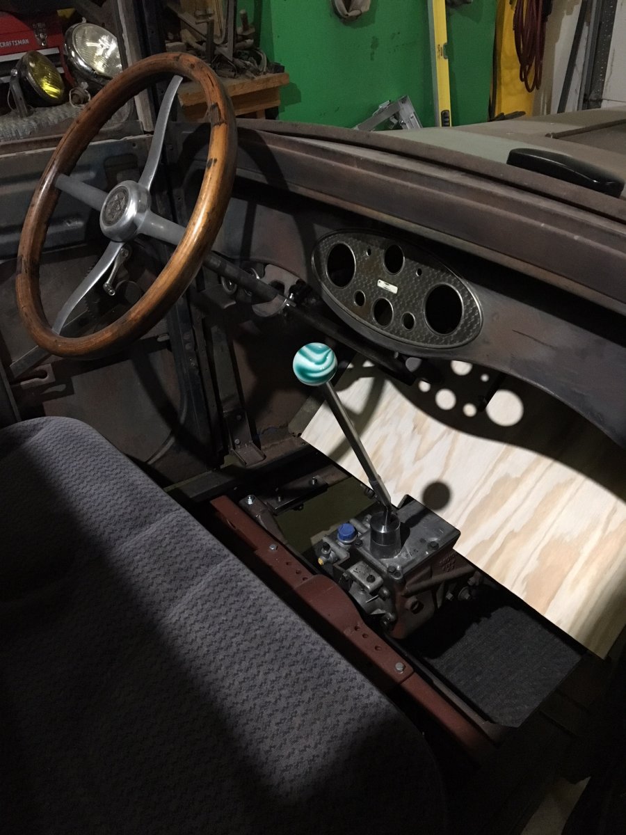

    try to find a good t-5 for less then $700 to $800.Then the shifter is in the wrong spot and needs to be dealt with.If I didn't have all the machining back round I have I probably would say the same thing.I think the Volvo fits the best plus I will be lucky to have more than $250.00 plus my time to make this work.Includes the transmission purchase and the new clutch and pressure plate.I kinda like taking the odd route on stuff.All of this is going into a 1928 dodge 3 window coupe with a 28 ford banger and 34 ford front and rear suspension.No wonder ive been working on this for a long time he he.
