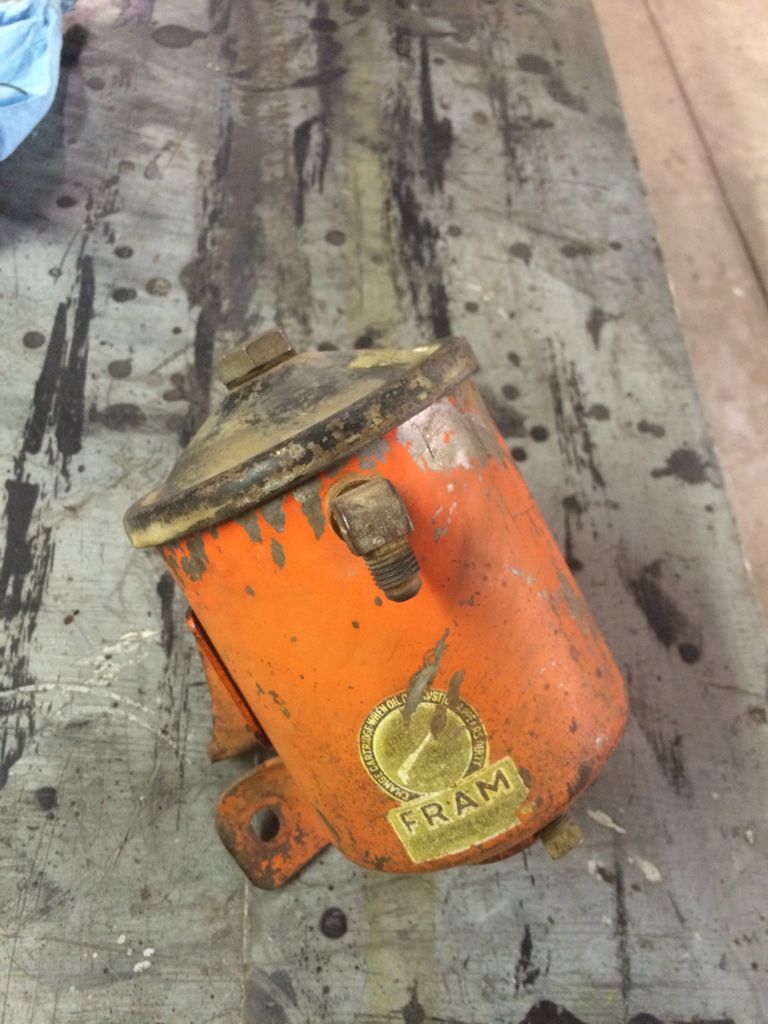

    Does anybody run one of these on a stock oiling A motor? If so how do you set it up? ImageUploadedByH.A.M.B.1454100637.769694.jpg

    better filters out there

    I found that one in my parts stash and was wondering. I have seen the modern setups for the A but am concerned about using one of those with my Red's Tube header. I am not sure the kit I saw on Brattons will fit under my exhaust.

    You can run an A-Fordable filter under headers with a 90 degree adapter. I actually sold mine as it's easier to change the oil more often!

    That is kind of what I was thinking. I figured if people were running that vintage filter and I could easily set it up I would. If not no big deal. I change the oil often and had the pan off the motor and cleaned the pan out and the valve lifter chamber. Thanks for the info everyone. Not running that filter I found means I don't have to search for filter elements to go in it. HA!

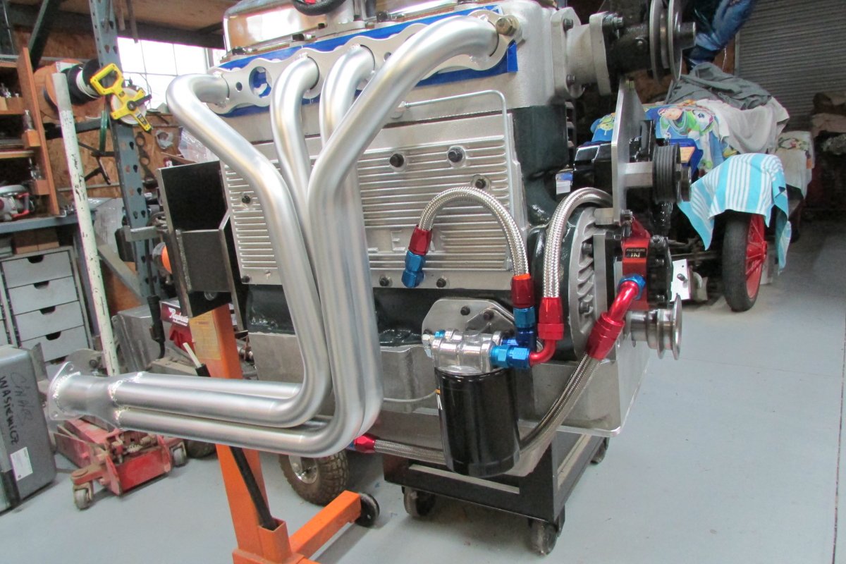

    Pep Boys has the filter element
  8. Take the pipe plug out of side of engine at oil pump just above pan rail. Tap out to 1/4 pipe, run line from there to inlet side of filter, then run a line from outlet side of filter, and tap into valve cover and route oil into front of valve chamber. You must use a little imagination and ingenuity. I mounted one to the pan rail with an adapter another I attached to the frame.It will work as well as some a the new ones.
    I'm not going to give my opinion as to wether you need it, just tryin to answer your question. One bit of advice, don't start the engine till you have everything connected!!

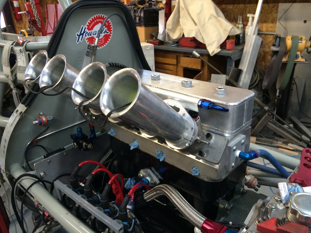

    this is just not right . must be a "mines bigger than yours" . is that for the lakes car ? .......... steve (& yes his is bigger)
  11. Steve,
    not Lakes/Bonneville motor, Hill Climb short run. It is a Serr Miller 2 port head and 5 main with Brierley cam.
    There is no room for oil pump in bottom end where it normally is and owner didn't want a belt drive.
    Pump is driven from cam with wet sump/pan.
    Here is a mine is bigger than yours pic.............the "greenish" color in the in take stacks are tennis balls. The second pass on this went better than 150 mph.

    yes I remember this one . how do you stand all the eye candy ! nice stuff

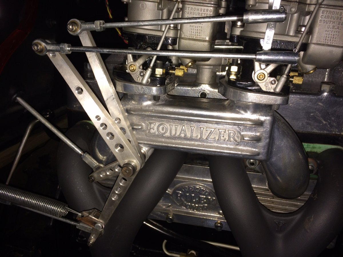

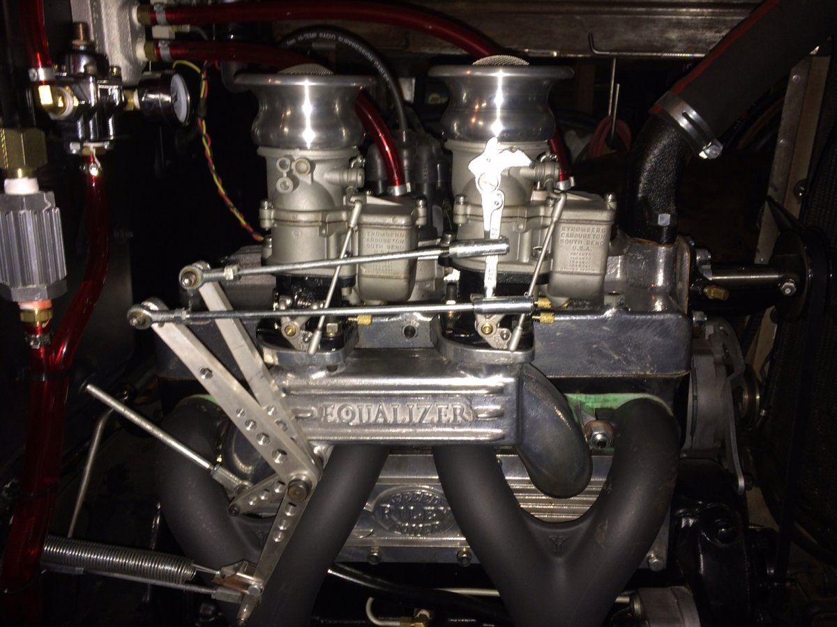

    you can just build your own...i built a double, one for throttle one for choke works very well. image.jpeg image.jpeg

  24. Guys.... some of us are no where near you at metal skills and equipment. Shit I don't even have a drill press yet. That said, with out one to copy, where can I get the measurements of the distance from holes to the center. My recollection of geometry is that the further from the anchor point the connection to the throttle pedal is, the shorter the movement at the carb is right?

    My bellcranks are boomerang shaped because I originally had the front carb in the back so I need short linkages. But I relocated the rear carb to the front of the manifold, so I just made longer linkages. Make sure the upper side of the bell crank keeps the throttle linkage fairly level. If you make it too short the lever will pull the linkage on a downward angle, which makes it hard to break the the butterfly linkage over center......Level Good, upward or downward linkage angle Bad. If you like I can measure the upper and lower lengths of the bellcranks. For me this was all trial and error but they work good and I get full throttle just as the pedal reaches the floor.
