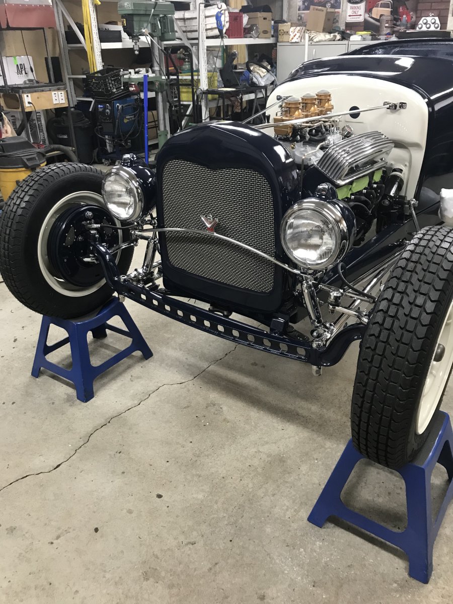

    Forklift stands
    About $300 Canadian for the set
    I have an old set at home in my garage work great!

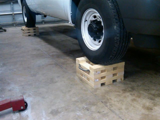

    20 bucks or so worth of lumber would make some solid stands too. You could make them what ever height you wanted within reason. 2x4 under car stand2.jpg

    I like this idea and looks like time to make some.

    I'm going to build some of these to go with my 2 post lift. No problem in jacking it up and gives a great way to work on the car with the suspension loaded. Exhaust system and suspension development come to mind.
    What length of boards do you recommend? Looks like about 16".

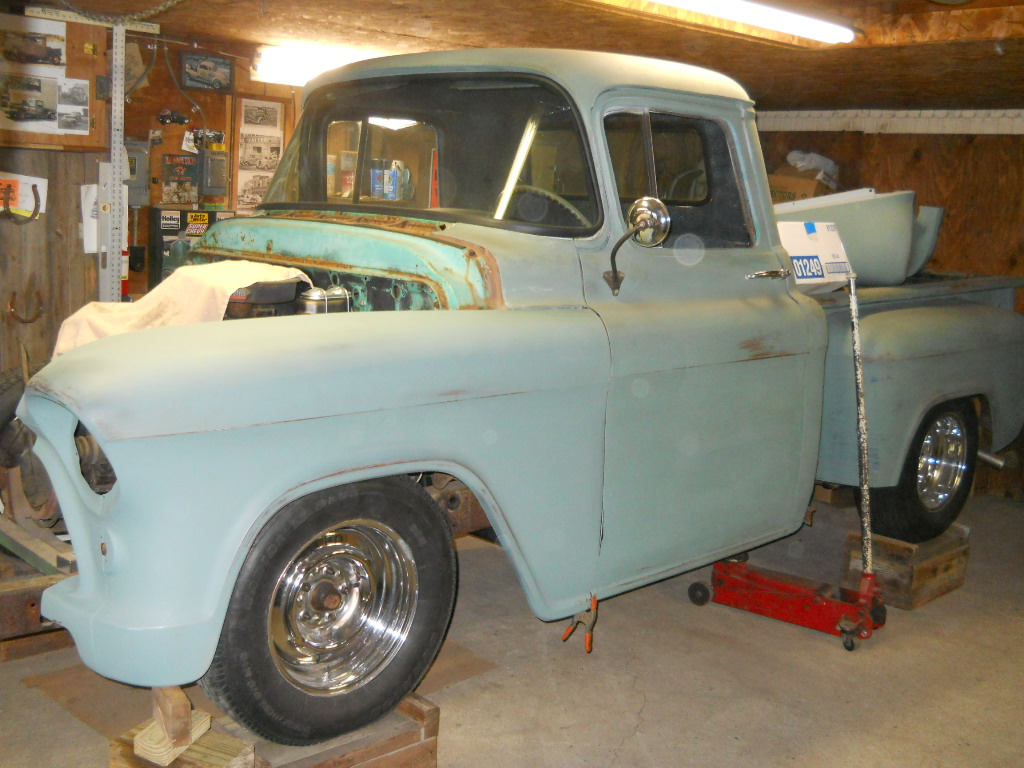

    ,,,I made these boxes to use when I'm building a project, work great

    Not sure I'd do that with soft pine from the local Home Depot, I'd trust them more if made with hard wood. Some pallets are hardwood, might be a better source of material if you can find them.
    Boneyard51 likes this.
  30. Boneyard51
    Joined: Dec 10, 2017
    Posts: 6,451
    Boneyard51
    I think the way Mr48 Chevy design it, soft wood should be strong enough, BUT, for added strength a layer of 7/16 plywood could be installed under the top boards. This would give some insurance.
    That pallet wood is often very hard to work with and is sometimes dimensionaly challenged. Ask me how I know! Lol
