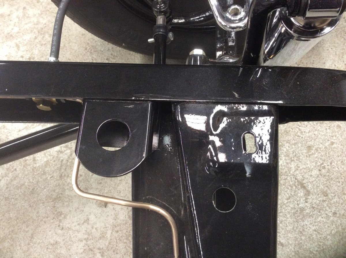

  23. ydopen
    Joined: Mar 14, 2010
    Posts: 231
    ydopen
    41B937C7-4FF4-4CDE-9EFE-2493EDC8C9A8.jpeg I have 2 cars with driver side banjo T’s .I do not have part nos,but they were standard Ford fittings and rubber brake lines. 2copper washers.
    John
    edwardlloyd likes this.
