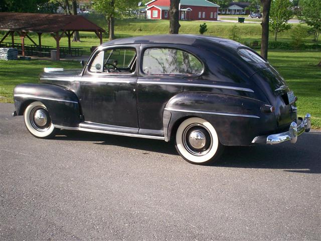

    Heres a couple that I have and had, I still have the 46 sold the 47, I lovem, BEST ROAD TRIP CAR imaginable................
    You gotta a good one there, hang on to it!!!!!!!!!!!!!!!!
  5. ^^^^^^That 47 looks familiar......I'm loving mine, and haven't gotten it off the driveway yet!

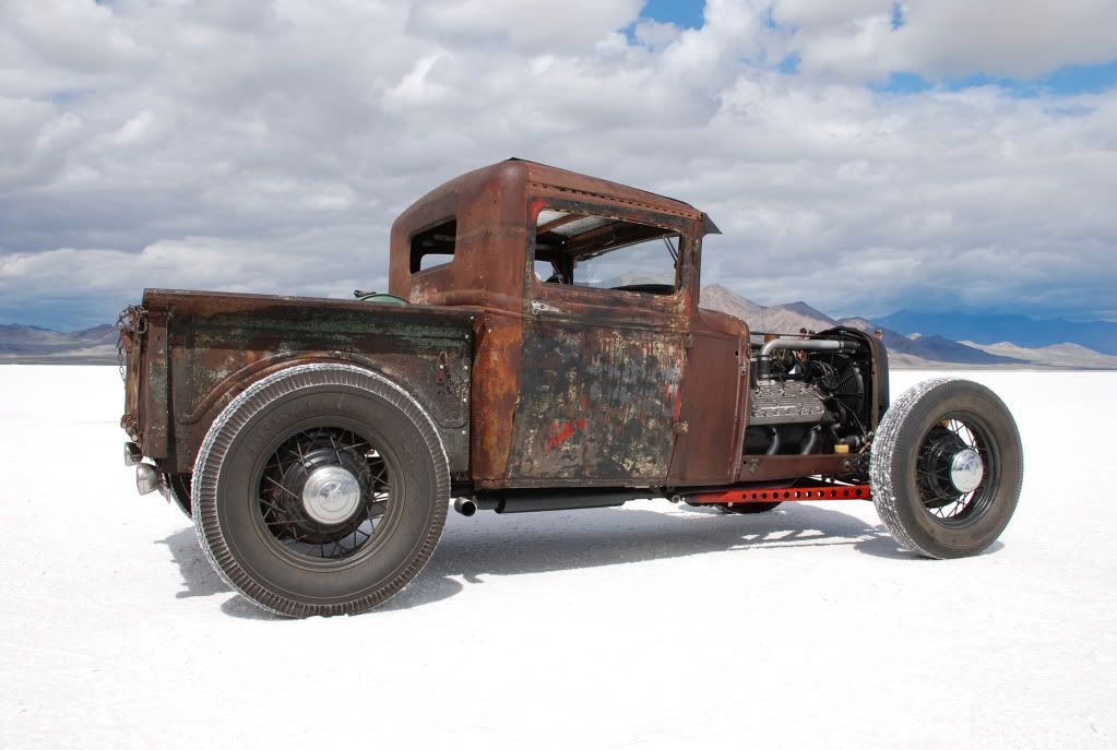

    Did you own a 1930 truck with a flathead in it? thanks dan

    Yep. If you'r meaning this one. :)
