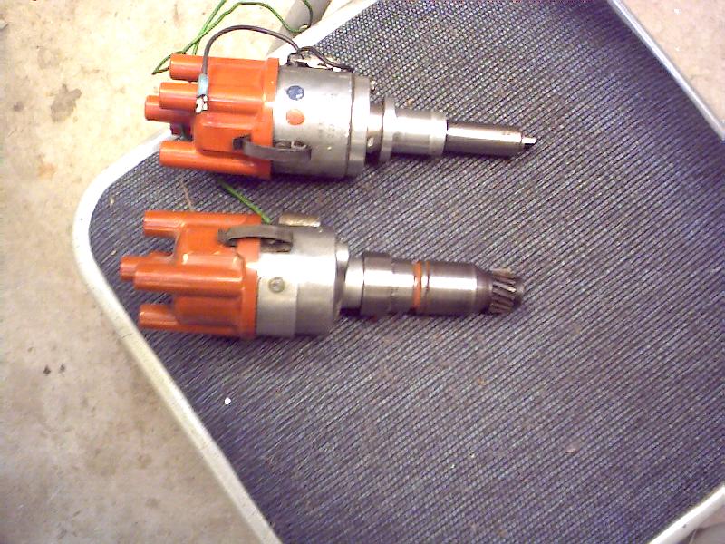

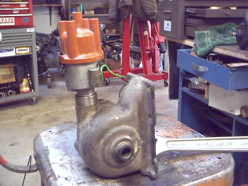

    Adapting Bosch Distributors to a '32 Plymouth and a '26 Dodge. The Plymouth uses a Pinto part and the Dodge a VW part. They are the same inside. Now I can get parts at Pep Boys.

  13. Neat stuff!! Is that dizzy angle drive stock Mopar?:cool:

    Stock Dodge Bros. Pre Chrysler Corp. It drove the distributer, fan belt, Water pump, and generator. After Dodge merged into Chrysler they used 6 and 8 cylinder engines.
