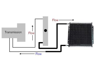

    Looking at this cooler for my trans. It'll go at the bottom of an aluminum radiator and after the cooler in said radiator. This fits perfectly under the A/C condenser. I'm just worried about it only being a 2 pass. I have a big B&M plate cooler, but, no place to put it that has direct airflow. Any opinion is appreciated.
    Let me add this is a stock 350-700R4 combo. Only trans mod is a 'vette servo and a shift kit.

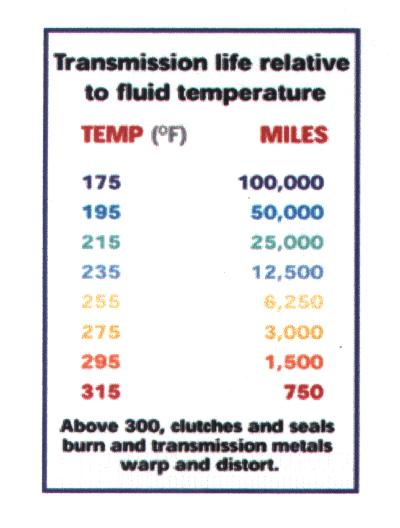

    Rule of thumb operating range is from 185-250. Cruising at 60mph and the pan temp could be 180 and then you pull a slight grade the temp will go to 200+. Pull a long steep grade or tow and it could climb to 250. If temp climbs to 300 over a prolonged period serious damage could occur. Temp fluctuation is normal however prolonged high temps will definitely shorten the life expectancy of your trans.
    • Good fluid is pink,
    • Red is used; and
    • Brown means you've waited too long.
    For optimum performance change the fluid, purge the system and change the filter every 15k miles (24k klms). For longevity used a quality trans cooler.
    Based on advice, the consensus is to run transmission coolers in a series, from pressure outlet of transmission through radiator first and then through an auxiliary cooler before going back to transmission.
    Firstly, the reasons for this is that if the transmission fluid is hot, it will be cooled more quickly and efficiently by the radiator. Secondly, if it is cool it will be warmed up and yes they can run too cool. When they run cool condensation that may be in the system remains there, NOT GOOD. The transmission needs heat for self preservation but not too much.
    If the fluid is too hot after it leaves the radiator it will be cooled by the auxiliary cooler before going back to the transmission. Auxiliary coolers needs to be mounted where airflow isn't impeded as it needs to dissipate or radiate the heat, air flowing through and over does the job. If stuck for space a small slimline auxiliary coolers with a fan is the go.
    In colder areas and on short trips, the transmission may not get hot enough to reach optimum operating temperature. By being routed through radiator firstly it will be heated to a better temperature.
    Big manufacturers spend $M on R&D so why not take advantage of their expertise, it's free. I wouldn't recommend just running an auxiliary cooler, my opinion, but definitely use your radiator. Why, because the transmission generates the second greatest amount of heat beside the engine.
    I personally prefer to run fluid line through the radiator first and then back through auxiliary transmission cooler. I've seen small air deflectors used to push air over and/or coolers in some instances where space is an issue. Don't have it too low so that you run the risk off loosing it due to road clearance issues. Last thing you want to do is grenade your transmission due to heat buildup and heat will kill them eventually. I've never been a fan of just a stand alone transmission cooler in isolation.

    Also the inline coolers mounted horizontal is what I have for my 46 Olds in conjunction with my Walker radiator. It'll get plenty of airflow to dissipate the heat. However if you go the other kind it must be mounted in front of radiator to take advantage of air flow. As my Olds is a big heavy car I'm going to the trouble of running an in-line transmission filter and thermostat as well. Some may say it's overkill, I say added insurance.
  17. I think I'd put the cooler ahead of the radiator instead of after. That will reduce the load on the engine cooling system, and should do a better job of maintaining an even temp.
    Hnstray likes this.

    I just read this, agreeing with what you said, which I never knew...
    The ideal range for fluid temperature is between 175 and 225 degrees, and every 20 degree drop in fluid temperature can help to double the life of your transmission.
