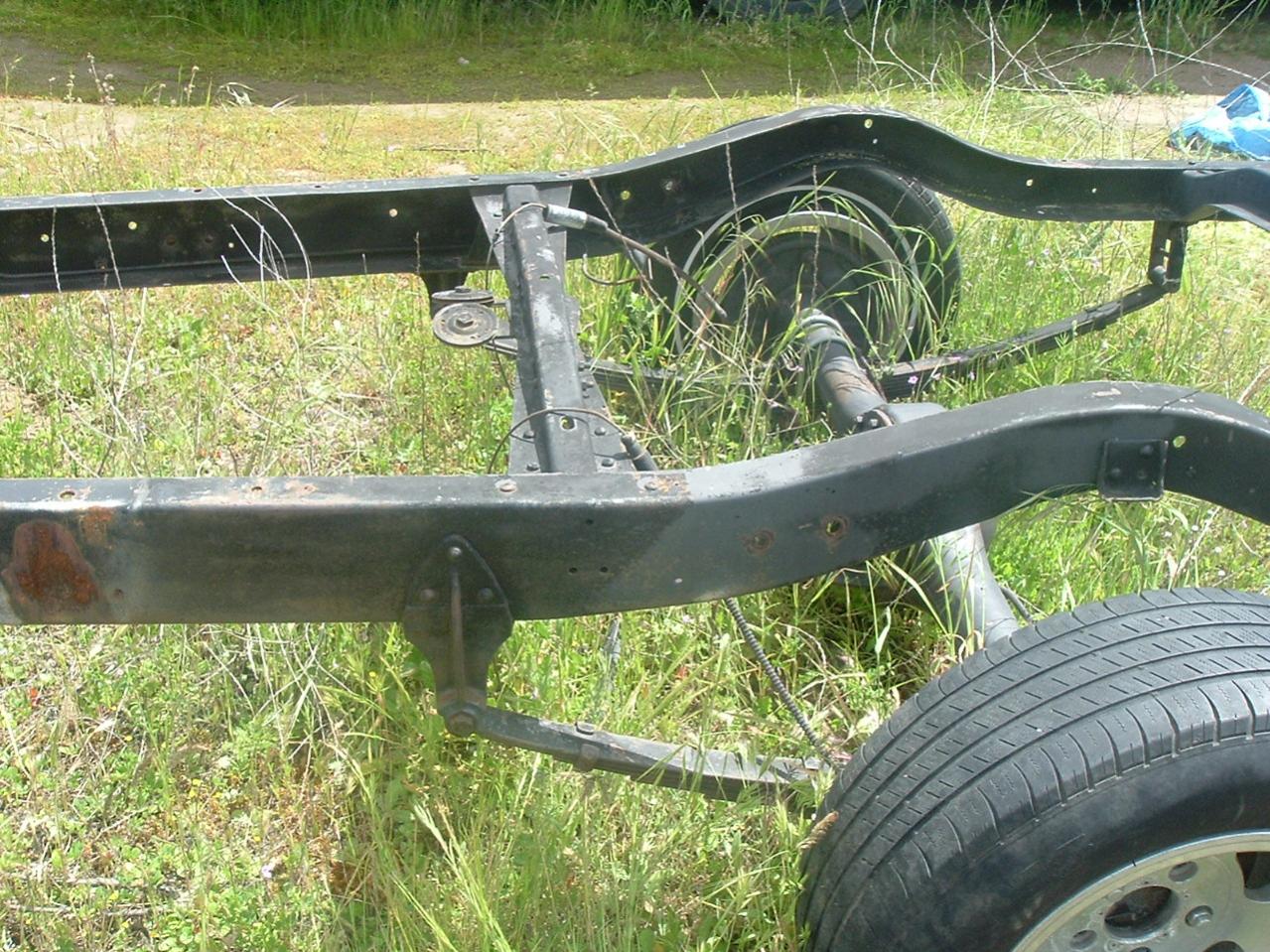

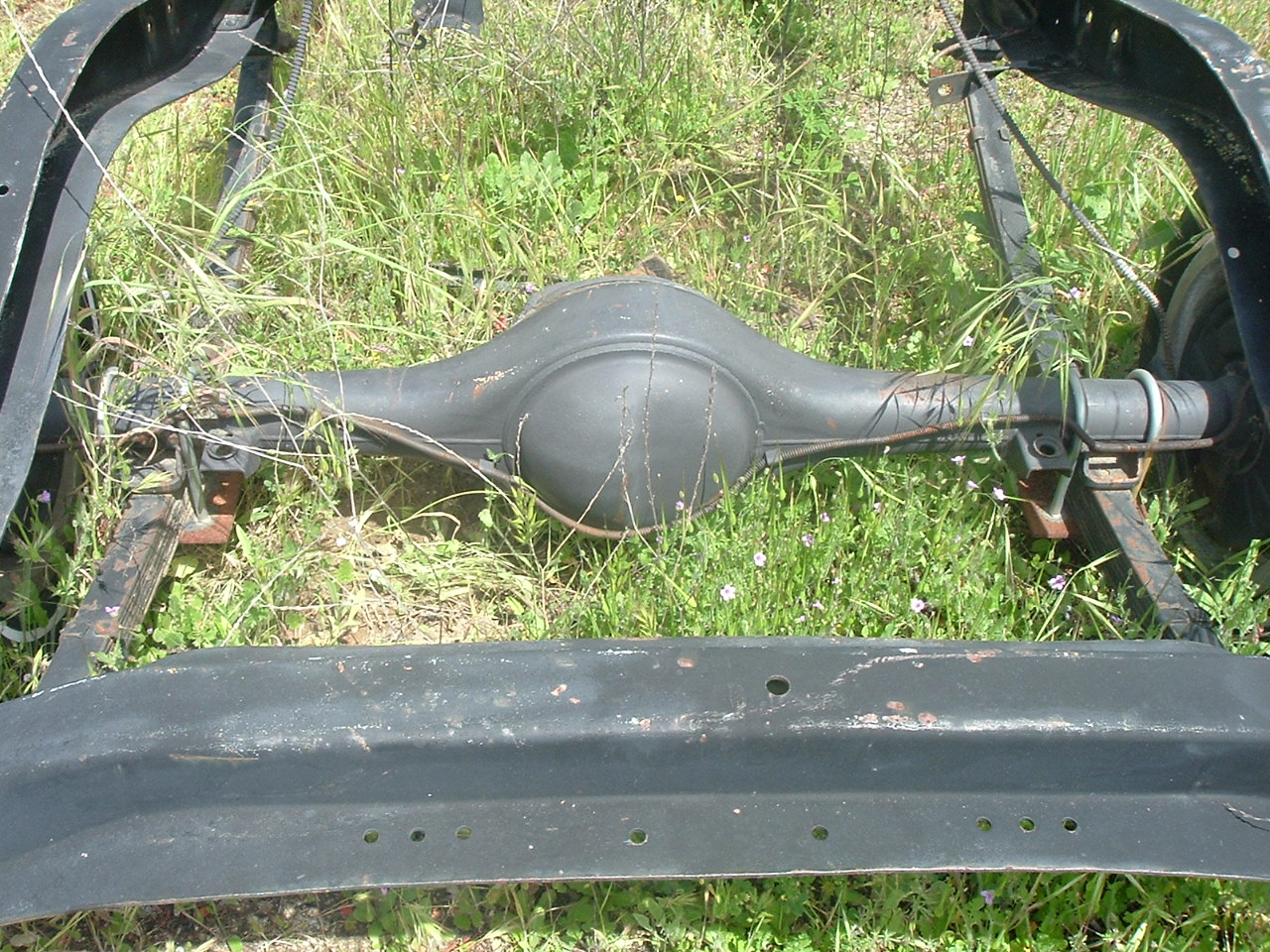

    I am thinking this is a Ford 9 inch but the welded seam all the way to the backing plate is not something I have seen before.
    I am looking at this on Craigslist and I do not have better pictures yet.
    I'm sure it is not the rearend that came in this frame.
    Any ideas?
    Thanks

    It's not an 8 or 9 inch.

  5. If the rear of the housing is completly round and smooth it just may be a 8 3/4 chy. Can't see enought to tell !

    That one looks like a Chrysler to me, from those angles.

    Mid 50's Olds/Pontiac.
    The housing construction and the hint of a rib at the left front . The flat style u-joint flange.

    looks like 50's GM. also looks to be wearing aluminum drums.

    57-64 olds/pontiac.

    Rear of the housing is round, Ford is oval.

    kinda looks Mopar-ish 8.75
    having a better look at the front will help..but as enjenjo says..not a ford 8 or 9

    Im with the guy voting early GM, looks like an Olds pumpkin, Your'e gaming or you would have shown us the diff.

    from Atl Ga
    It's not a Mopar 8.75 either--Mopar housings don't have a welded seam running lengthwise on the tubes.

  22. Olds. The housing ends are a full circle. Mopar ends are flat on top.
    This Olds end from MW website:

  25. my olds housing has the same welded lines as this....
